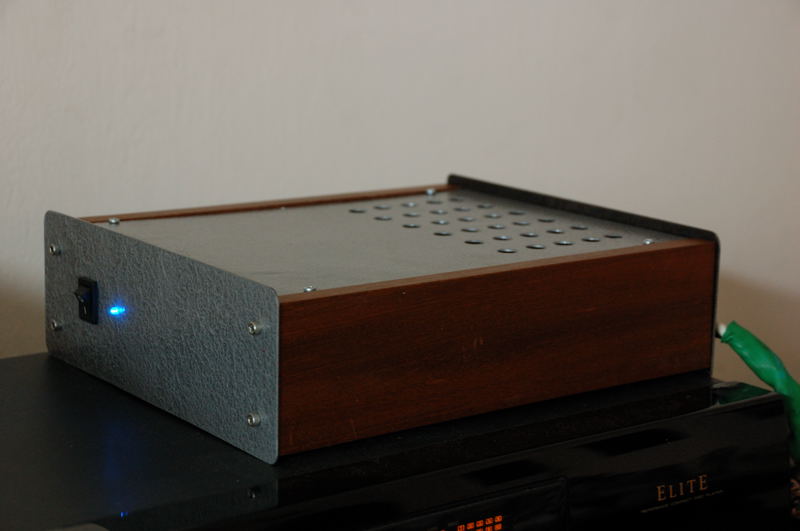

Just finished my first proper integrated chip amp.
Thanks to Peter at AudioSector and Michael at DIY Enclosures LLC..:D :D :D

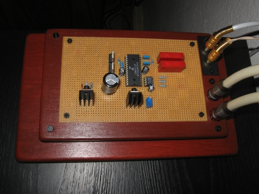

Thanks for all replys.
Montag, it's really not so complicated. All you need is a piece of copper and a milling machine.;)
I must say that particle board is just temporarily replacement for plywood - must find some time to cut and paint.
The truth is that I allways liked open designs (like Byob amp) or my TDA1543 NON OS DAC.
Regards;

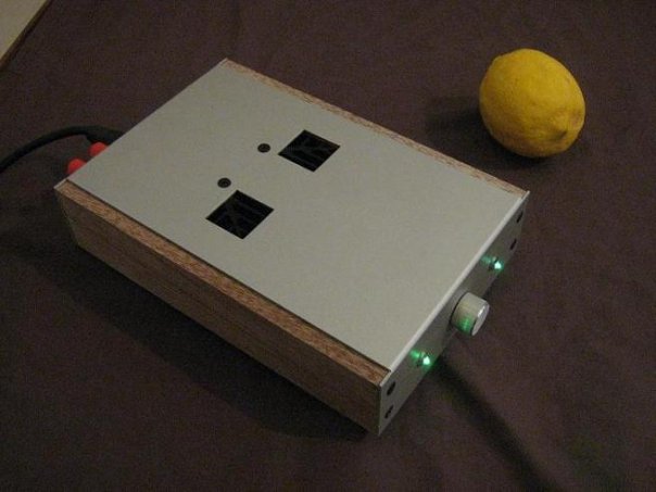

okapi said:
tangmonster -
very very nice. can we see more? maybe a shot of the guts?
i like that single piece chassis.
what chip and power supply are you running?
- Tim

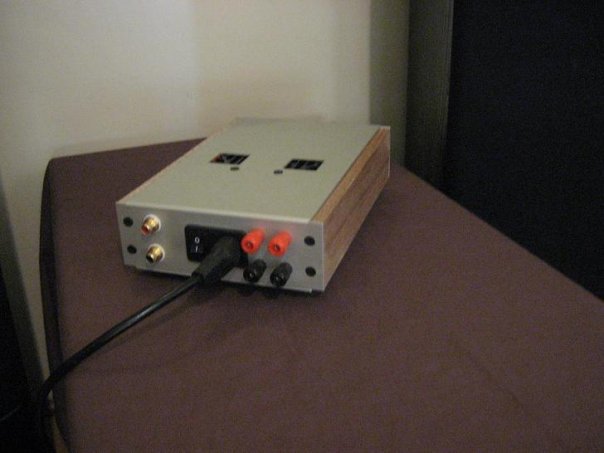

Thanks dude
I tried to design a simple cheap design that looks nice. it would have looked better if i used 4 seperate thicker plates and sunk them into the wood. But this is much simpler.
Bascially it is 250x170x55 mm in size. It has a 2200VA toroidal with two lm3886. I used two bridge rectifiers, with 2 x 4700uF per voltage rail. Voltage tests 30V per channel.
Just one dual 50K log pot in front with the standard national application circuit.
I was worries about hum with everything in such a small space but NO hum. Only a slightly audible hiss with volume control at full with ear agains speaker.
I have one LED connected to each voltage rail.
The meranti wood sides ,with clear stain/sealer.

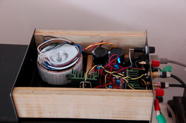

I'll take some photos of the innards and post it.
