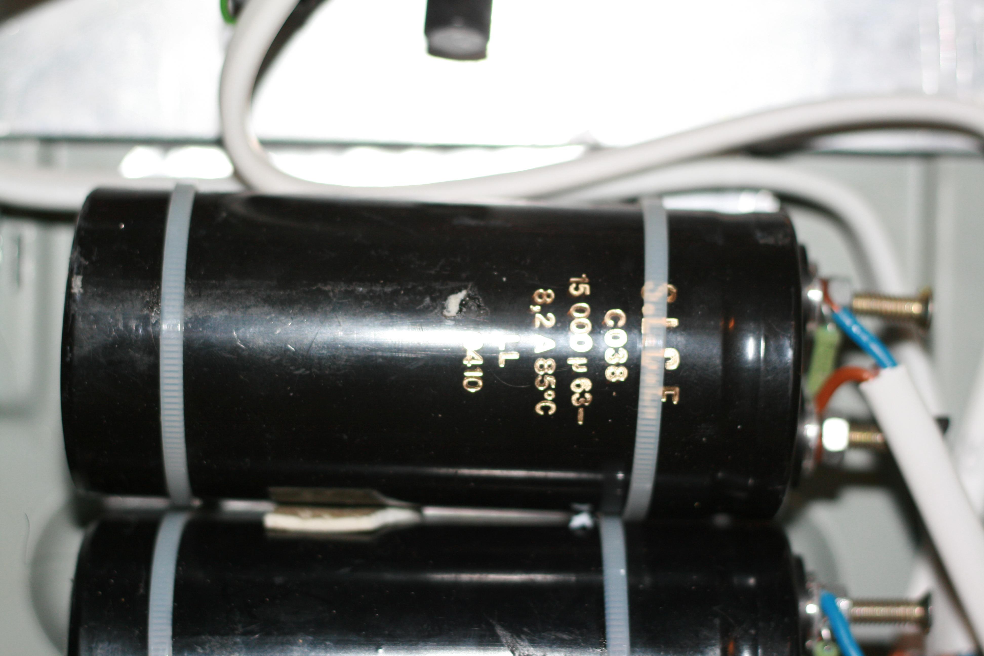

yes its a heat-pipe, it was taking from a old technics amp. the pipe gets warm after several hours use, but nothing to get concerned about.
i forgot to post its lm3886 with 1500uf each rail and a 24v 300va transformer.
oops i was supposed to say 15.000uf not 1500uf.
Joery you can just add them in parallel. Easy with screw top caps. Just a bit of wire and add it to the power input wires going into the amp if you want to test the idea.
That is nice so I don't have to disassemble the whole amp to try it.
Thanks for the info.
with such a small capacity per channel - 1500 uf at high output level music will be modulated by a power supply ripple . Somewhere I read that it makes clipping "softer". But i prefer big capacitors.

If I want to increase the capacitance, can I simply put extra caps parallel or do I have to exchange the existing ones?
Well, my first diy amplifier long time ago was the LM3875 (Audiosector) it comes with a 10uf cap for power supply. I experimented many values and at the end I kept 10000uf per rail. I remember using Black gate caps on the board (1500uf) and 10000uf on the power supply board. if you just want to "experiment" with more capacitance....just add them at the power supply board. Some people say these Chip-amps sound good with small power supply...and they do!, But the bass is "shy" with small power supply, as soon as you put "hefty" power supply (capacitance) you will "literally" feel the bass. and just to test this, you can use alligator jumpers to disconnect quickly and see the difference that way you do not have to solder/unsolder caps.

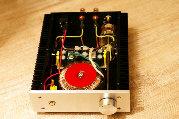

My first step into DIY audio! Finished it a few hours ago and I'm so pleased right now. It sounds great to me (and I have absolutely no good references before). I was worried about cooling not being enough, cooling grease running to the chip-pins, and noise from power supply, but there is pretty much no hum and it seems (so far) to be cool as well. Soo happy!!
