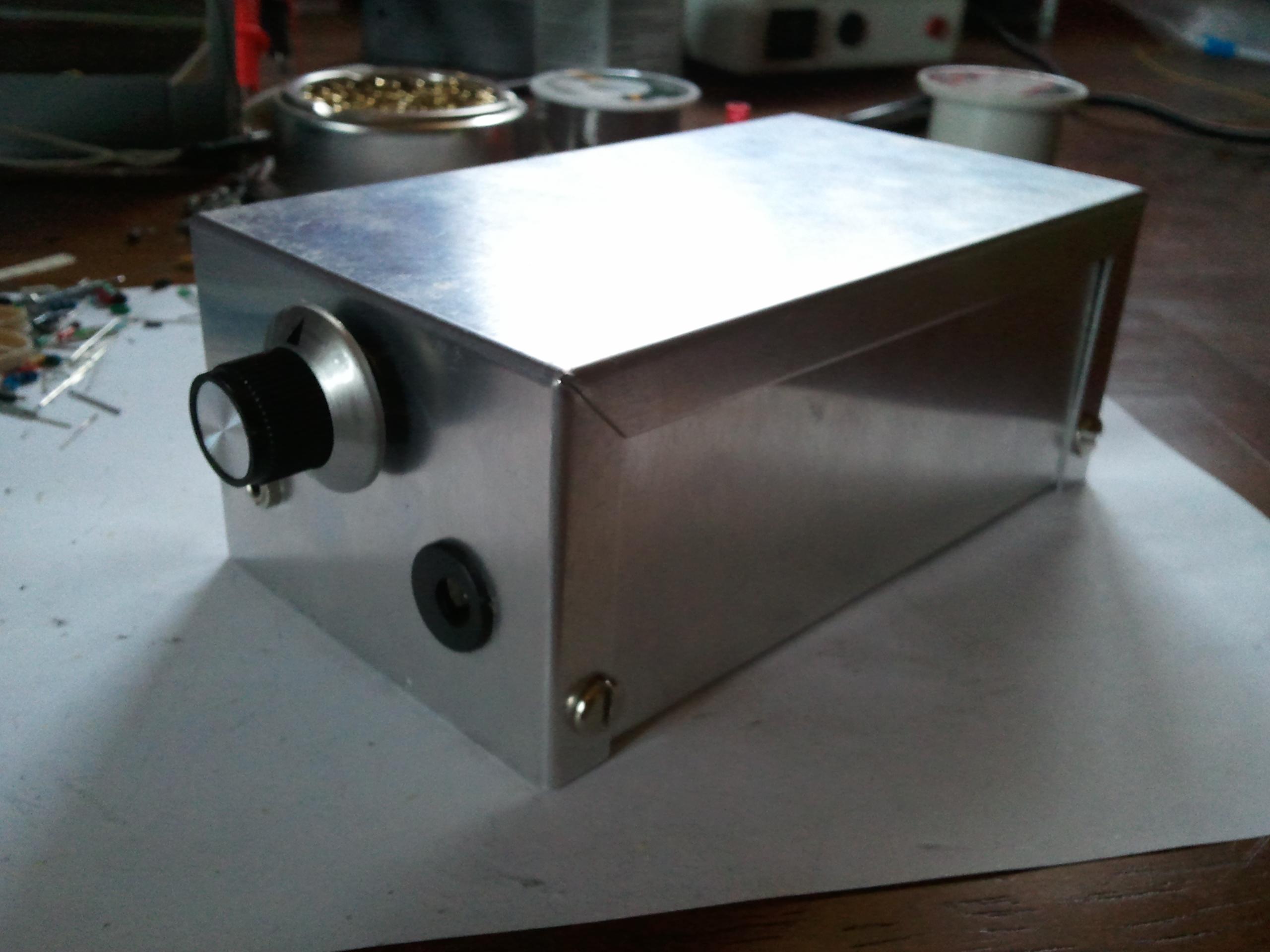

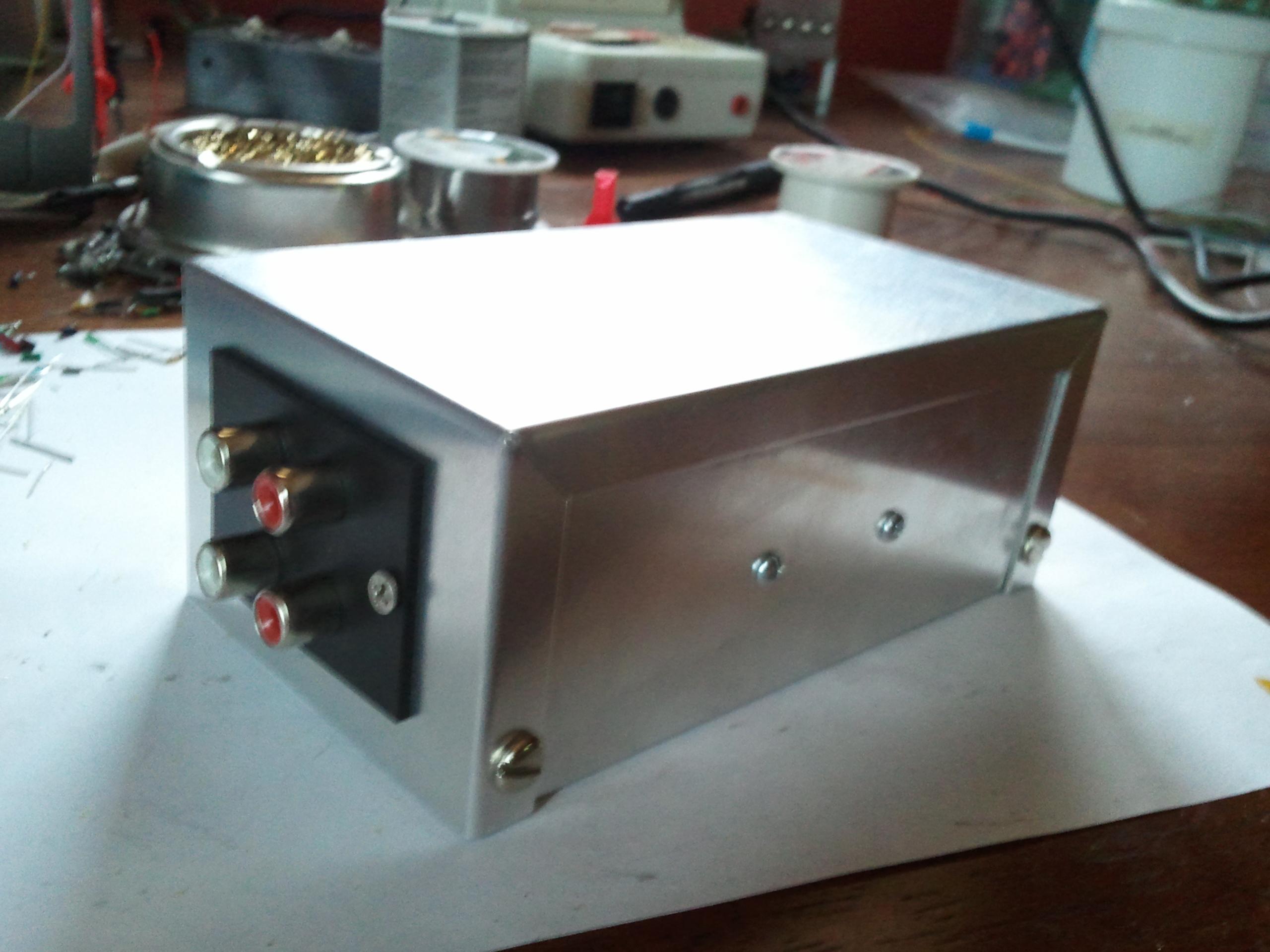

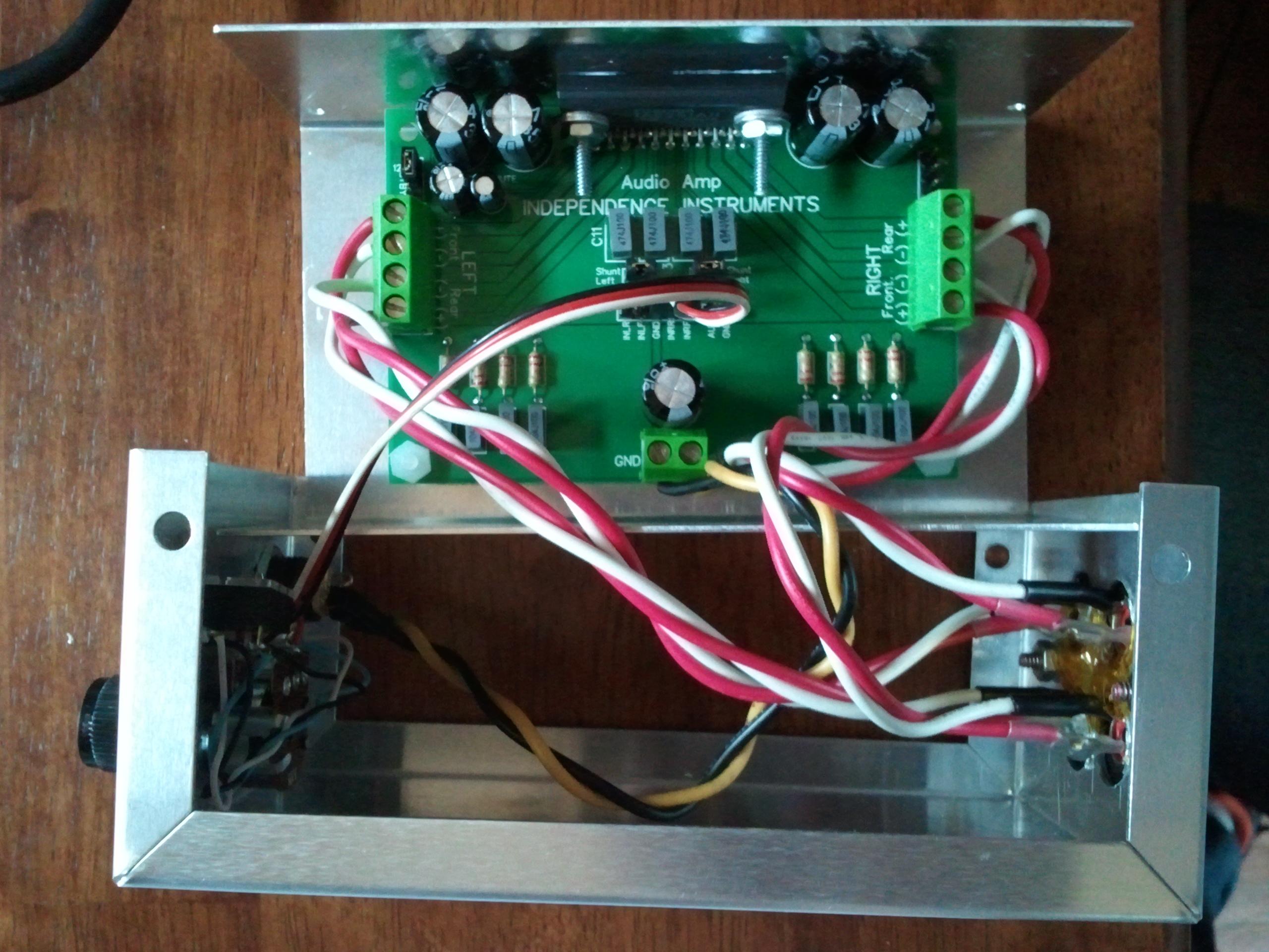

My contribution is cheap and simple, quick & dirty.
TDA8251AH (super-cheap at Goldmine Electronics)
Self-made PCB (described here)
Radio Shack #2160124 enclosure ($3.49 shipped, on ebay)
The connectors and potentiometer were already in my at-home inventory. RCA for speaker output is bad form ... if I do another in this enclosure, then I will put proper connectors on the long end.
