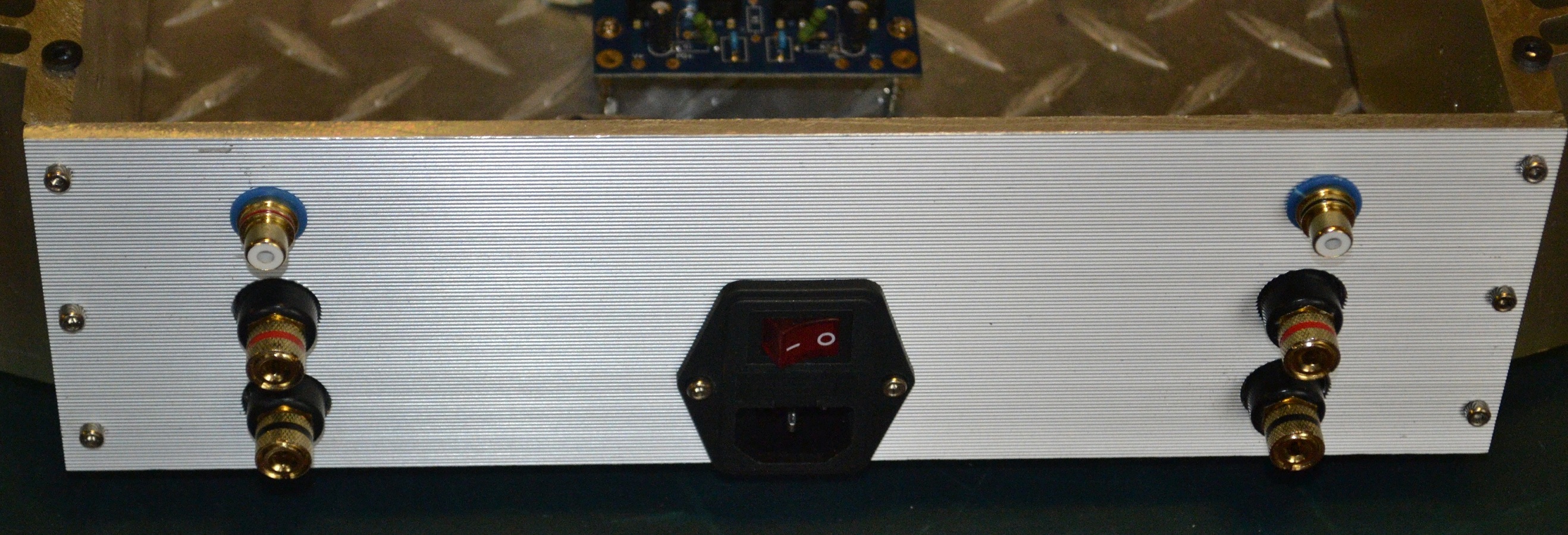

LM4780 Dual Parallel
Here is my newly finished AudioSector LM4780 Dual Parallel kit.
I have used the "Snubberized" power supply with 17.2kµF per rail.
The entire chassis was made from parts in my "scrap" bin.
It sounds very nice, even better than when the left channel was running stereo by itself.

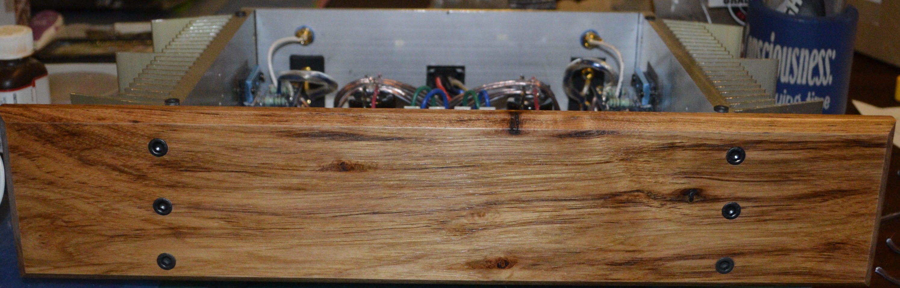

Joined 2011
The wood is Hickory flooring with 2 coats of Birchwood Casey Grain Filler and 2 coats of Birchwood Casey Gunstock Wax.
The top is clear plexi, I installed a 10mcd Red LED on the bottom of the PS with 2kΩ resistor on top, you can see the 4 stack of 8.2kΩ resistors in the middle of the PS.
The LED reflects off of the diamond plate concealed by the Toroid for just enough glow to indicate it's on.

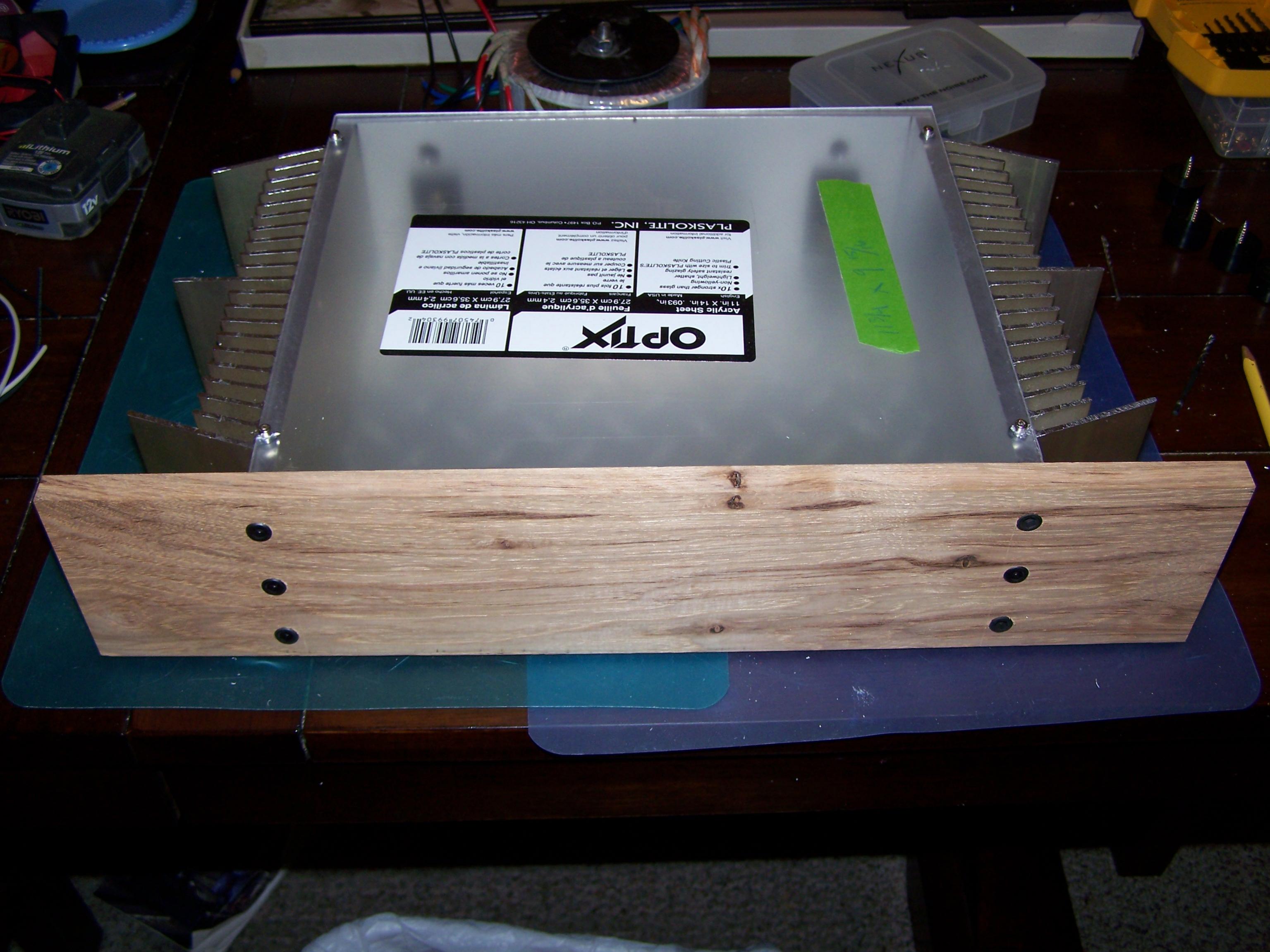

The nice thing about the finish I chose is that I went from plain wood to semi-gloss in 2 hours.
Here is a shot of the wood before the finish.

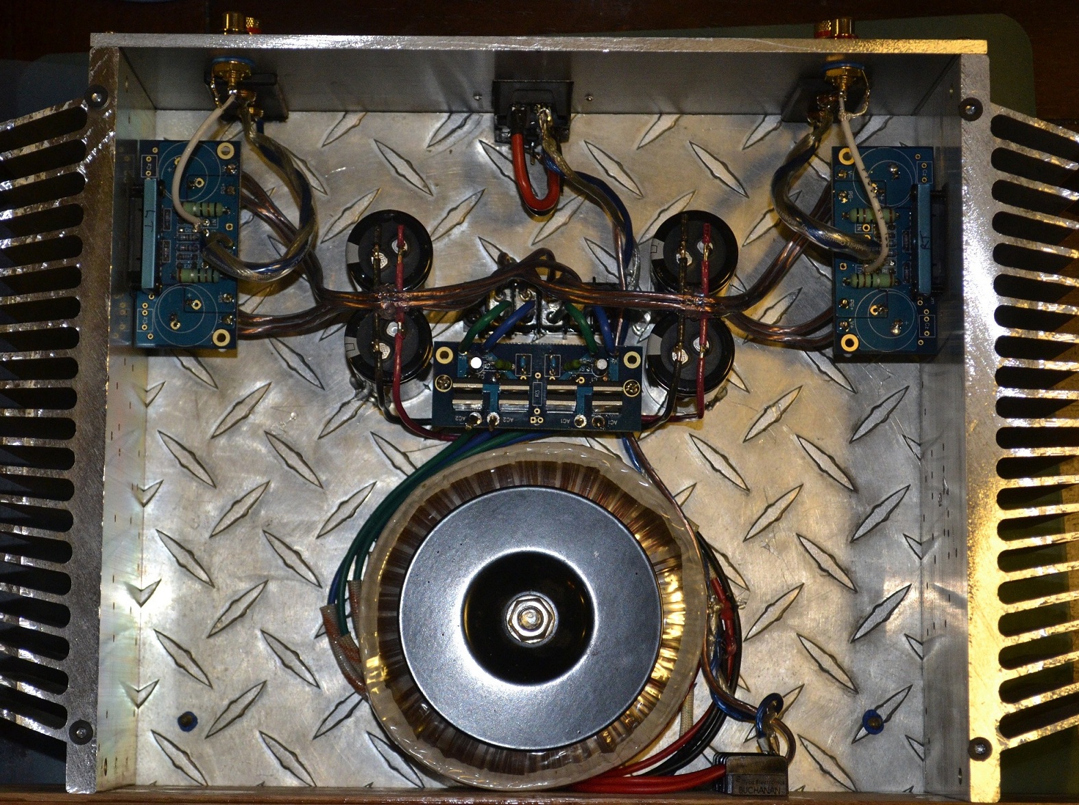

Joined 2011
They are Panasonic TS-HA's there are no "vents".
There is a bit of hot glue placed dead center on the bottom and a bit more than that dead center between them holding the power links going to the amps.
Both are placed on a high spot on the diamond plate tread to give airflow to the underside.
The Panasonic FC's that are on the amp boards are actually floating about .5mm above the bottom with a small dab of hot glue on the outside edge of one of them for stability.
The lead end of them has a rubber vent buffer built in for proper spacing.

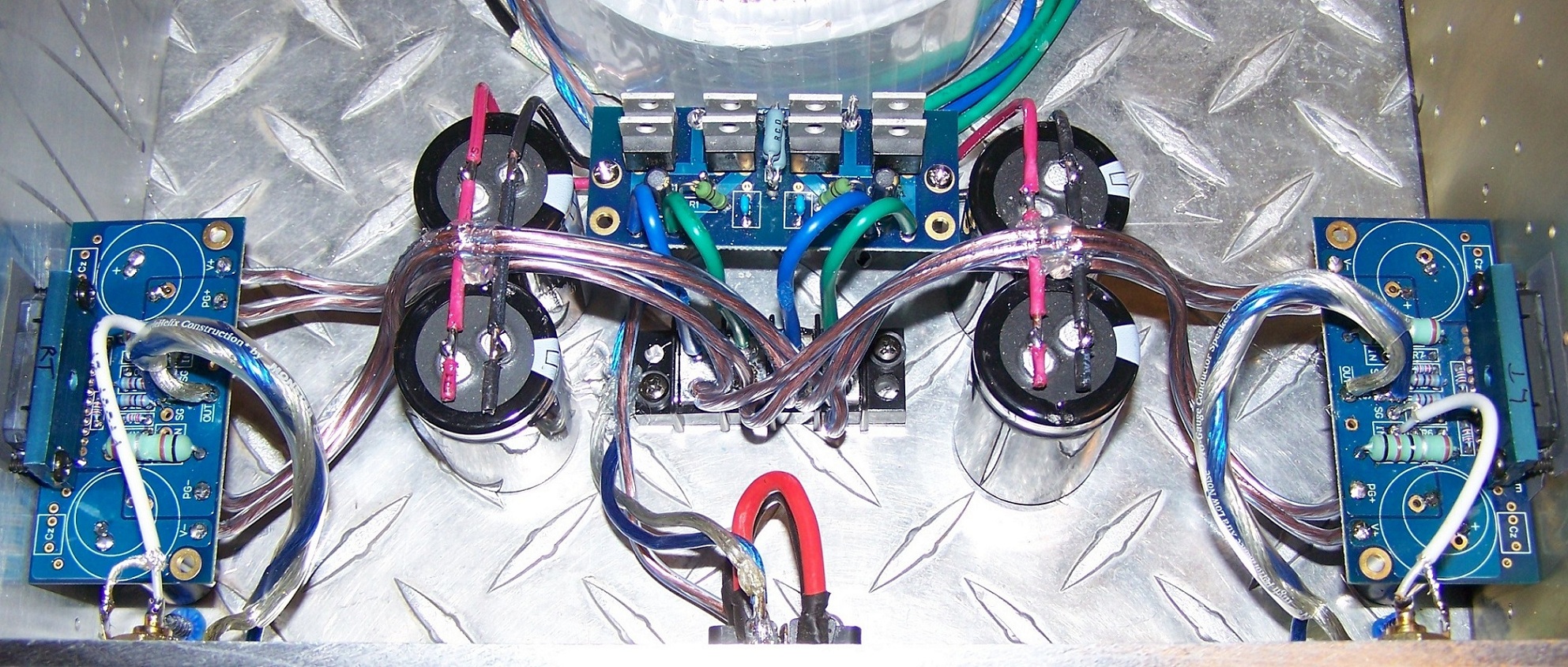

The caps are fine that way, I would just get the voltages from the end of caps not from middle (power supply). also Why do you have so many wires coming out from power supply?
Joined 2011
The 4 large caps use 14awg solid black & red for the inputs on the bottom of the PS board.
The voltage outputs (blue & green) go down to a barrier strip.
The amp power outputs come from the other side of the barrier strip with the "clear" jacket wire.
They merely pass at 90 degrees at the middle of the "bulk" supply capacitors.
ok, check with an ohmmeter in continuity mode, check PG- PG+ CHG, you will see that all of them are one connection.

Joined 2011
There should not be continuity from PG+ to PG-.
There are two separate diode bridges and two separate secondaries on the transformer.
:Edit: I see what you are saying the PG+ & PG- share a plane on the amp board.
