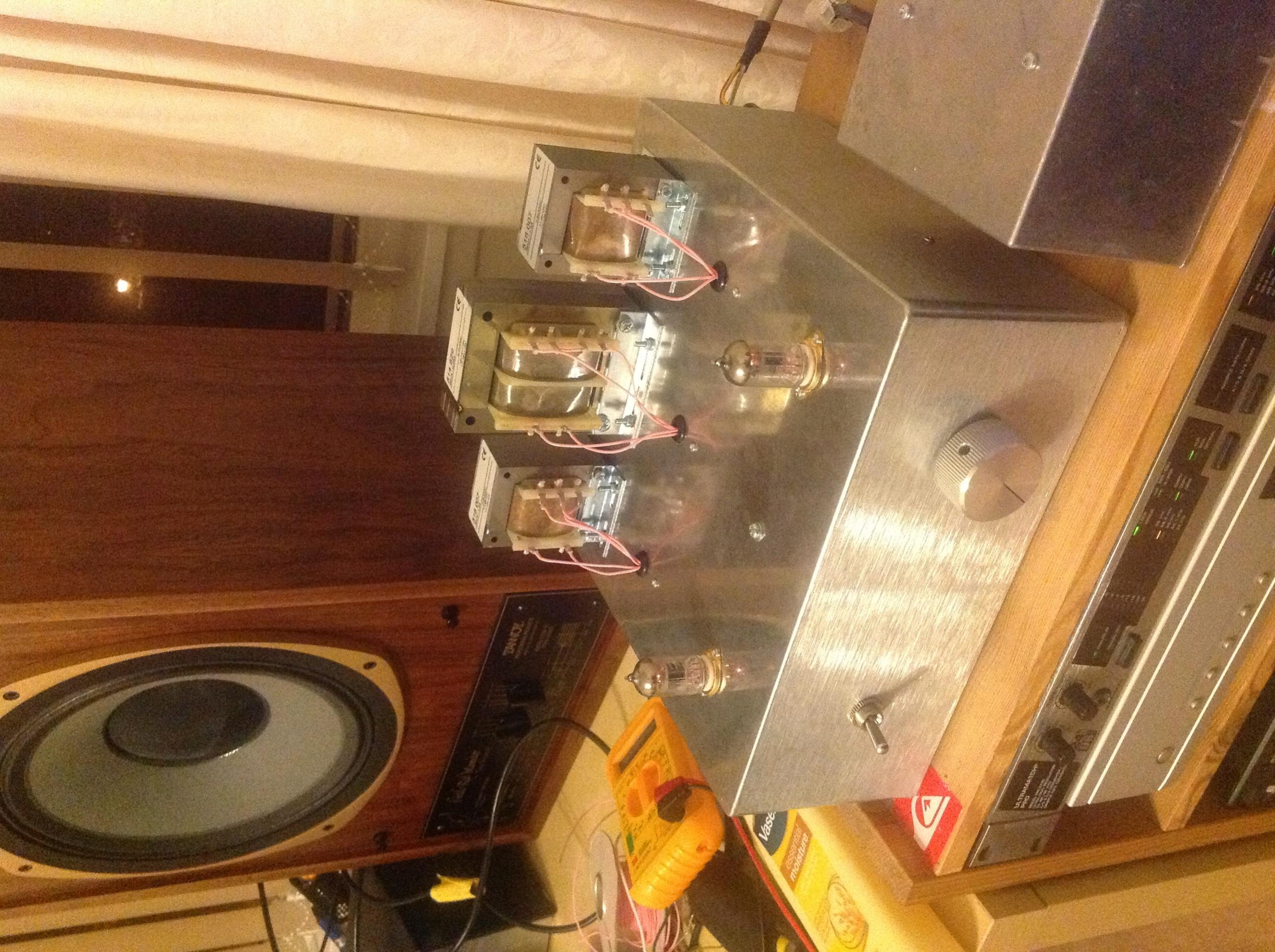

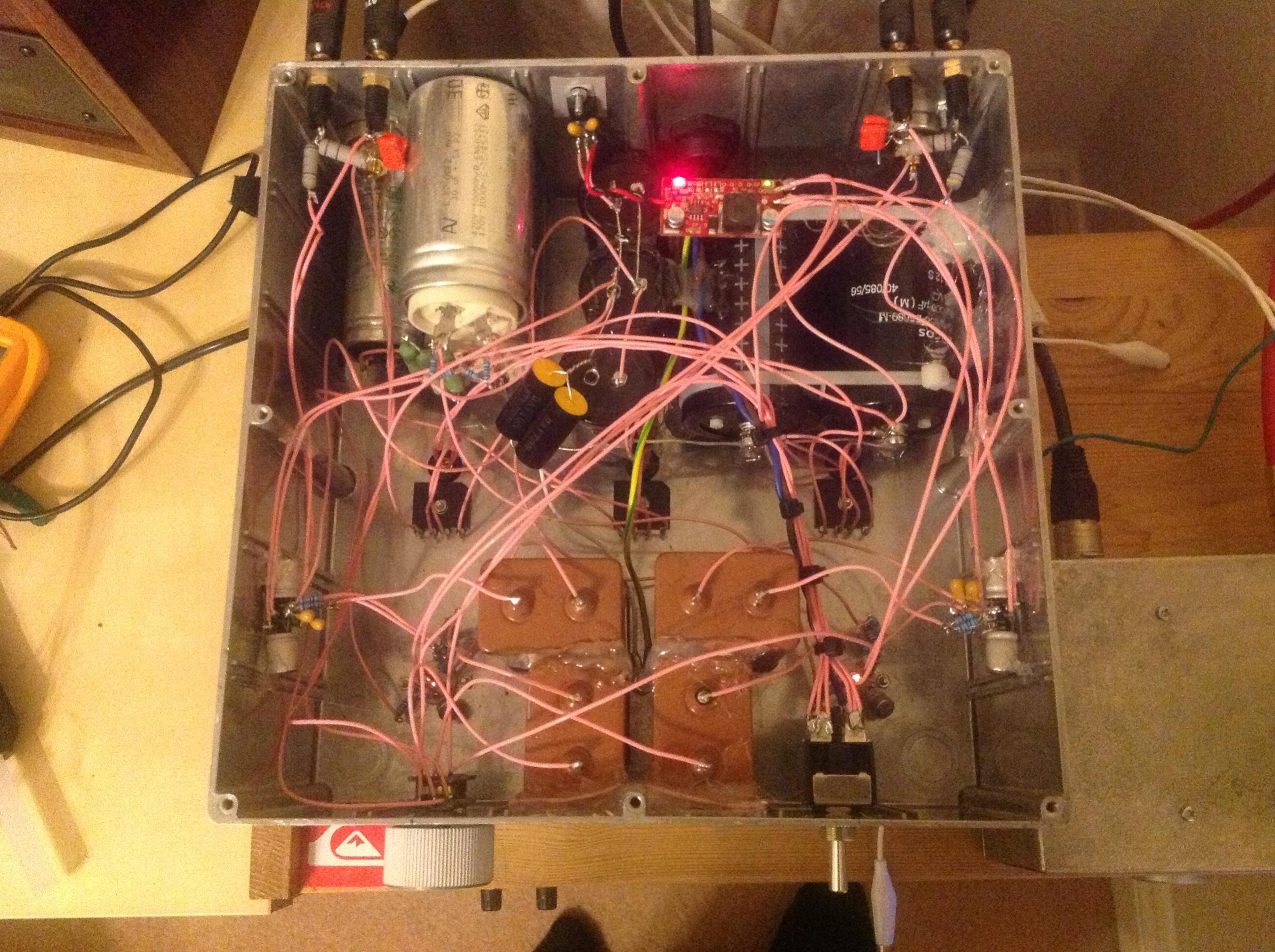

Lm1875 amp with 6ak5 buffer. Horrible wiring etc. but no issues with hum or noise. Sounds much more alive than non-buffered amp. Tempted to build another valve buffered chip amp with neater wiring. Transformer cover to be added for safety :)

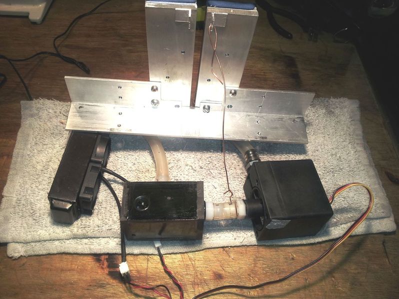

No - Not actually, the idea crossed my mind several months ago when I was testing several standard convection heat sinks. Thought it would be good to introduce a control element. When the LM3886 gets close to the temperature protection trigger point the sound can deteriorate and intermittent drop outs occur.
In general the available SPL from the MyRef family is in the usable range with only an attenuation pot. As a big band fan/player, I push the amps (using 200 & 300 VA toriods in some builds) with a JC-2 pre and they stay in the upper range of the power scale when driving my fairly inefficient speakers. No doubt a larger heat sink could be sufficient, but that wouldn't be any fun.:)
I have said in several posts that this may well be overkill for a chipamp, but there is a possibility it might be a prety good fit for something like hotter transistor builds. I've seen some F5s and such the size of a small freezer ;) There is also the possibility of hearing/measuring the performance of the LM3886 across it's working temp range. Not a super high priority but potentially interesting. I'll post anything of significance if I stumble across it.:D
Don't know if you have any experience with the liquid cooling for PC world, but they have developed some fantastically quiet pumps and fans. Once all the air has worked completely out of the system the pumps are dead silent. You have to touch them to make sure they are working. Fans are almost as good and any trace of noise beyond ~ 12" can be eliminated by slowing them down a bit.
The major cooling is not from fan air flow. All that is needed is a steady light breeze across the fins of the radiator. A little adjustment for efficient air and liquid flow rate (less is better) does the trick. There are also some good additives that both protect any metal components and increase heat transfer.
I guarantee you can build a liquid system all the way up to the 120mm format that you can't hear past 1 foot.

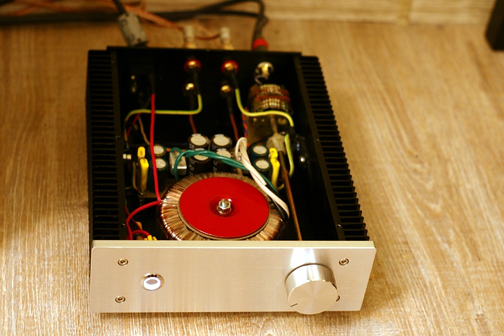

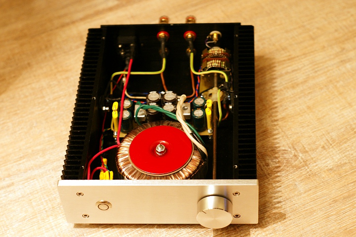

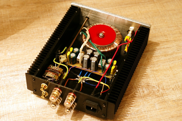

My second LM3857 Non inverting amplifier ( 200VA 2x24V transformer; standard small bridge rectifiers with small heat-sinks ;4x4700uf filter capacitors + 4x2200uf bypass caps + 4x 1uf, snubbers caps under PSU board ; p2p installation; compact enclosure from e-bay; salvaged stepped attenuator;)
No hum no noise , small DC offset. I will try to measure amp later :

Nice looking amp and construction. Do you have a link for the enclosure. It looks familiar, but I haven't seen that switch assembly before, and was wondering if it came with the case?
they are buyable on ebay from china.
just search ebay. sometimes they come up when you search for 'pga2311' since many are sold as boxes for preamps.
I've used several of those style enclosures from China and very happy with them. The one in question just looked a little 'dresser' hence the question. I was particularly intrigued by the push-button switch with the flange ring on the front. Looks fancier than what I use.

Congratulations osscar! That is a very nice integrated amplifier! Very neat and compact ;)
