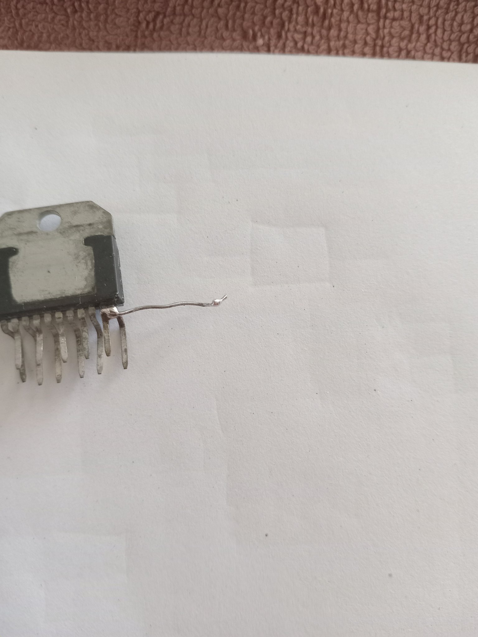

To get best bass from LM3886 the magnetic field of the output, Vcc, Vss should cancel. For that the Vcc should be adjacent to output that is pin2 which in not connected. The +V must be supplied by pin2 and at the root of the chip is linked to pin1.
This why the lm3886 must be customized. At the root of pin1 and 2 a magnetic lead from electrolytic capacitor links them as shown in the picture bellow. The Vcc, Vss tracks come in parallel from the bottom side to pin2 , 4 and the ground from the upper side to join the output and bifurcate sideways in parallel. An ceramic 100nF 100v smd can be installed between the Vcc and Vss at the pins.
