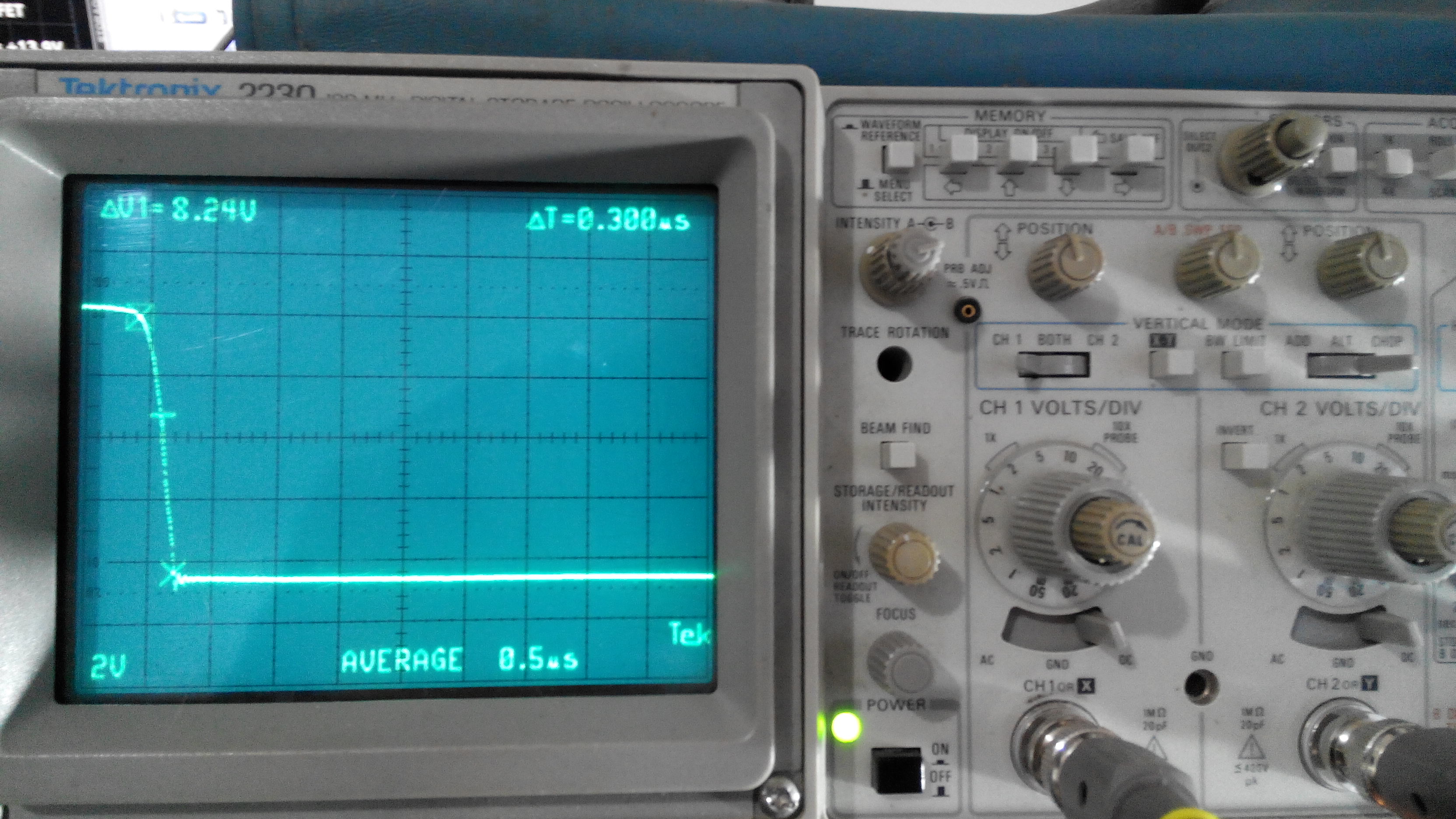

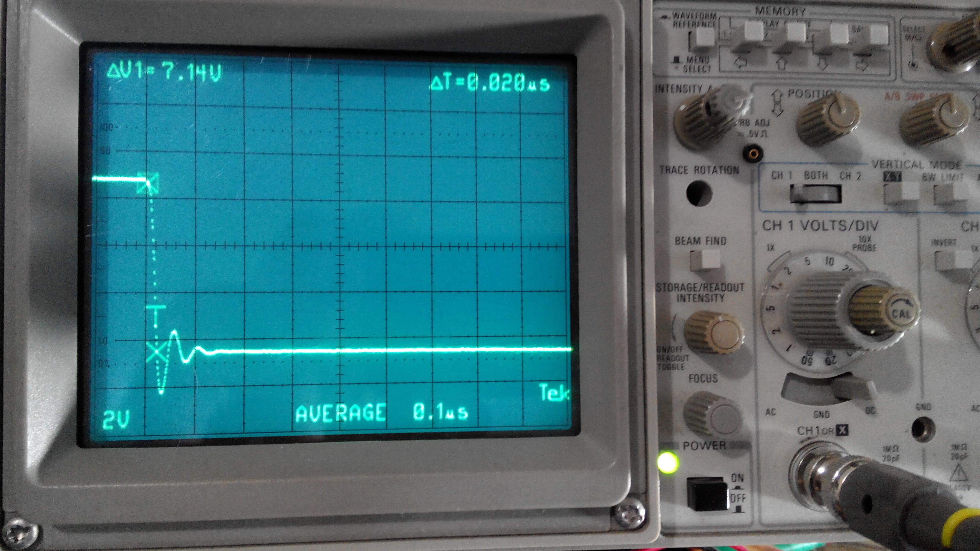

I've swapped the 5V supply for a 9V battery and probed about my circuit a bit and I think I've found that the cause of the sluggish behaviour is the output buffer.
The signal coming from the ne555 has a fall time of about 20ns but the signal measured at the output buffer has a fall time closer to 300ns.
The BS170 mosfets that I've used should have a turn-off time of 10ns, so I'm slightly puzzled as to what is causing the slow performance

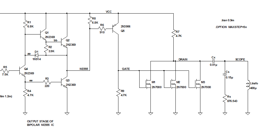

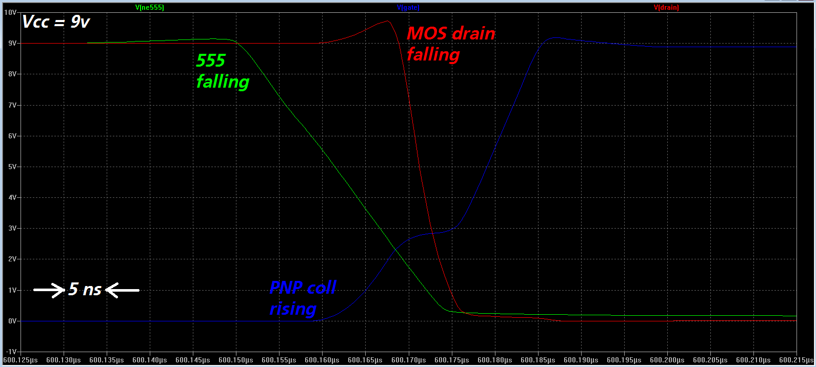

Don't forget that only one edge matters, the one where CheapoModo strikes the bell and makes it ring. That edge is:
NE555 falling edge -> causes -> PNP BJT collector rising edge -> causes -> MOSFET drain falling edge.​
The other edge is unimportant and can be made very leisurely. In fact it IS made very leisurely, to save DC power.
In the quote above, you give a measured fall time at the PNP collector ("output buffer"). But what matters at the PNP collector is the rise time, not the fall time. Here it is, in simulation (below). You can really see the Miller effect, caused by the MOSFET's ((1+Av)*Cgd). They weren't lying to you in school; the Miller effect is not negligible.
And you do need to find a way to calibrate your probes & adjust their risetime-vs-overshoot trimmers for optimum performance. Otherwise your test instruments are lying to you. Nobody wants that!

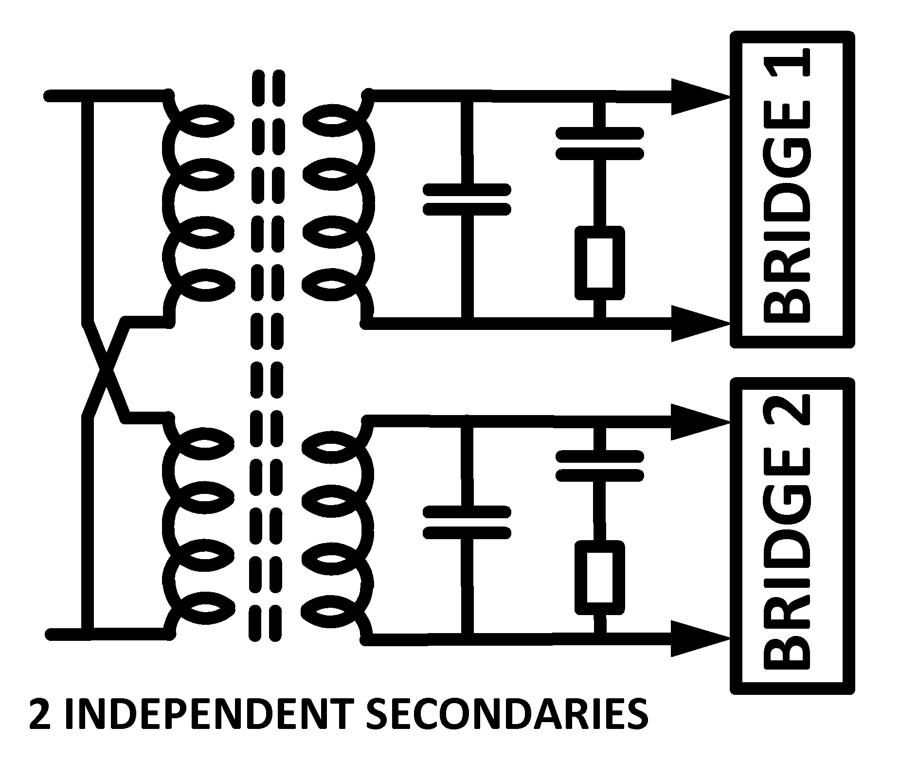

Make sure your configuration is NOT the independent dual secondary arrangement shown below. A quick way to check this is: if you've got less than two full bridges (fewer than 8 diodes total).
Independent dual secondaries, shown below, conduct at the same time and cease conducting at the same time. The diodes in the two bridges "ring the bell" of the secondaries' resonant circuits at the same time, and the snubbers damp the resonances at the same time. That's not the kind of behavior you and trobbins are interested in.
Mark, it seems likely that with the two independent secondaries configuration, each with a bridge, the relevant diodes would only cease conducting at the same time if the secondary voltages, filter caps and loads on those two independent supplies were similar, given the subtle differences in diode conduction duration that may occur and the relatively short duration of diode turn-off.

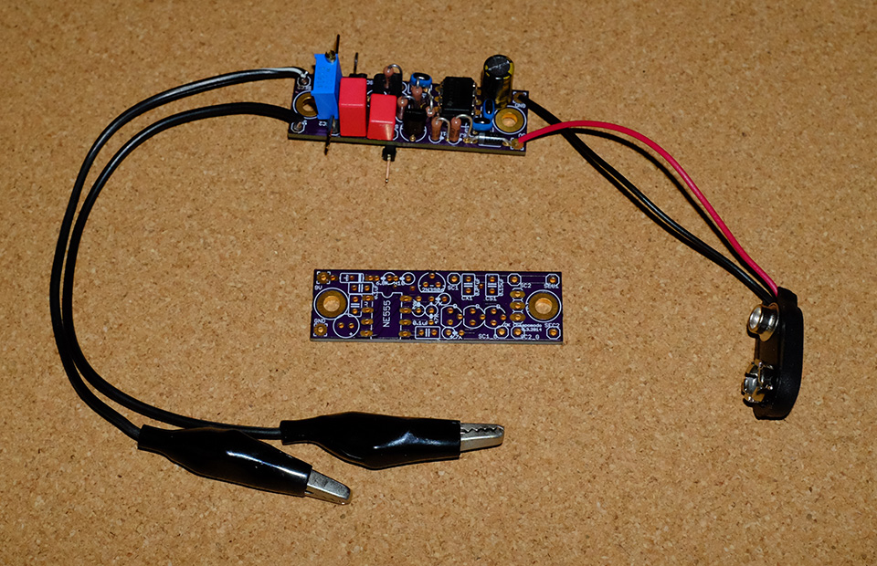

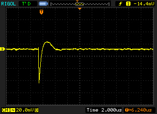

I finally received my sample pcbs. They have some practical issues because I used the default eagle libraries (thin pads etc) but it is functional.
attachment.php

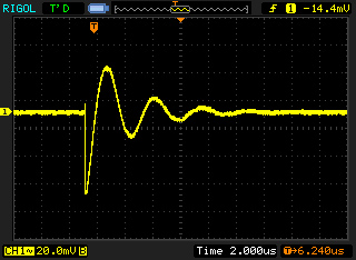

Here is a Triad 2x12VAC toroid ringing :)
attachment.php
And here it is with the trimmer set at 47R7
attachment.php

Congratulations on your working Cheapomodo! It looks like you've dialed in a resistor value that gives pretty good (zeta around 1.0) damping for that combination of transformer, Cx, and Cs. Nice job, well done.
I strongly recommend you try it again using two scope channels, one triggering on the near side of Cx (MOSFET drain) and the other displaying the far side of Cx (TRAFO secondary). The optimum snubbing resistor value won't change, but the scope's triggering and the display will be more solid.
By the way it appears you've got the 10X probe setting wrong somehow; the scope says your waveforms are millivolts tall, but a 9V battery + Cheapomodo produces waveforms that are several volts (several thousand millivolts) tall. And I think the "B" on your display might mean you ran the scope with Bandwidth Limit enabled; try not to do that, it distorts the sharp transients.
Thanks Mark
And again, thanks a lot for a very nice idea and circuit.
About the two channel triggering, if you check my layout, I have two sets of test points for two channels, as per your initial instructions. I just could not find a hook tip for the second probe. I've been using it mostly with the small spring.
The small peak to peak voltage, could it be because I used AC coupling? So what we see here is just the ringing with no DC component? I run the probes at x1
About the bandwidth limit, I am usually too lazy to get my area clean enough from interference, so removing it results in a nasty thick spiky trace. Especially with the low resolution of the Rigol screen.
Anyway, the circuit idea is so nice that accurate measurements are not really required. All you have to do is hit auto and zoom until you see the ringing big enough to be easy and clear taming it.

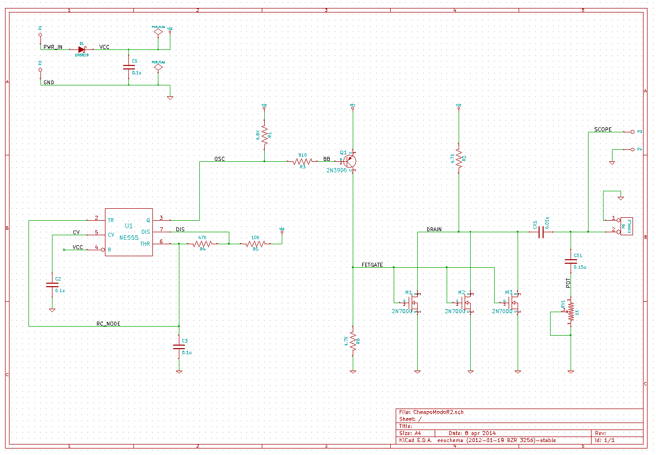

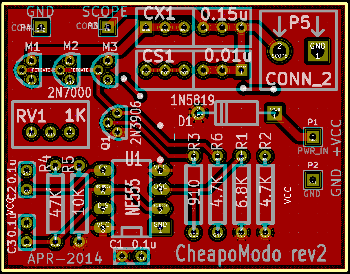

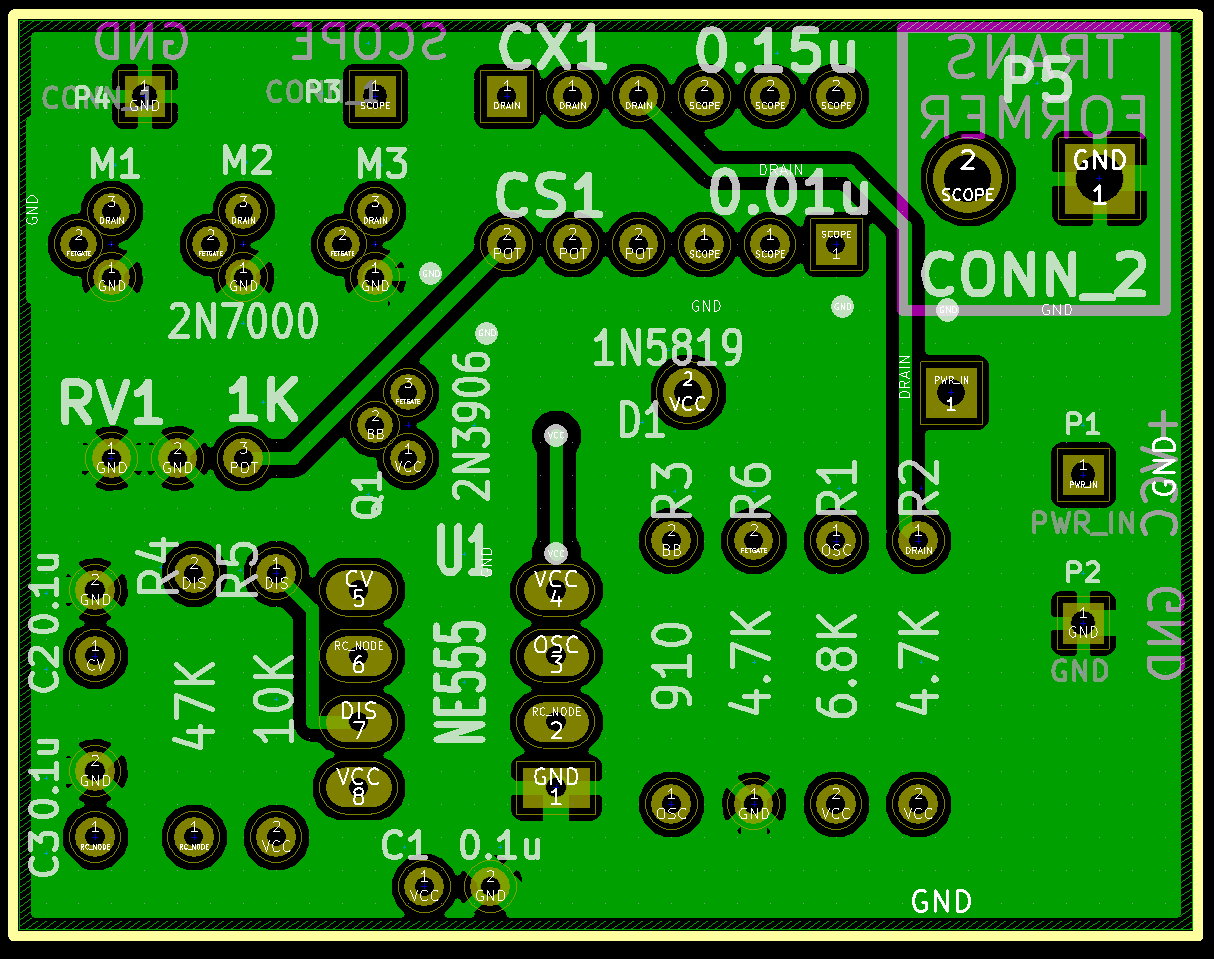

I built two revs of PCB for CheapoModo at seeed, using their cheapest-of-all footprint, 5cm x 5cm.
The second rev is shown below; its MOSFET gate driver is a wildly asymmetric PNP-resistor stage, giving one sharp edge (the falling edge), and one very sloppy and leisurely edge (the other one). Fortunately this does not matter since we set the scope to trigger on the falling edge.
Bypass capacitance was severely compromised; there's only a single capacitor for the whole board, compared to Quasimodo with a big electrolytic bulk capacitor plus many ceramic HF decouplers. Nevertheless it seems to work moderately well.
I have a supply of ~5 blank boards somewhere, stored in one of ~300 cardboard moving boxes in my garage. I will give one board to you free, IF you'll pay me $5000 to unpack those boxes and locate the boards :)
Otherwise here is a zip archive of the PCB Gerber files, which you can send to a board house yourself. Or design your own, as intrepid diyAudio member dimkasta did in (post #68 of this thread). You'll have more fun and learn more, too!
