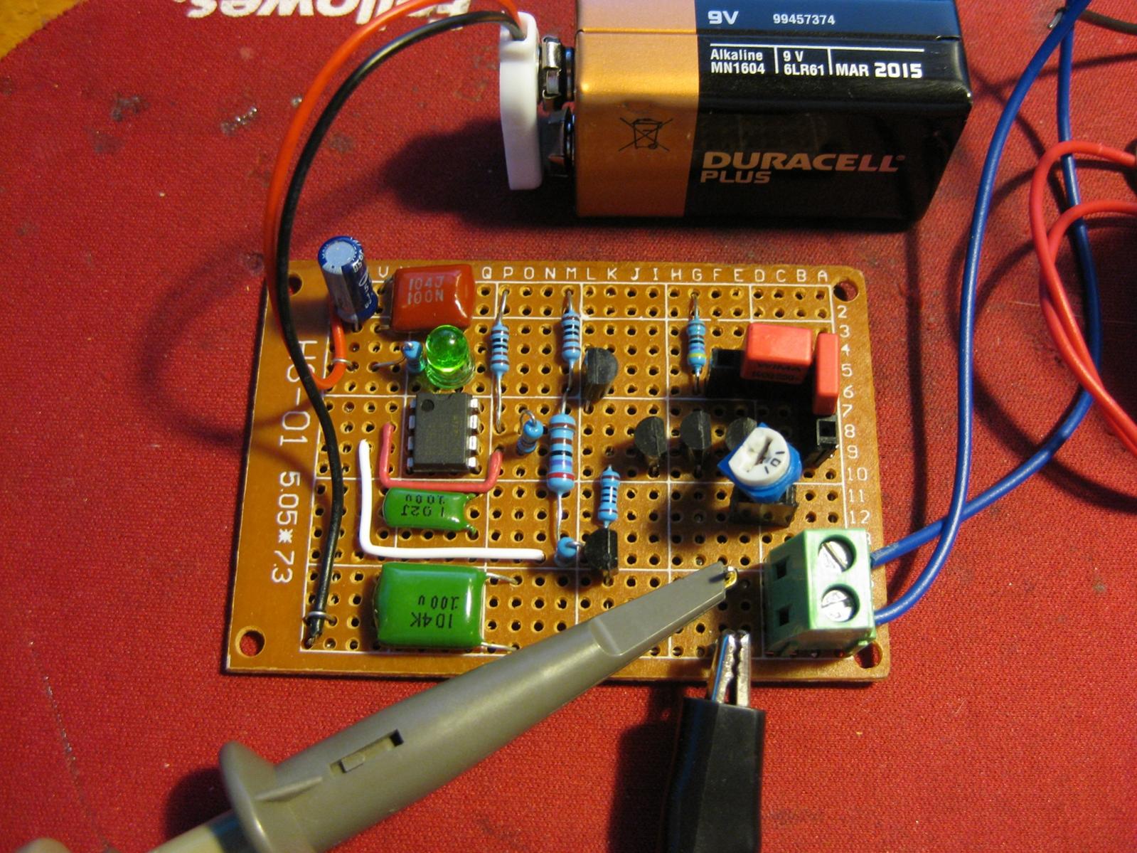

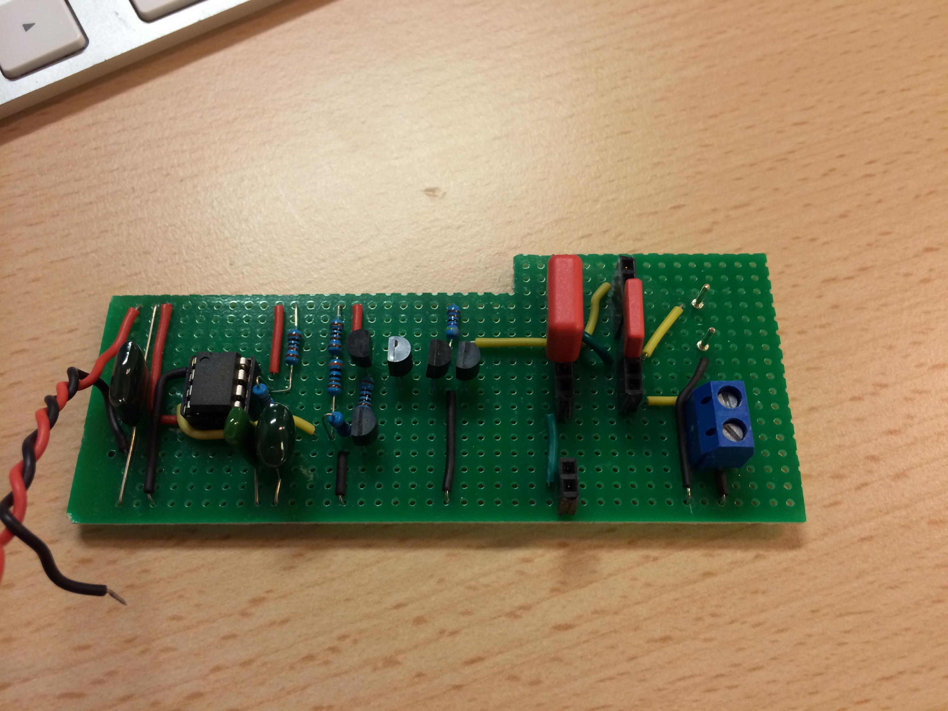

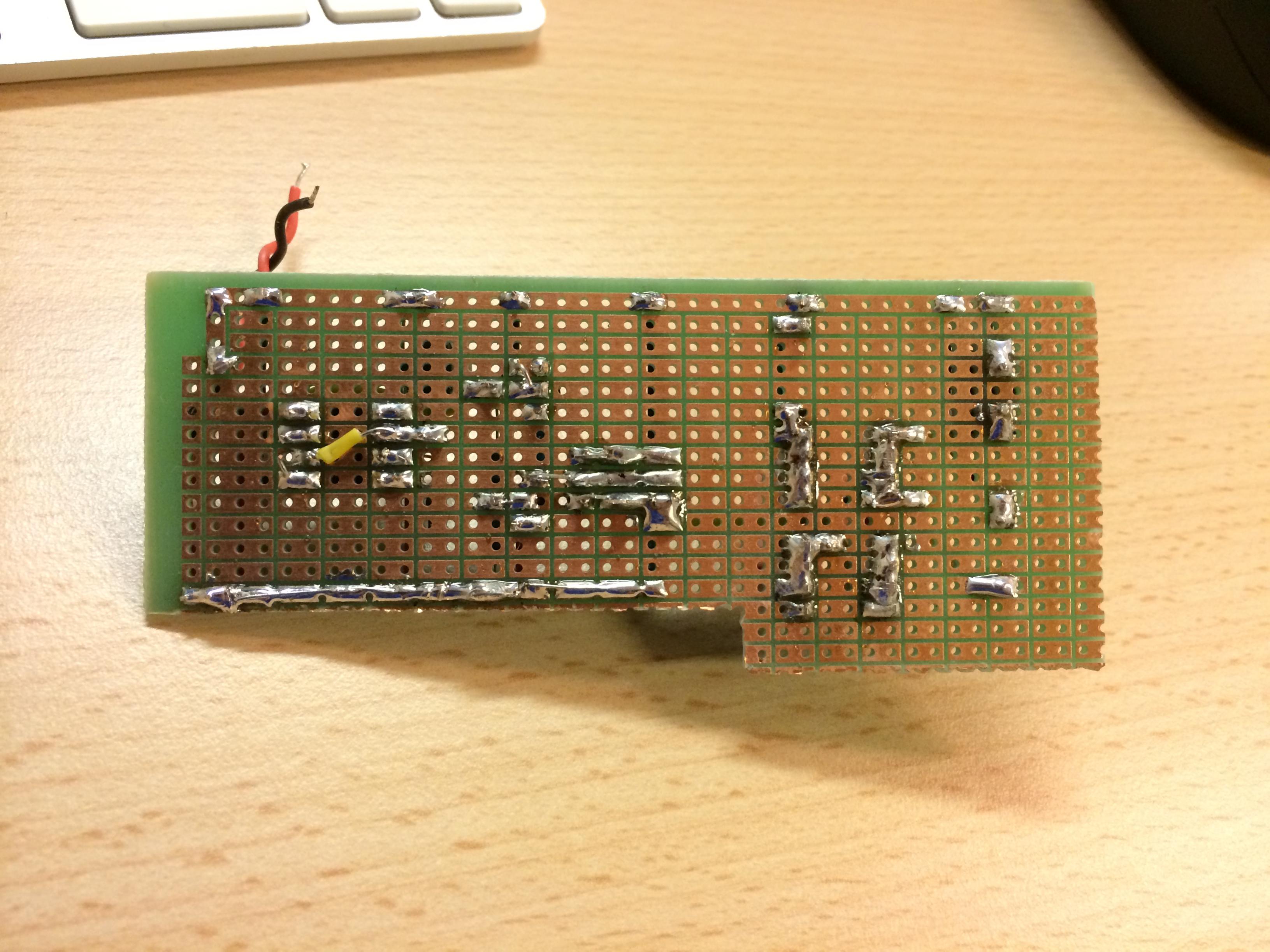

Well, to be honest, I've quite literally followed the LTSpice schematic for layout of the components, including the Vcc and GND rail. I'm more than willing to make a picture of the solder-side, but I doubt it'll help much, since it's a veroboard. Let me know.
Well I think it can't harm, it just depends on your eagerness! I think that since it works, it is a follow-me example after all. :)
Ok, but don't bash my vero-board skills :D

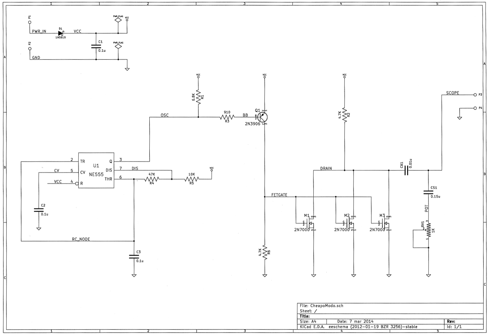

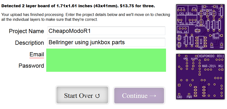

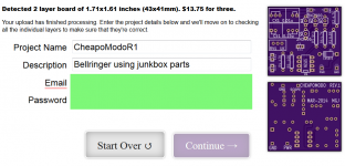

Today I made a quick PCB layout of a CheapoModo using the single-PNP gate driver circuit. I sent the attached .zip file of Gerber data & got the attached price quote back from OSH Park: $13.75 for 3 boards, and shipping is free (inside the USA anyway). Schematic is attached.
I'll receive the boards back from OSH Park in 2-3 weeks, and stuff+solder them to see whether they work. It's not a complicated design so I think the prognosis is excellent.
If anyone here would like to download the PCB data and order their own boards, here are the files. I suspect you'll have an easy time finding people who'd like to have any & all extra blank boards you're willing to sell or to give away.

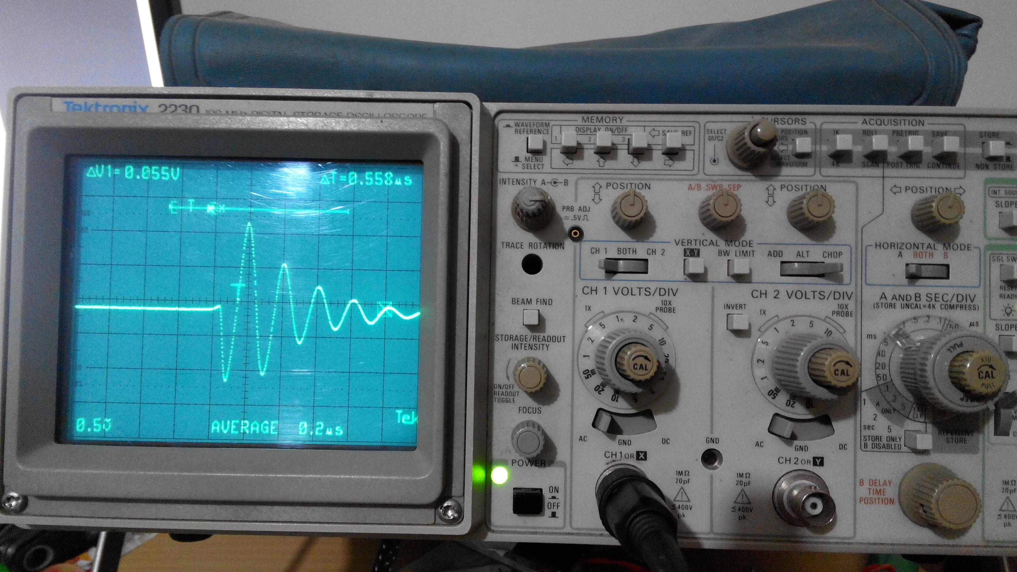

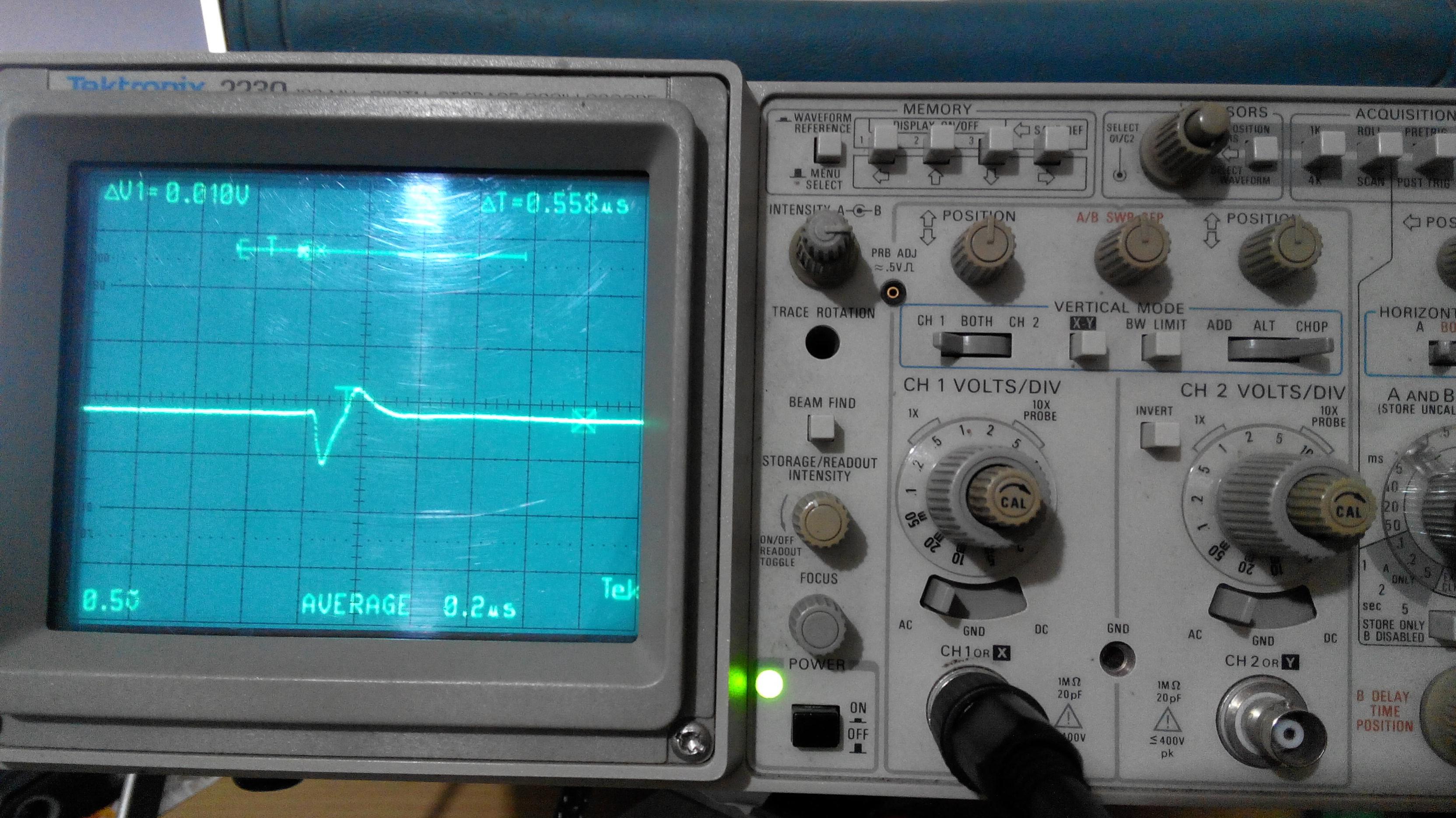

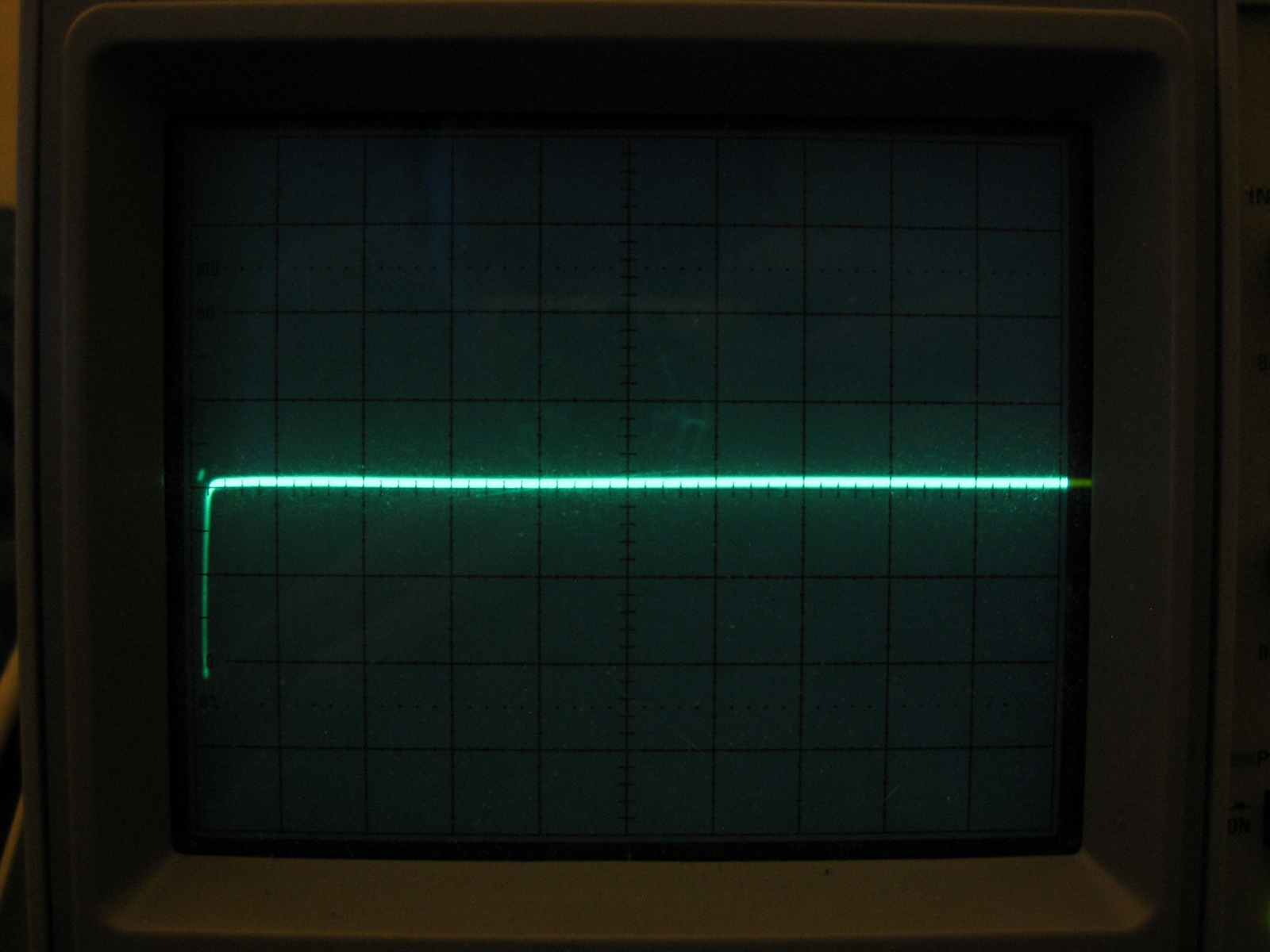

Well it seems my analog scope has no issues picking up this trace, though i can only just get it to display the initial ring. I didn't even have to use the x10 magnification mode.
In the test images i was using a cheap 5va 6v transformer that came from eBay china. With no Cs capacitor i quickly got the scope dialed in on the ringing, and with a little experimentation i ended up with a 100nf in the Cs position, and the pot set to ~ 55ohms to produce a flat line. It certainly seems to work, now i just need to learn how to use it properly :)

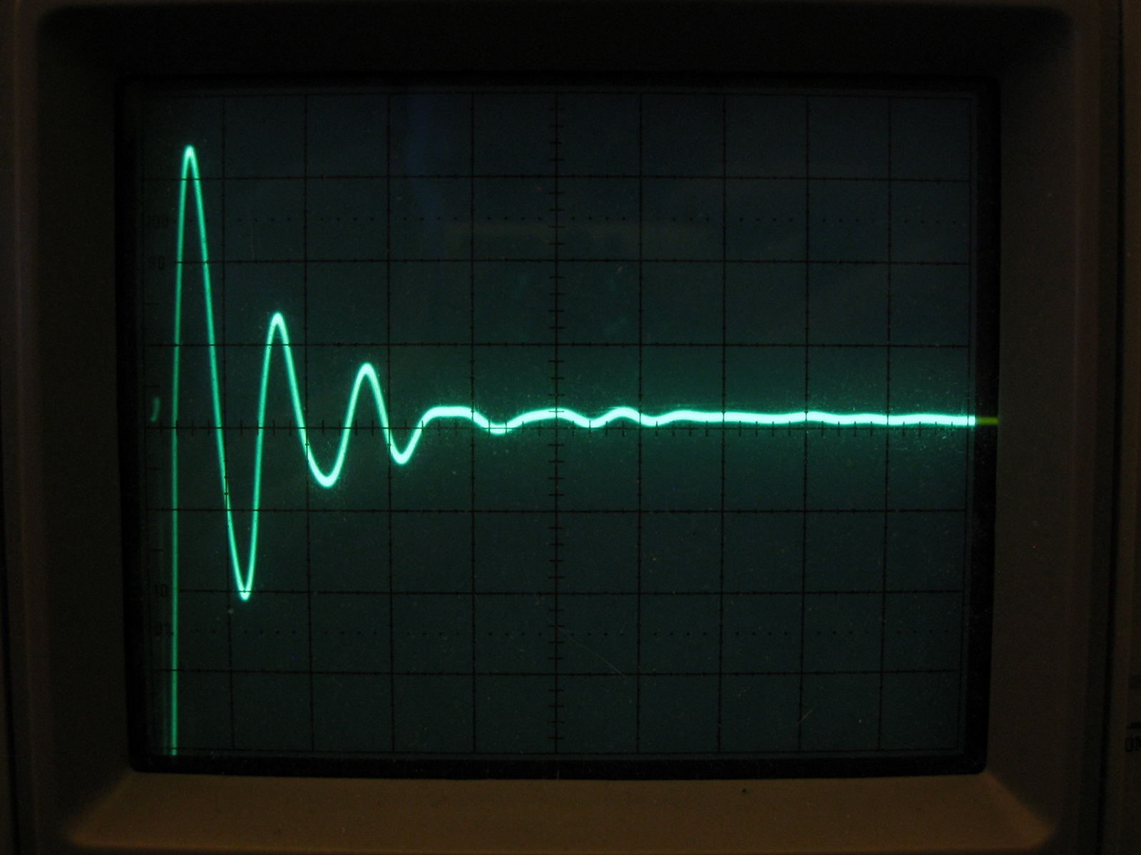

mcandmar, I recommend you connect a fixed inductor whose inductance is known within 10%, to Cheapomodo. Then calculate the ideally perfect Rs value which gives zeta=1.000 (at this L and this Cx) using the equation in Appendix A. Set your potentiometer to this Rs value. Look at the CheapoModo waveform on your scope; at the ideal perfect zeta=1.000, your scope trace is not a flat line. The goal is not to achieve a flat line, the goal is to achieve zeta=1.000. The ideal perfect scope waveform for zeta=1.000 is shown in post #143 of the Quasimodo thread, and in several Figures of the design note.

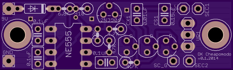

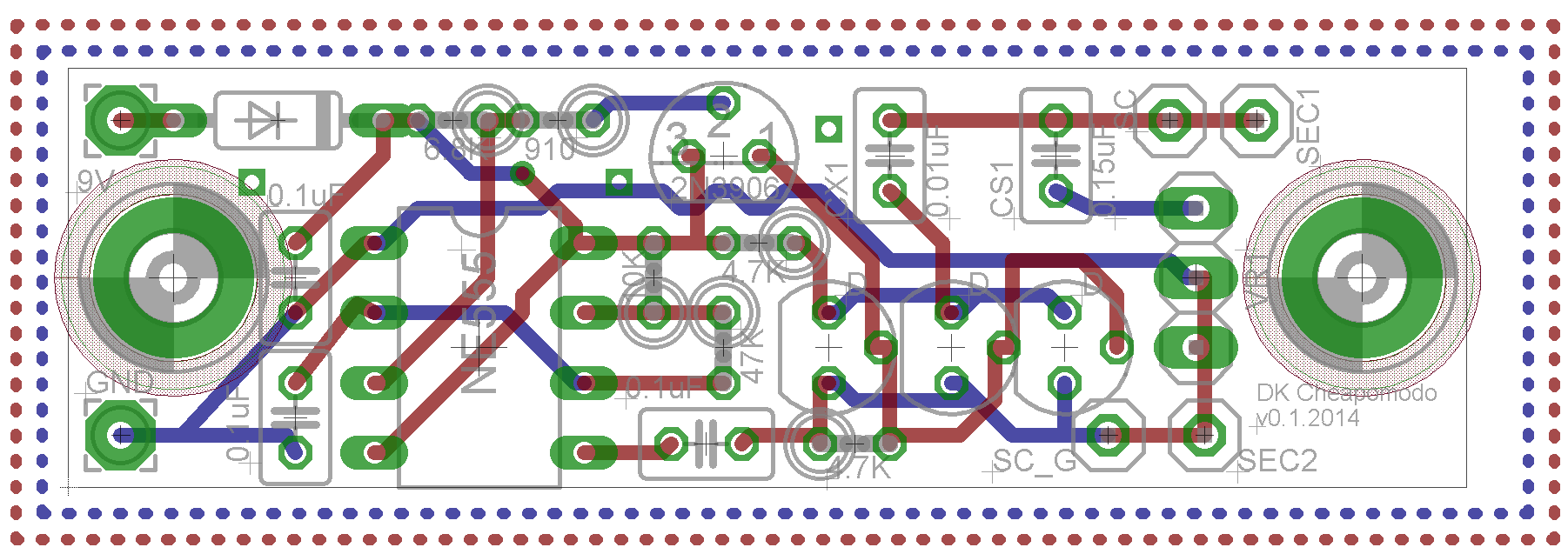

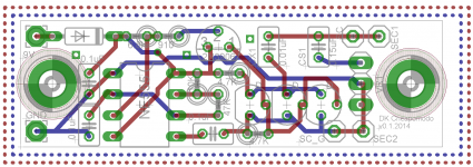

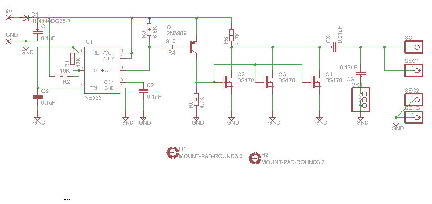

Do you guys mind having a look at my schematic to verify that I have not done any booboo?
attachment.php
And here is the board
attachment.php
It's 51x16mm and cost is going to be 6 dollars for 3 pieces from OSH park, including shipment...
How is that for a cheapo? :)
attachment.php
Any comments more than welcome. I plan to order the samples at the end of the week.

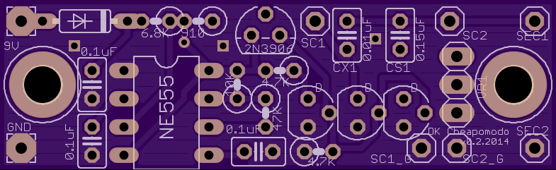

Here we go :)
Pins for two channel scopes, holes to attach clips to grab the secondaries, fixed width 10nF and 150nF caps (it is a cheapo anyway), mosfet drains marked with D to help orient the device of your choice and a 3pin socket for a trimmer.
attachment.php
Oh and it is a tiny bit smaller, so it now costs 5,85 for three pieces :)
Have I forgotten anything?

Will you include a GND flood on both blue and maroon layers? The naked via next to CS1 suggests that you will. It would be a good idea.
I don't see any electrolytic bypass caps; check your deltaV = (deltaT * I / C) calculations to be sure the supply ripple will be okay when operating from a 9V battery with its relatively high internal resistance.

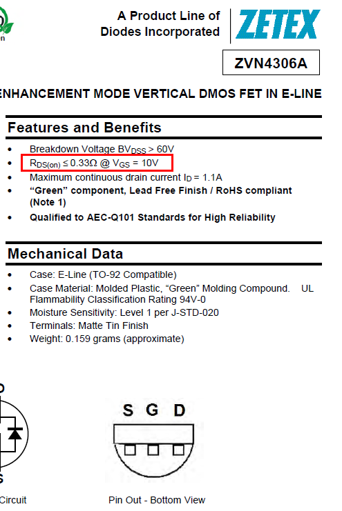

If you're going to discard the 2N7000 junkbox MOSFET anyway, why not replace it with a low-RDSon TO-92 MOSFET ? The one in the attachment has the same pinout as your BS170, but 15X lower Rds. You could build one of your 3 boards with good FETs and the other 2 boards with cheap FETs and see if there's a difference. {On high current 6.3VAC heater windings/transformers, there may indeed be}
Yes ground planes on both sides.
I used the BS170 because I saw it as an alternative on a previous post and I found it in the eagle libraries. I m keeping a note for the Zetex :) It is available on mouser for about a euro.
About the electrolytic bypass, I got a rush as soon as I saw that function :)
Any rough guestimates on what should be used? Something like low esr 100uF?
One more successful Cheapomodo
Similar to the previous poster, I also used BC556/546, some BS170 mosfets and a prototype board to produce a cheapomodo.
It works like a charm, thanks a bunch Mark.
