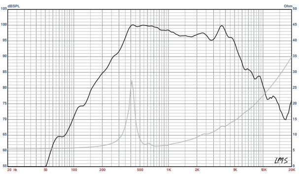

His mids are fine. The Behringer A500 amplifier supplies 125w RMS into 8ohms, the Pyle PDMR6 Sealed Back speakers have a 150w RMS power rating, 300w program power. Power handling is not a concern. Closed back midranges have a high resonant frequency which after response drops off substantially. Pyle does not release response graphs, attached is a realistic example by Eminence. There will be a small amount of overlap from ~400hz to ~800hz.
Simpler is better, don't worry about putting a high pass on the mids. If you want to be technically correct, you could cross the 15" drivers at 400hz instead of 800hz. You may be more pleased with this sound, too. Listening to the system with the 15" driver disconnected is a good idea. Experimenting by crossing over the 15" @ 300hz or 400hz with a 5.1 sound card and foobar2000 is an excellent idea. It is free to you, and you may end up improving on your already satisfying sound. Or, if you are simply happy with the way it is, don't change anything.
Thank you for bringing some truly helpful and reliable information into this thread.
Hopefully now people will stop nagging about that mid range blowing itself up, however please note that I will be throwing the behringer a500 into bridge mode to power the mids & highs as soon as I get the other channel fixed (yes both my amps need filter caps).
