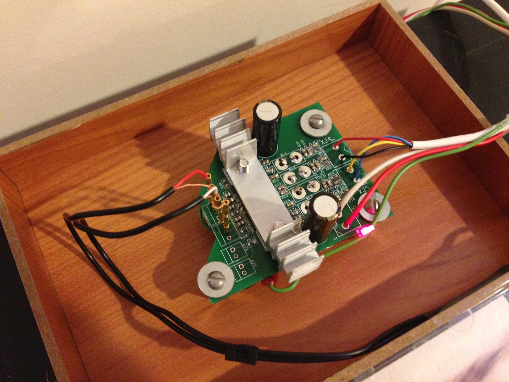

I did a quick search on Digikey for "half brick" and immediately got a hit for a low cost heatsink.
A 4.7 deg C/watt (natural cooling), 61 mm x 58 mm x 24 mm (fins) aluminum heatsink with pre-drilled holes is $3.65ea in stock. Very nice! Probably cannot handle more than 10 watts, but perfect size for a class D amp.

Told you they were under $5 each in single quantity. Simply unheard of price for almost any other kind of heat sink.
To get a little distance to the heatsink a double adhesive thermal pad could be used. They come in sizes that roughly match the chip (a little oversized but that doesn't matter too much) and in thickness' from 1mm to 5mm with 1 or 2 being the most obvious choices.

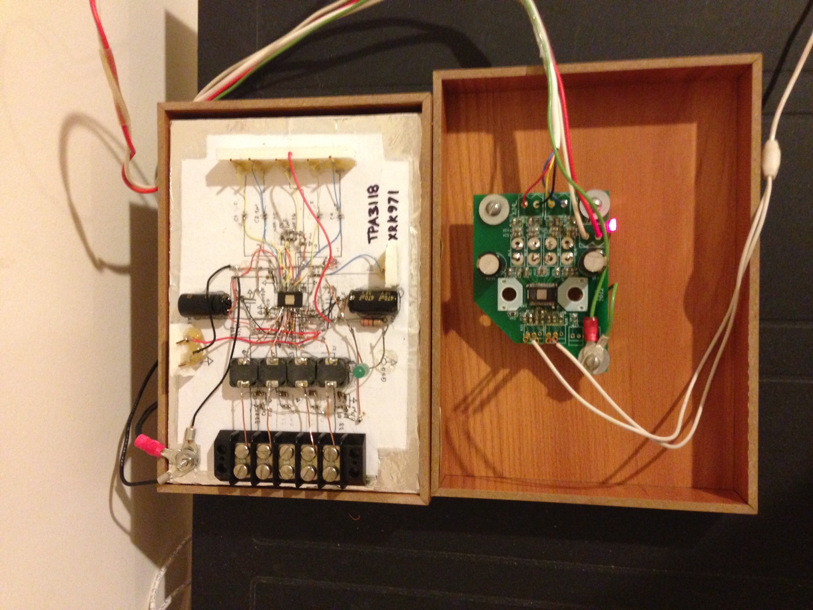

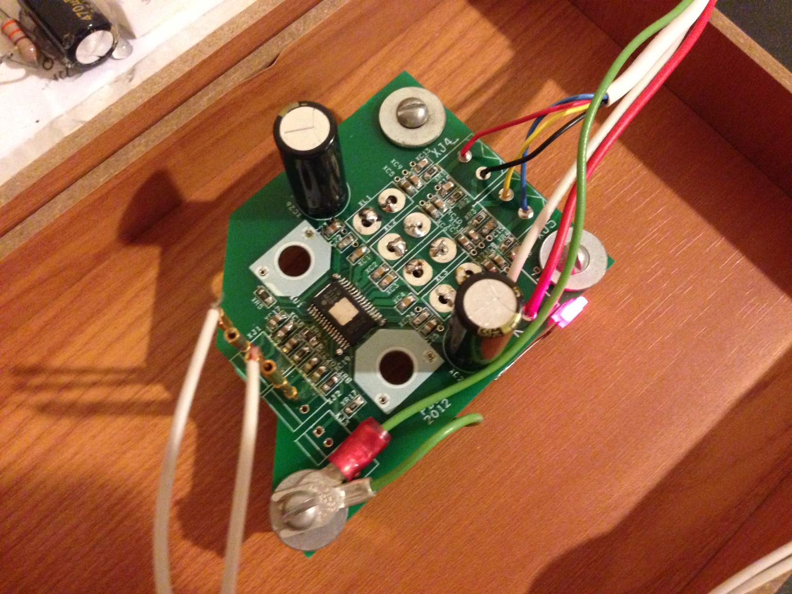

Update on TPA3116D2 build
So I squeezed in some time between waking up and going to work to solder the 3116 onto the PCB this morning. Got it done but was in a rush and of course it did not work when I fired it up for the first time. I hate leaving a nonworking build because of time constraints. Anyhow, had more time after getting home to go over it with a loupe and continuity checker and found a microscopic solder bridge between the bootstrap capacitor and the Vcc rail. Need to rework it with some solder braid. Crossing my fingers....
TPA3116D2 is a Success!
Yep that solder bridge was the problem. I had to take an xacto knife to break it - solder wick could not remove it. Powered it up and it works like a champ. It sounds great. So far I can't tell the difference between this and the 3118 without taking the volume up. It's night time so the extreme volume would not be very good to try out now. I owe a Big Thanks to Dug for his help and providing the PCB.

I finally made a proper heatsink now I can push higher powers

Thanks for all your help Dug. You led us all down this path by being the first to run it with your own pcb. It really is a simple circuit and your design is fantastic. It sounds wonderful. I shake my head when I listen to it and look at it, I just marvel at the technology that has let TI put the equivalent of a 20 lb rackmount amp from 20 years ago into something the size of credit card.. It is so small and the sound is so big, deep, wide, spacious, open, .... clear. I love this amp!
Thanks again for the help and the inspiration!
Hey, it looks good (a lot better than the foam board one )! I am glad you like the sound. So all the effort putting into it are worthwhile. You are making me craving for it!!
Lo Tse,
It's all worth it. Great sounding amp. What's interesting is that the foam core version is just as quiet and sounds just as good as the PCB. Just not robust. I highly recommend both of these amps, you can't go wrong. As a DIY it is very cost effective.

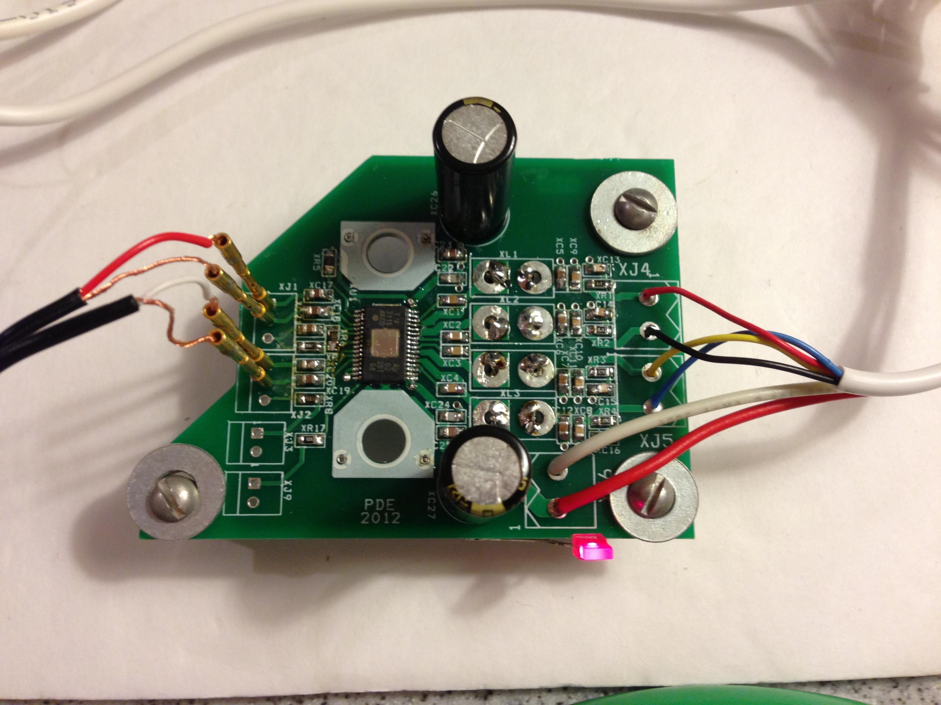

xrk971, Now that's a prototype to be proud of next step pcb layout & fab
Cheers
Rick
Thanks Rick. I have downloaded Eagle and identified Itead to do boards at $10 for 10. How can you beat that? Just need to find time. I want to make the TPA3116 into a tiny board, as small as I can possibly go.
