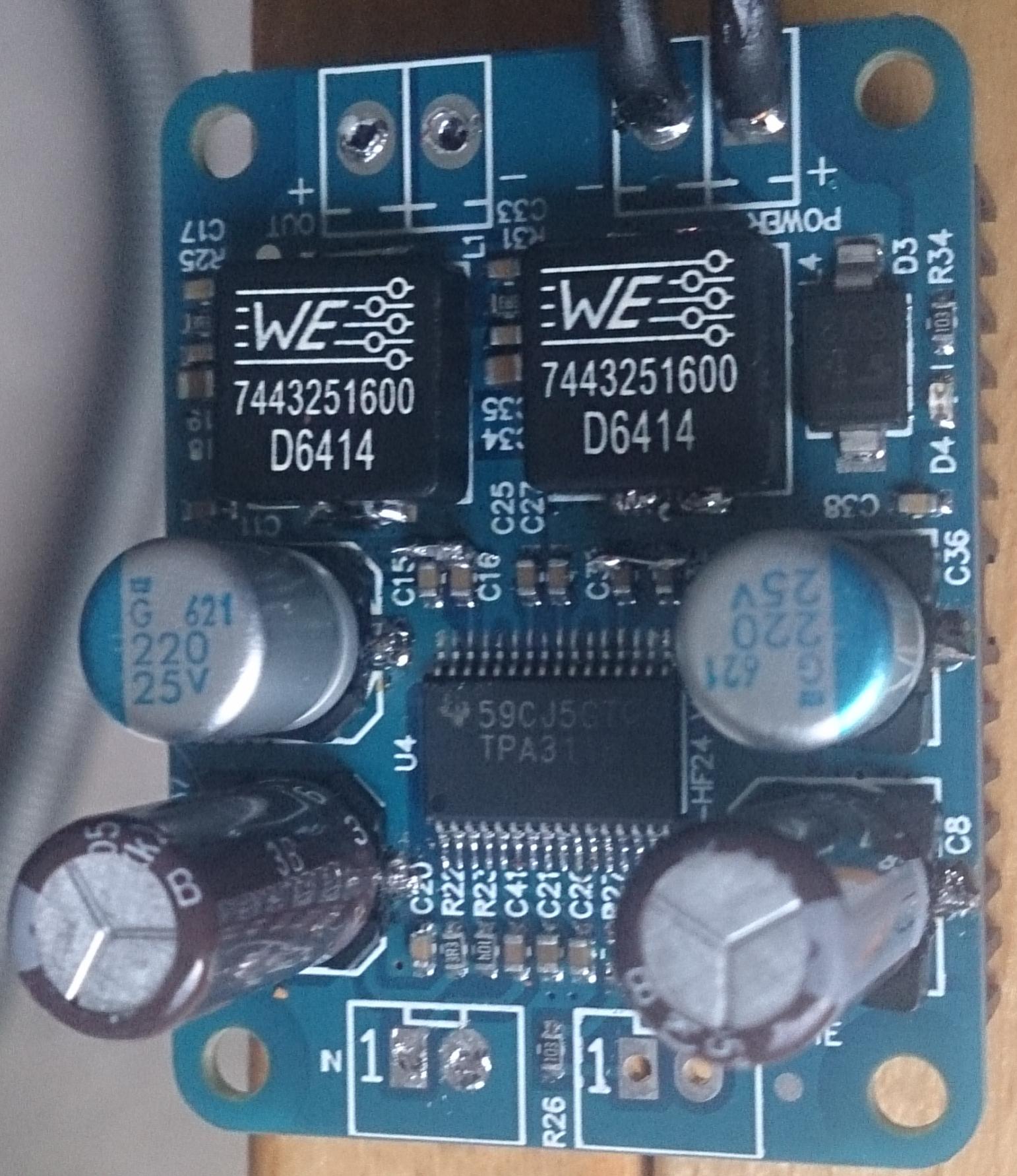

Ok pic of uggly soldering and a probably more expensive 3118 than Volt+, just Panasonics for snubberresistor :)

Volt+ is a reasonable priced amp and it has TPA3118D2 ..... Please see thread title "Cheap TPA3118D2 boards, modding them and everything that comes with it". I am modding one right now and will post pics.
In this thread !
The stereo set of 2 ampboards including free shipping is 5 euro. Including VAT that is also the price of 1 inductor. So valueformoneywise it can only be a stupid idea :)
I haven't compared just inductors and they also are a little different value (less difference than markings suggest, the chinese are 20-40% above marking, the Wurth differed max 0.7%, so well within 20% tollerance specced) :D
