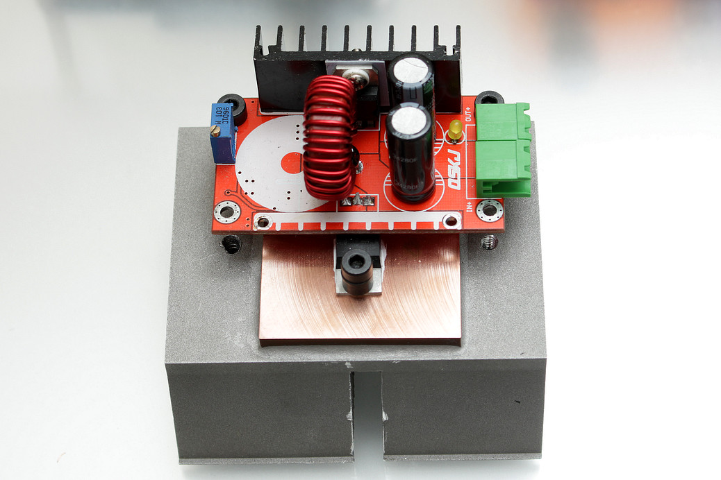

Seen those in the past, looks like a TL494 implementation. My "overhauled" UC3843A >should< do as well, if the battery's impedance is small enough.
attachment.php
With the help of some additional ceramics at the input.

Damn dude, nice work on that one. Is that the 97V output version? I have that same board downstairs powering a 13Sx3P LED from 6Sx2P 18650 for a lantern that will light an entire room for about 2 full days on battery.
Just 35V.

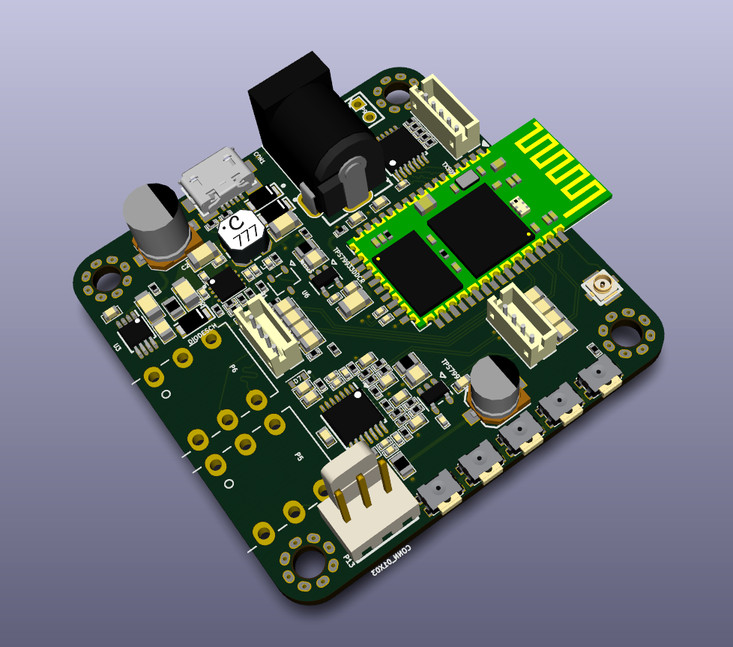

Beside that, having a bt receiver hanging on a buck, always gave me trouble with noise. (Those cheap BT implementations even have some noise when powered by pure DC, when not made by CSR and connected differentially to the amp.)
I had some better success with these cheap MP3/FM/TF-Card/BT modules with display. (But even these needed some change in their LC filter)
Like these:
Auto Digital LED 12V Bluetooth MP3 WMA Decoder FM Audio Modul USB TF Radio H293 | eBay
But they're avail cheaper. (Hard to coat them anyway.)
Best would be a board with CSR chipset, like one i have actually in the pipeline.
(Or using a isolated DCDC for the BT)
Nice board Doc!
Before cheap integrated amps with BT were available I made a few with a BT module and class D amp separately. Always had noise issue and only thing that fixed it was a Murata isolated DC-DC converter.
That Sanwu I have now makes it easy. Also no noise.
