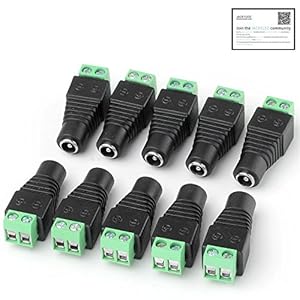

I just ran across this for CCTV apps - but seems awfully handy for getting SMPS walwarts with 5.5mm plug to these small SMT amp boards with solder holes (or 5mm terminal blocks that can be installed like I did).
$2.24 for 10 is cheaper than buying raw 5.5mm female jacks.
http://www.amazon.com/5-5mm-2-1mm-Female-Connector-Camera/dp/B005CMP434/

Those are handy, I use them often. I have the males too.
Amazon.com: 20 Pcs 2.1 x 5.5mm DC Power Male Connector Plug for CCTV Camera: Electronics
