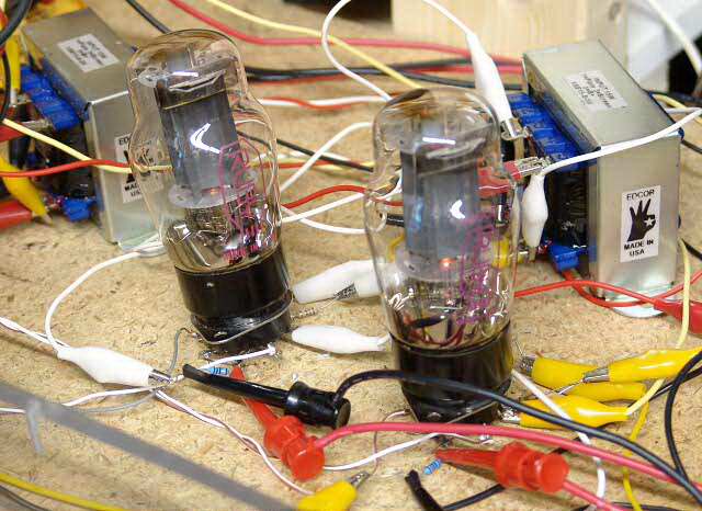

OK, experiment done. Before testing the 300B's with a 4 ohm load, I ran a few measurements with the 45's. As I had stated earlier these transformers need the most current of all the transformers tested to be happy. With the 300B's (8 ohm) the 3rd harmonic totally dissapears at 80 mA. When I tried the 45's the third started dropping at 40 mA and I stopped at 50 mA. At this point the distortion at 1 watt was 1.4%, but you can't run 45's at 50 mA for long. At 30 mA the distortion at 1 watt was just over 4%. Clearly the 45's measure much worse than the 300B's, but I prefer the sound of the 45's on all but the loudest music. So much for conventional measurements. Now back to the topic.
I put back the 300B's and hooked a 4 ohm load to the 8 ohm Edcors. Then I ran the same tests at the same power (not output voltage) levels and bias (80 mA) as before. 300B's do not mind a 2500 ohm load. This load resulted in 8.4 watts at soft clip. 305 volts B+.
The 1 watt frequency response under these conditions is now 12.2 Hz to 43.3 KHz. Distortion is 1.1% mostly second harmonic. The third harmonic disapears at 105 mA.
Frequency response at 6 watts is 23.7 Hz to 40.8 KHz.
Gee we lost some highs, and gained a little bit of bass, kind of like what we said would happen. In this case there is plenty of high frequency to give up. So far my only complaint with these transformers is their desire for current. Maybe the gap is just a little too wide for small tubes like the 45.

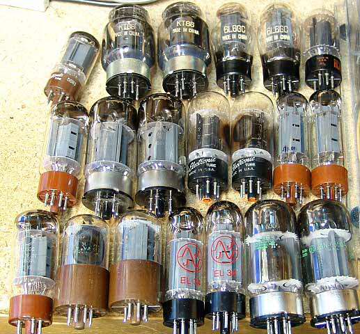

The tubes were selected to try mostly low cost tubes, a few favorites and a pair of NOS GE 6550A's (expensive by my standards).
Bottom left (and above it) are Svetlana winged C 6L6's, new. These sounded good. Triode mode good for most music, UL for loud rock or techno. I ran them at voltages from 250 to 400, adjusting the current to keep the dissipation under 25 watts. I liked 400 volts, 60 Ma in UL best overall.
Bottom row, right of the Svet is a pair of Sylvania 5932's, definitely used. A sleeper in guitar amps, except that they keep popping out of the sockets in a Bandmaster. These sounded a lot like the Svets, but I could push them to 30 watts without any signs of distress. Same deal, I liked 400 volts 70 mA UL.
Next, JJ EL-34's, new. Definitely different. In triode mode, these sounded the most like a DHT. The most detail in the music was revealed with this combination. As with many DHT's there was less bass and not as much punch. UL adds back some of the bass and punch, but takes away some of the DHT sound. In triode, I liked 325 volts at 80 mA, conveniently this is the same operating point that I like for a 300B with the Edcors.
Bottom row, far right is the pair of NOS GE 6550A's. This is the polar opposite of the EL-34. Best for loud rock, techno, and anything else that you would turn up all the way! I liked these best in UL with the power supply maxed at 400 volts and the current at 75 to 80 mA. Best bass, punch and dynamics. These sound the most like my 300B push pull amp.
Second row above the 5932's are Sovtek 6550WA's. These are used and 5 years old, but I also tried a NOS pair. Almost as good as the GE's but some loss of realism. The used pair suffered from bias creep. The current kept climbing.
Next up is a crusty old pair of GE 6L6GB's. I pulled these out of a Fender Bandmaster where they had lived a hard life for at least 10 years. These sounded remarkably like the other 6L6 types and worked happily at 25 watts despite a 19 watt rating. I played them for 2 hours at 400 volts and 60 mA, no complaints. These are proof that these old GE's were made well.
Far right is a pair of new Svetlana winged C EL-34's. I bought 4 from Antique Electronics Supply. One was bad out of the box. The tube works and sounds good, but there is a screen grid wire that is brightly glowing at any voltage above 250 volts. I don't feel comfortable using this tube because it will likely fail catastrophically. Other than that they sound a lot like the JJ EL-34's. I think I like the sound of the JJ's better, but they are close.
The fat guys on the left of the top row are Chinese KT-88's. These were made at least 10 years ago. I bought about 50 of these for an average price of $12 USD when a local tube dealer discontinued them. He said that he got too many returns and he warantees all of his tubes. I bought them all and found that they sound great and are reliable at 400 volts or less, and 30 watts or less. If you put these in a Marshall Major or an SVT, you will be reminded that the Chinese invented fireworks! I tried two pair and found that they do indeed sound great, as good as The GE 6550A's, maybe better bass, but they start to glow at 30 watts (400 volts 75 mA). If left alone at 30 watts they can go into a runaway condition. This WILL happen (4 out of 4) at 400 volts and 85 mA.
To the right is a pair of Chinese 6L6's see the next post to find out about these.

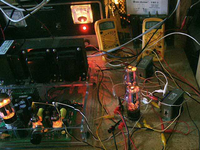

I was looking up the prices of the popular audio tubes being tested above on several web sites, when I found a bold statement. On Antique Electronics Supply's web site there is an add for a "6L6GC China Coke bottle" for $7.95, followed by the statement "We could not blow up this tube, no matter how hard we tried." Now this seems like a challenge to me. I dug through my collection and found a pair of tubes that look like theirs, except they have the Ruby Tubes logo screened onto them.
I put these into the amp and proceeded to turn up the juice. If you look carefully in the attached picture you can see the voltmeter on the power supply ix maxed at 400 volts. The digital meter on the right shows 110 mA. This is 44 watts per tube. There is an even glow on the plates, and the tube is stable with no hint of runaway. It ran at this current for an hour with no problems. I turned it down to 80mA and there is no glow. I am sure that I could blow up this tube if I really tried, but they are really tough.
I have been listening to these for 3 days and find them to be the best overall compromise. In triode they are almost as good as the EL-34's and in UL they are close to the 6550's.
