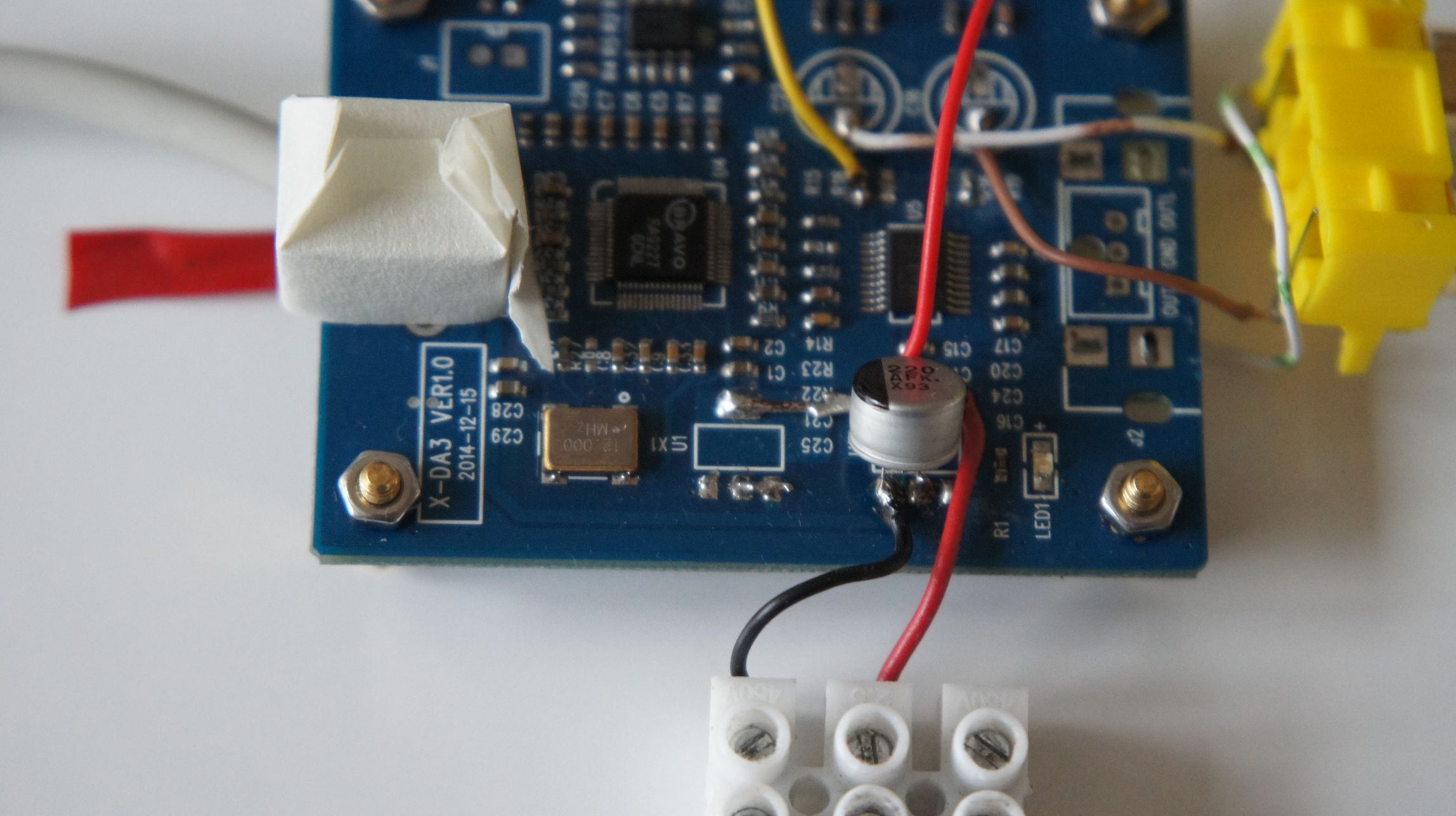

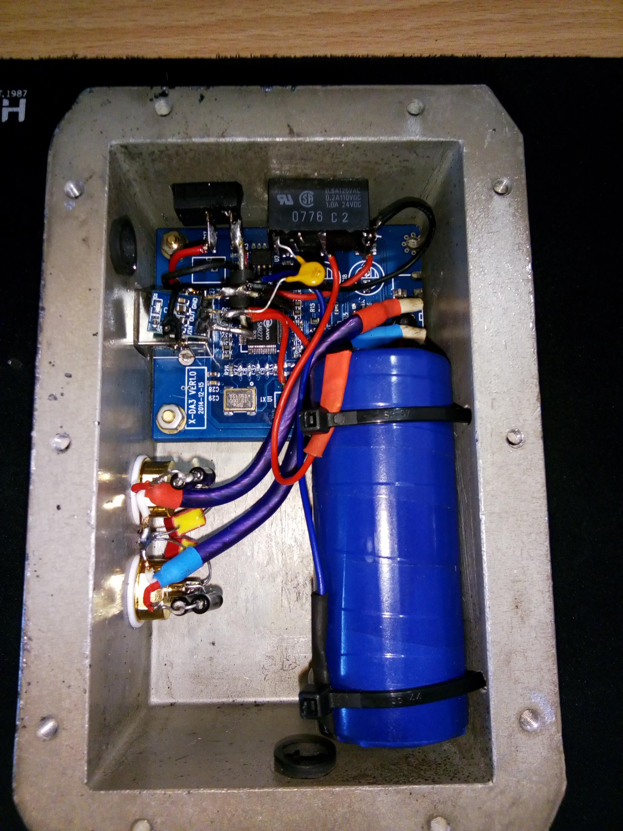

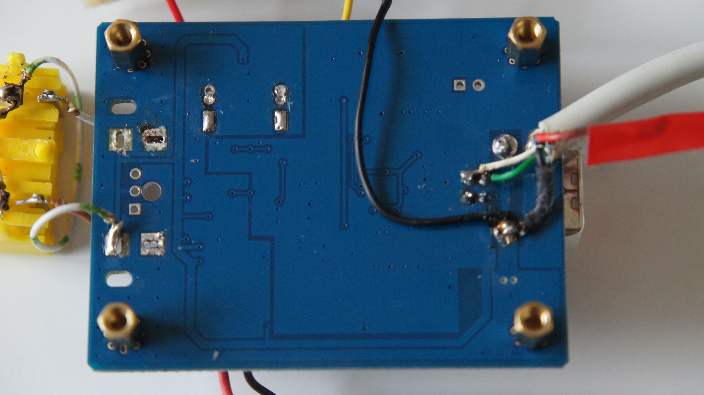

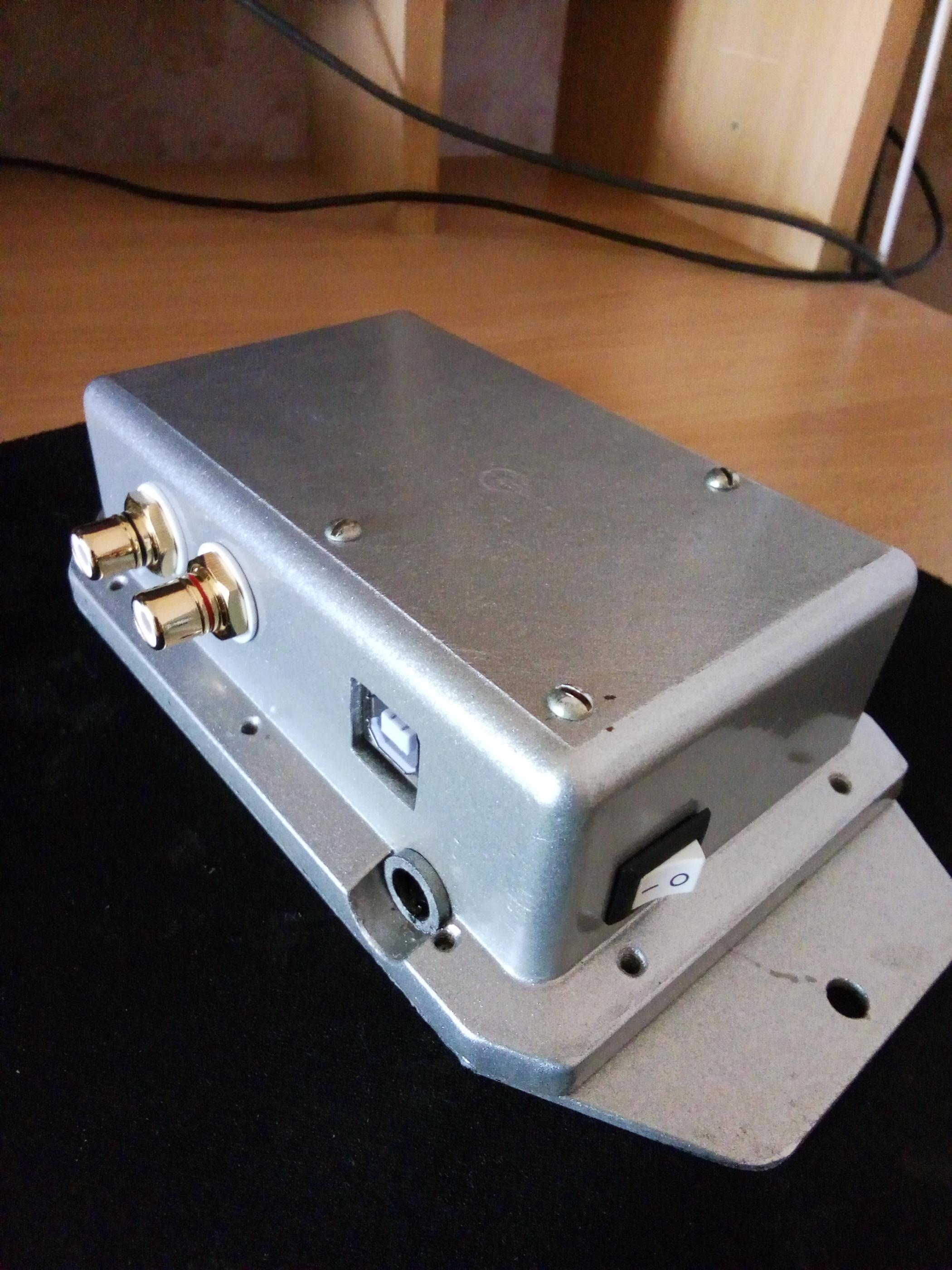

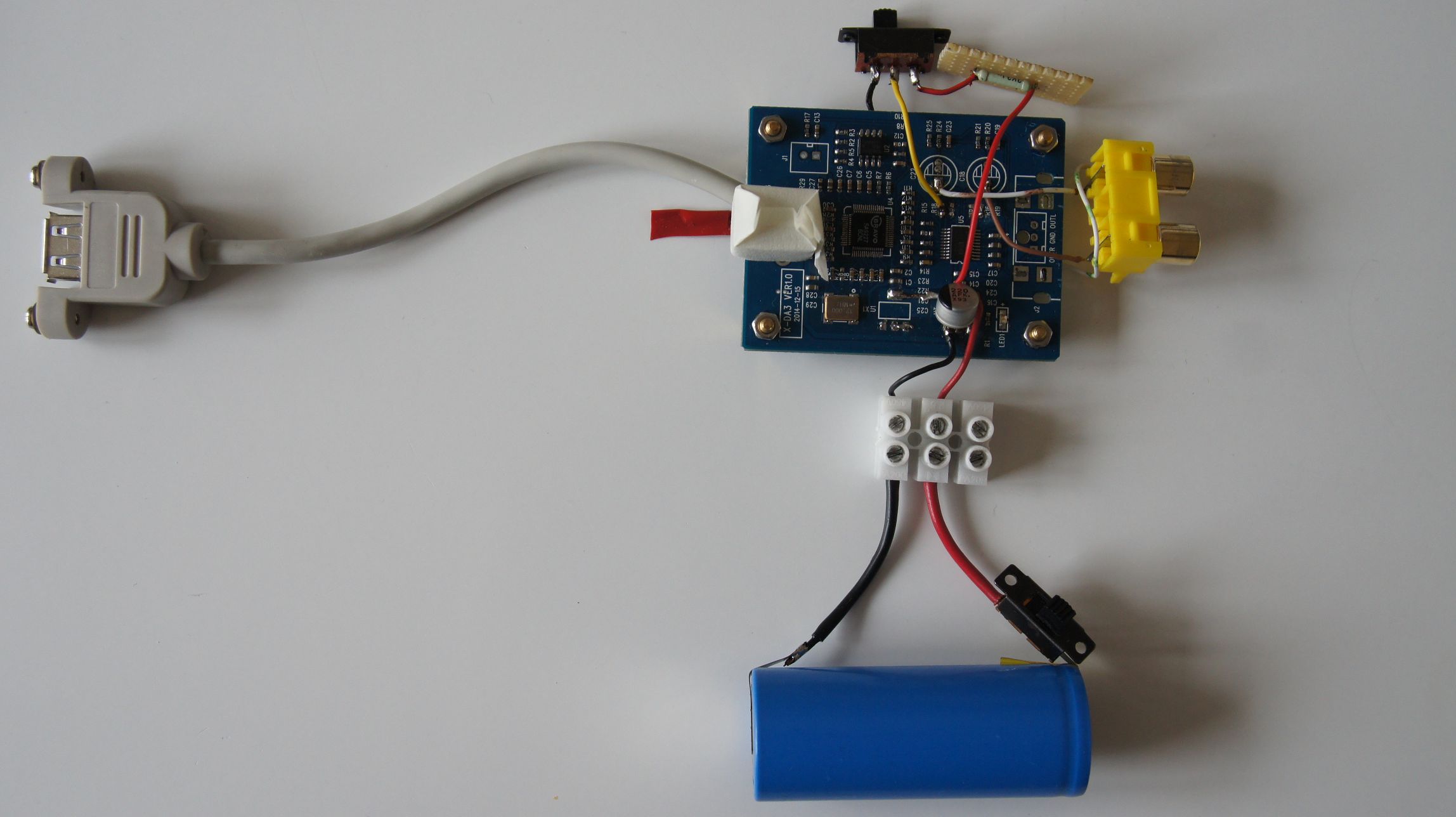

:cheers:: ура:I did everything as suggested by bjd, replacing only the switch on the relay, which automatically turns off the battery when the computer is turned off. The sound is very good, thank you!
Good to hear you modded DAC is working a treat.
I managed to improve the sound quality even further by finding a cheap USB hub that has a 3.3v chip being fed by USB power via a voltage regulator. I removed the voltage regulator and fed it's power from the DAC's battery directly using some hook up wire. The hub connects via an usb adaptor to the back of the DAC and from the hub a usb cable is connected to the PC. This cheap hub fed with clean LiFePo4 power works a treat a 'regen' clone.

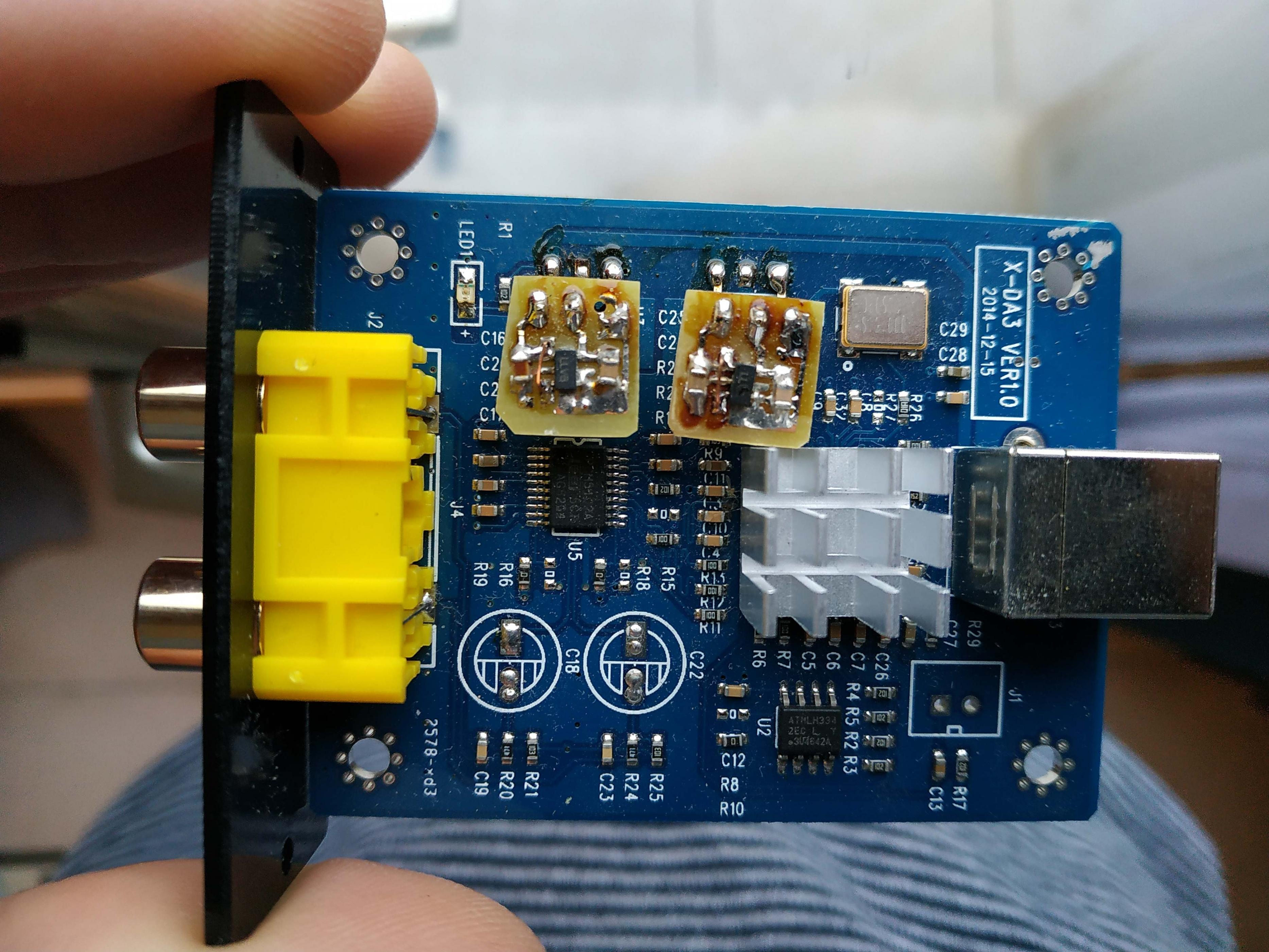

Hi.
@chatziva.
I use two an orange pis as audio/web radio player (mpd+rompr), it works great and play DSD over pcm as well.
Mine are Sa9227 + pcm5102a.

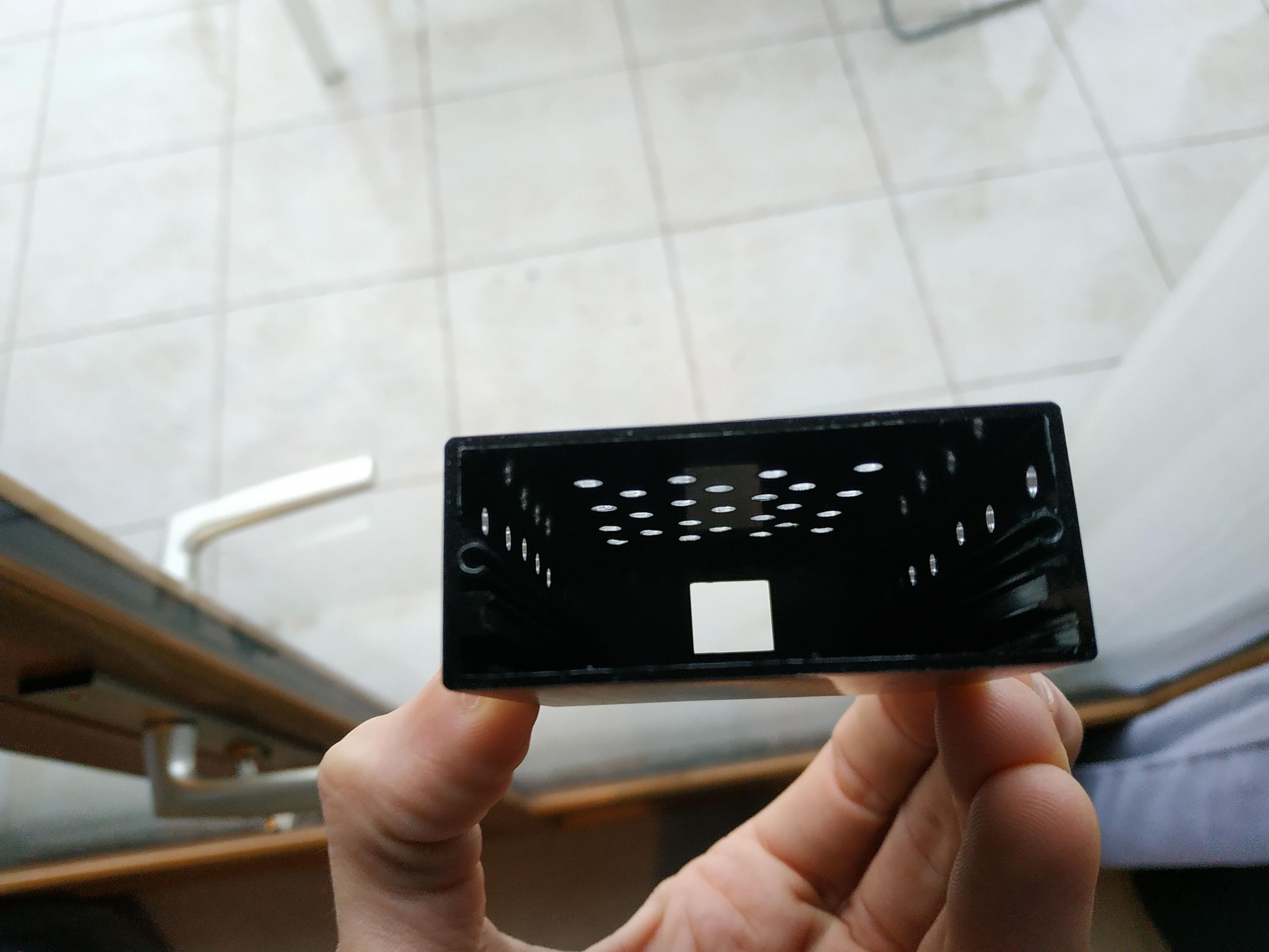

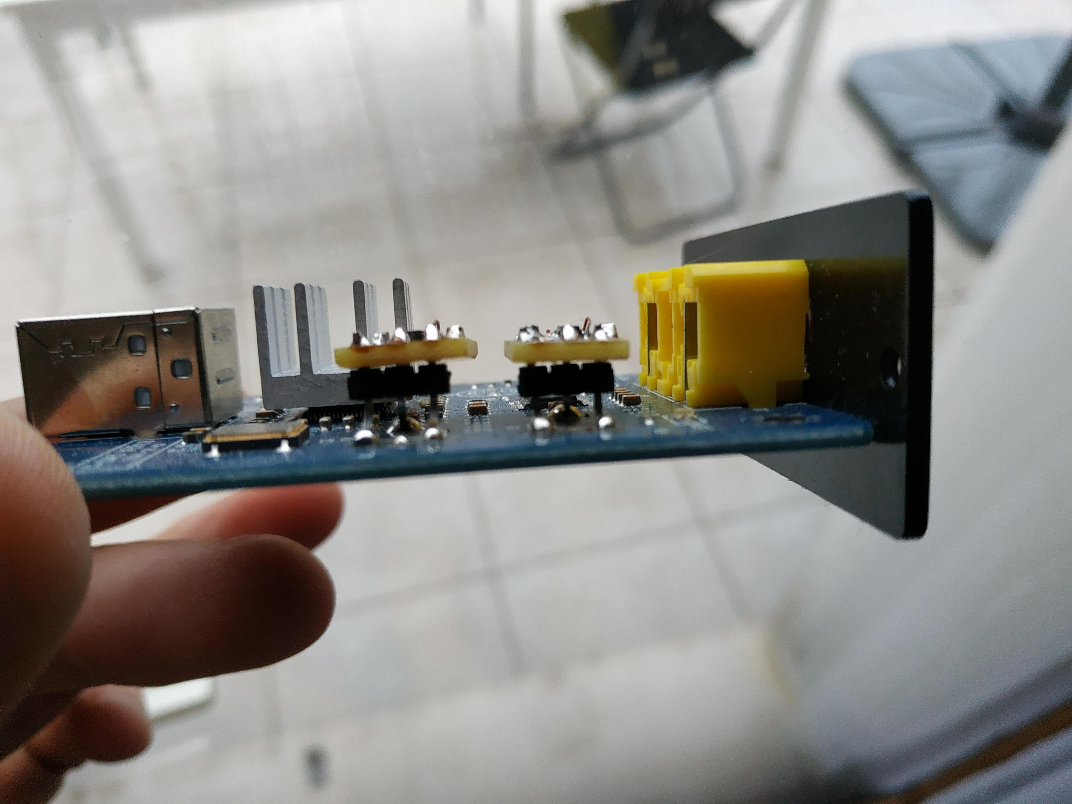

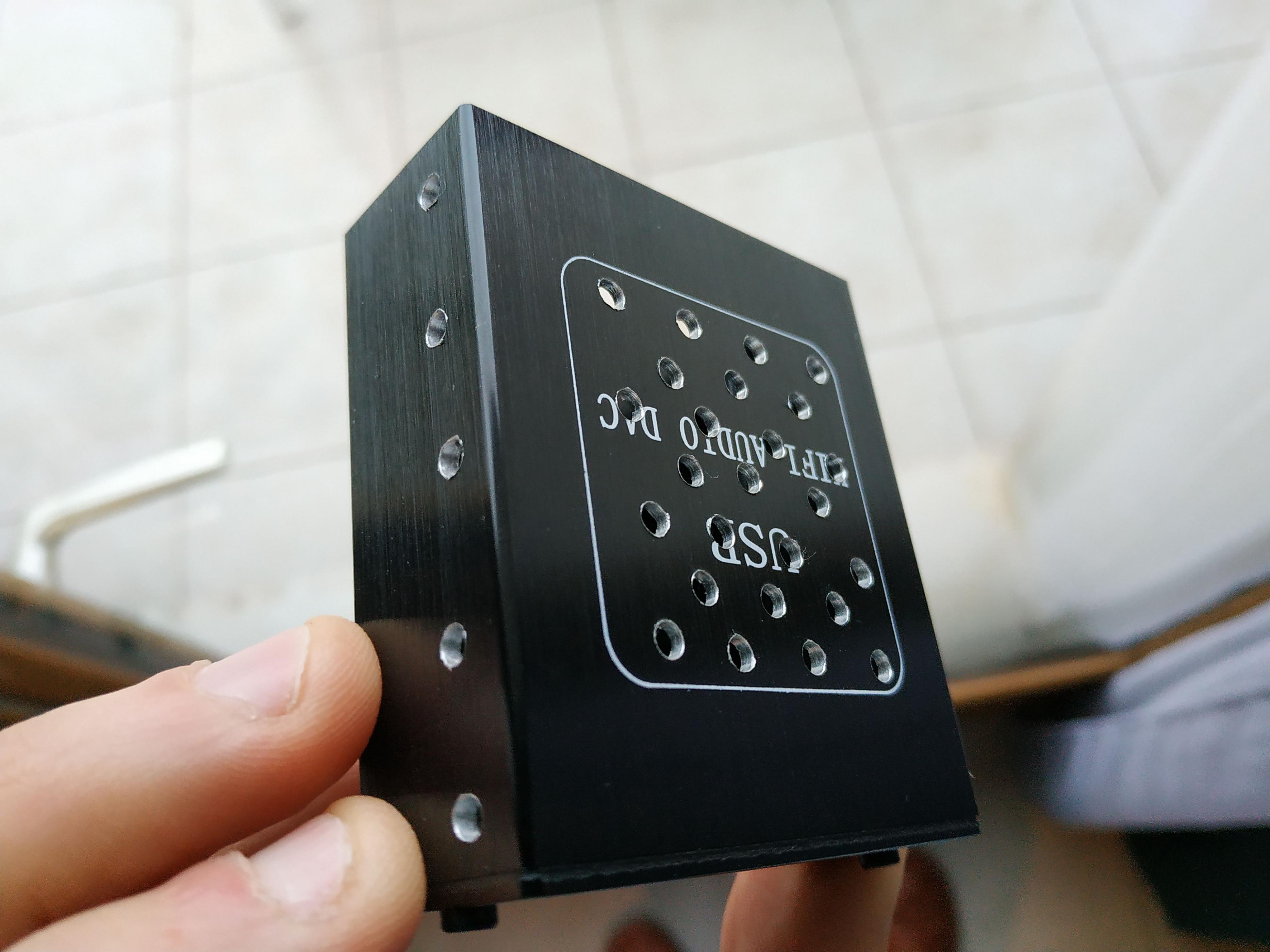

I replaced ams1117 with lp5907, removed the two output capacitors, added 10uf on power line and it sounds nice, not as good as my ak4490 diyinhk kit but I find it really nice for price.
The only cons I see is they overheat a bit and I drilled the enclosure with many holes to ensure an air Flux.

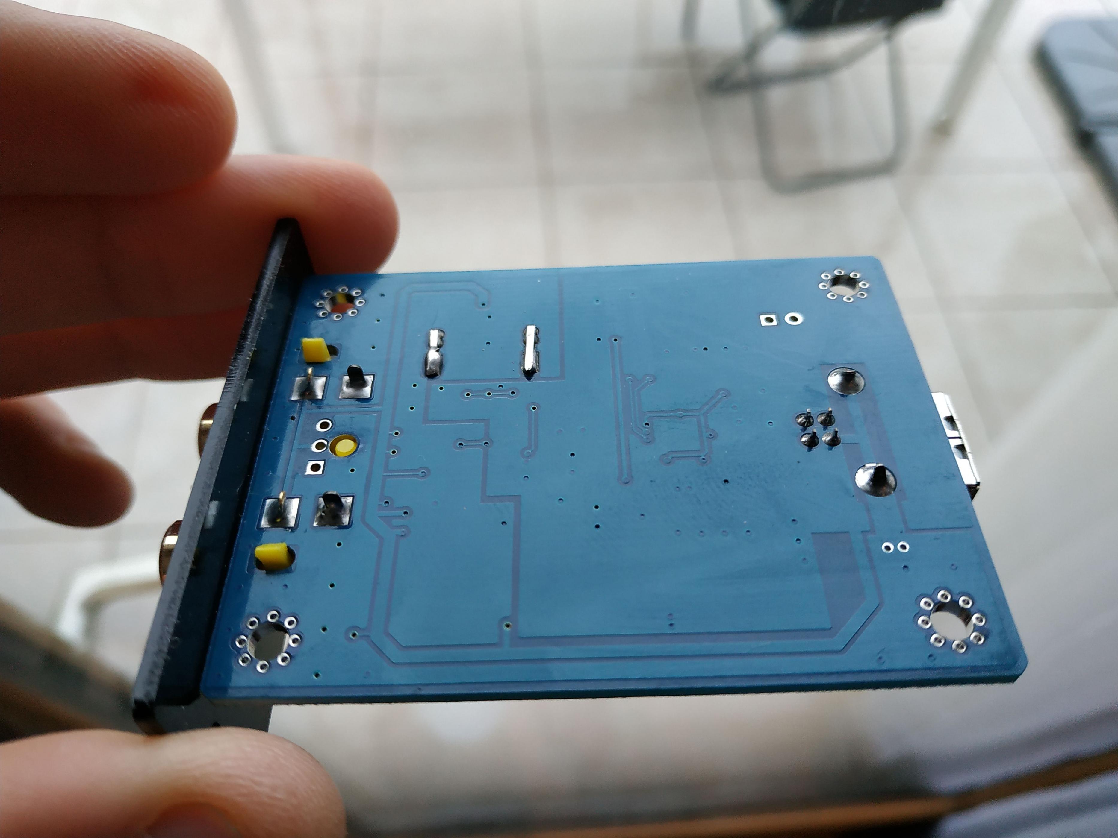

Thanks minik sound interesting. Pics?
Hi.
@chatziva.
Pics.
Since I moded it a log time ago, I forgot that one had a heatsink and no 10u cap on supply line, the one with that cap is for my step father.
I'll add some caps to it too.
Only lp5907 instead of ams1117 and shunted output caps.
I got one with sa9023 + es9023 and, with the same mods, don't like it so much, bass and mids lacks a lot of "body" to my taste.
