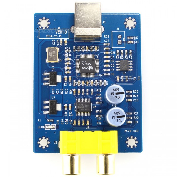

I bought the DA3 (SA9227 with PCM5102A) and this is working fine with Windows (with Savi driver) and RPi running Volumio. I haven't opened it up yet but believe this is the PCB:
The 10uF electrolytics appear to be output coupling caps, and if so these can be removed/bypassed. After that I will check the capacitance before and after the AMS1117 regs, and add/replace if need be. I'd be keen to try a lower noise alternative to the AMS1117 but haven't yet identified the best option. I'm not going to spend any significant money, and am keen to keep everything within the existing case. Basic tweaks where these can make a difference.
The 10uF caps were output coupling, so have been removed. I measured approx 12uF on the output of each AMS1117 reg, and also 12uF on the USB 5V connected to the 2x AMS1117 inputs. As a first pass I added 100uF from input to ground at each AMS1117. No change to reg output caps.
When I first listened to the DAC (before mods) it didn't have any obvious problems. It sounded nice - maybe a bit less HF and punchier in the bass than the ES9023 I2S RPi DAC I'd been using beforehand. There was a very slight texture to the sound (not roughness, but heading in that direction) but nothing overtly unpleasant.
I've listened for approx 10mins since doing the mods detailed above. The slight roughness has gone and the HF is more open. There is an increase in depth. Pretty much what I'd expect after removing un-biased electrolytic coupling caps (so quite possibly a psychological element going on!).

No need for output coupling caps with the PCM5102A - I've just measured +0.3mV DC on both L & R outputs.

Are you sure that 10uF are in series with output? I would have thought they are between Analog VDD and analog GND?
If this device is host-powered only, you should take into account that everything > 1uF is not USB-conform when not having inrush-current-limit or softstart.
What is to expect from un-biased vs. biased electrolytic caps?
Regards.
My DAC is connected to a Raspberry Pi so is essentially connected to the 5V PSU for the RPi (not a typical USB power implementation). The additional capacitance doesn't cause issues here, nor on the Windows laptops I've also tried. Good to know this may be problematic in some setups - I wasn't aware of this limitation.
The PCM5102A output is 2.1Vrms (2.97Vpp) centred on 0V, so the output signal will swing to almost -1.5V. Polarised electrolytics don't tend to like reverse bias of this magnitude, and subjective experience (own & others) is that coupling electrolytics tend to sound worse when not biased properly. The PCM5102A is designed to not require output coupling caps, so no reason to keep them (unless the minuscule DC offset is a problem).

It might be problematic if some kind of potentiometer is following the outputs before connecting the the next (biased coupled) amplifier stage. -1.5V isn't something I would care/mind about but this depends on the caps used. Some "like" it, others might not but they will some sort of "reformat" to this over time.
(Beside this, I never use elythics in direct signal paths)
For the cap limitation on USB, well most host controllers can deal with it but it isn't compliant to the specs. Most possible trouble s when they do some kind of enumeration or fancy data-line toggling, like charge controllers or current-controllers. Depending on the current demands of the DAC a simple current limiting series resistor helps and gives additional filtering (RC) as a benefit.
