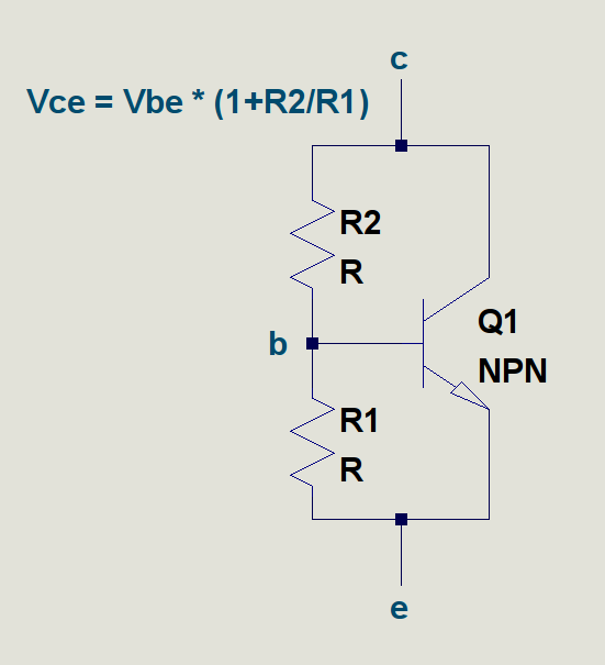

Anyone ever try using a Vbe multiplier to replace an LED? You can dial in any reasonable voltage drop you want from 0.7V upwards by using a trimpot for (R1+R2) in the attached schematic.
I would expect a Vbe multiplier to behave very similarly to an LED otherwise. Both have the same exponential current-voltage characteristic, and if adjusted to the same voltage drop at the same forward current, they will probably behave pretty similarly for small-signal AC changes as well.
The one obvious difference (the Vbe multiplier has a parallel resistance equal to (R1+R2) across the "LED" ) should make very little difference, as R1+R2 will be much greater than the dynamic (differential) resistance of the multiplied diode.

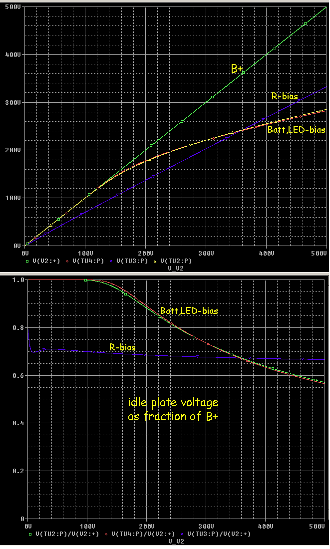

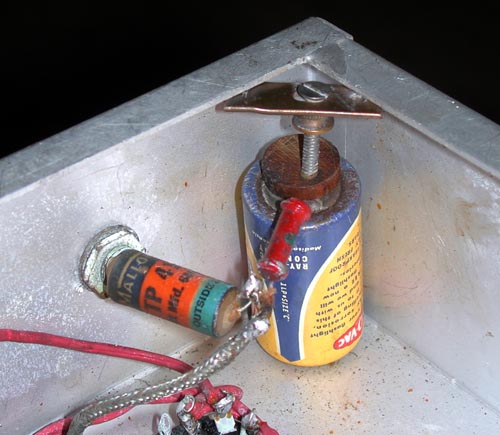

Note that in the 1920s it was common practice to solder a teeny 1.4V battery in the grid lead of an input triode. Fixed Bias.
I too felt that fix-bias would be unaccommodating to supply changes. However I plotted it out once and, assuming your B+ rail tracks your wall-outlet voltage, it isn't a real problem. You will be groping in the dark, or replacing all lamps every hour, before a nice-design LED-bias stage gets far from its happy point.
In part because a triode IS always "self bias" due to plate resistanCE against DC plate resistOR. If it pulls more current, Vp falls, it pulls less current. For reasonable values, deviations are significantly reduced.
