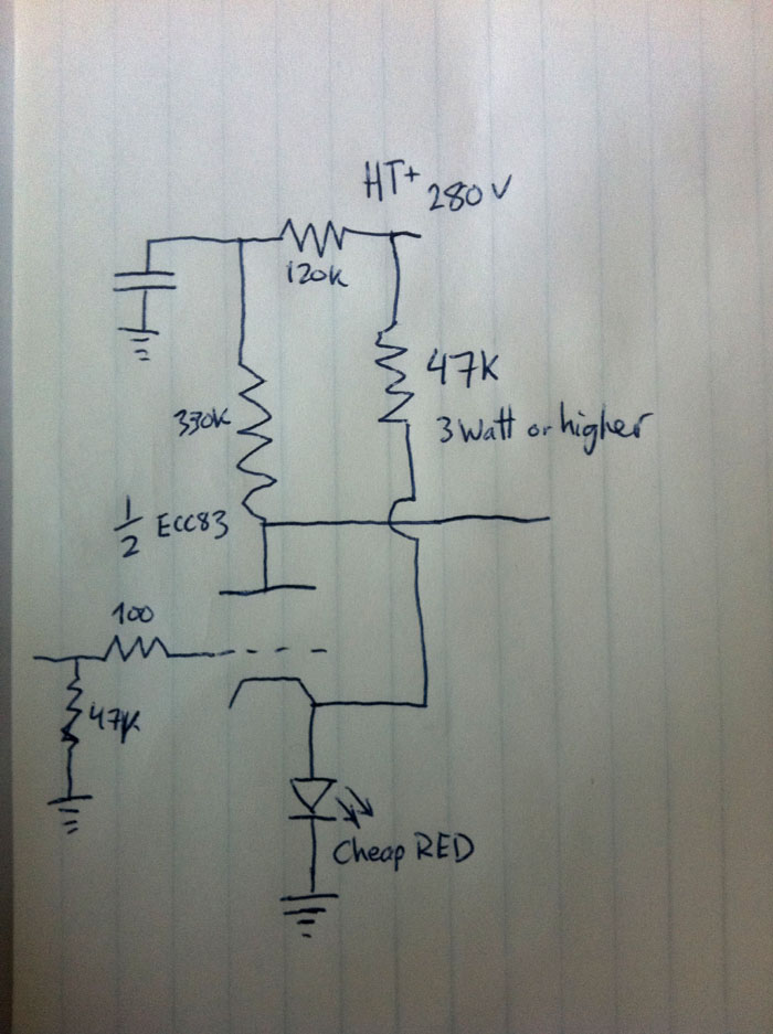

Dear All
I have used LED cathode bias on a number of valves, but only recently tried it on some ecc83. I am pleasantly surprised with the improvement.
The problem with LED bias on ecc83 is that the current draw of this valve is too meager to induce any standard LED to conduct. I therefore bring the LED to continuously conduct by an additional connection, bypassing the valve (and annode resistor) entirely with a separate sufficient wattage higher value resistor directly to the HT.
The value of this resistor is chosen to drop almost all the HT and deliver approx. 6mA current to the cheap red LED. For my test circuit I am using HT of 280 Volts so chose a 5 watt 47K ohm resistor that I had handy. I pre-selected the red LED's and chose two that elevate the cathode by 1.67 volts on each channel.
My method of testing for linearity is a crude point-based method. Nevertheless, I measure distinct improvments that I believe can be heard with my own ears...
The by-passed LED bias on e83cc also seems to remove any last vestiges of power supply noise. Perhaps there is a bit of aikido-stype ps noise injection in this method. Since I by-pass the LED to make it continuously conduct, the effect is electrically similar to filament bias.
When I have used LED bias on other valves the change is distinct and subtle, but the changes I am getting with this method on e83cc seem even more significant. Maybe it is just my own biased hearing though. Has anyone else done this before?

The by-passed LED bias on e83cc also seems to remove any last vestiges of power supply noise. Perhaps there is a bit of aikido ps noise injection in this method.
The dynamic resistance of a red LED is ~5 ohm and the resistor connected to the PS is 47000 ohm. This gives an injection ratio of ~5/47000 or 0.01%.
The PSRR of a commond catode stage is rp/(rp+Ra). Devide that ratio by the gain of the stage and you'll find what to inject to cancel out PS rippel..
Yes, I've posted on this several times and the resistor "trick" was added to the components chapter of "Valve Amplifiers" 4th edition. It's a great way to run ECC83, a tube which is rarely used correctly. If you use a CCS on the plate, then buffer the output, the linearity is stunningly good.

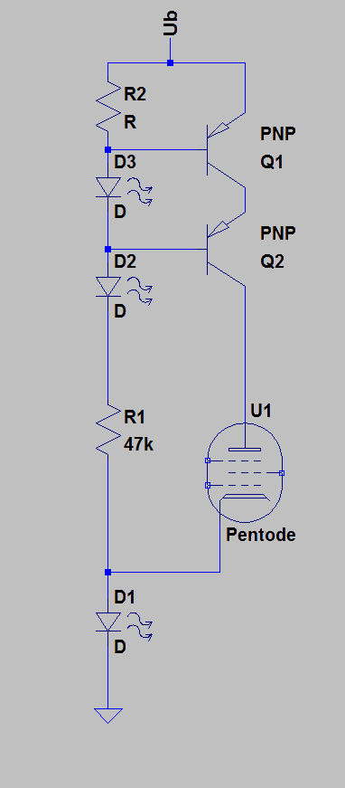

I currently have a 12Ж1Л Pentode running at about 1mA with a CCS and LED bias. Cathode LED and Anode LEDs share the same resistor. See attachement. works well, of course with feedback due to gigantic amplification.

[...] I therefore bring the LED to continuously conduct by an additional connection, bypassing the valve (and annode resistor) entirely with a separate sufficient wattage higher value resistor directly to the HT.
Why don't you move the LED bias resistor from the B+ to the smoothed B+ at the top of the anode load resistor. This may buy you further improvement:
a) the B+ is smoother so marginally less noise
b) you will create a shunt, a constant current draw that will improve the regulation of the B+ at the top of the anode resistor.
You will need to lower the value of the 120k B+ dropper resistor of course.
If you put the resistor downstream then you have to be certain that any other resistors upstream can carry the additional current load.
I didn't want to create an incendiary device... (the schematic as drawn is of course not complete)
Also, my HT is well fitered with chokes so I didn't have any extra noise (in fact I experienced less noise). Otherwise I see no problem with what you suggest.
