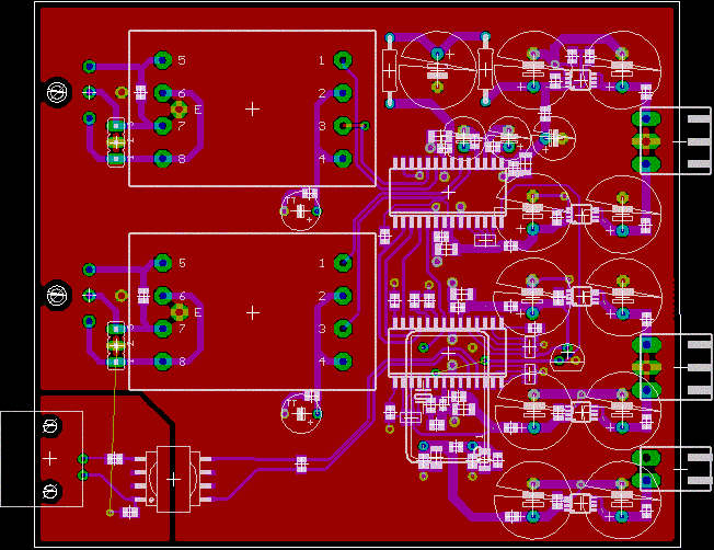

There are three ground connections: the Molex one at the top, a via on the left, and one at the lower right. In a previous post you said that the one on the left is connected to the chassis; what about the one at the lower right?
Also, what do you think about separating the ground planes all the way back to the power supply through a ferrite bead? I already ordered the PCB, but it would be an easy change to make.
I read JWB:s post about shorting the decoupling traces, I did rework the mounting of the decoupling caps, and i have changed and added a CLCLC filter for the VA and some smaler inductances (recomended by Guido T) and this will be the board I will send to Olimex, It would be great if anyone of you could take i quick glance at it I will do so to in a couple of days..with a fresh pair of eyes..
/micke
edit: and yeah the unroated trace under the CS8420 is for the reset pulse.
/micke
Thanks. I have a couple more questions:
Was the issue with the SCxx-04 you noted in a separate thread corrected on this layout?
On the schematic, the three pins which make up the serial audio input appear to be unused. Could this design be modified to add the separate I2S input, WITHOUT using the software mode, or changing the rest of the circuit?
and finally,
Is the bare board available for purchase from someone, or is it up to each individual to have it fabricated?
and finally,
The problem with the input transformer is corrected on this layout.
To use the serial data input, you would need to modify the hardware operating mode of the CS8420. The modification would be one or two pull-up/down resistors. Check the CS8420 Hardware Modes in the datasheet. You would not be able to switch back and forth between serial input and SPDIF input without asserting RESET (or power-on reset).
I do not have any boards of the Rev. B, but perhaps someone else does. I have two boards of the Rev. A but they have a number of bugs.
PMiczek said:Is the bare board available for purchase from someone, or is it up to each individual to have it fabricated?
I've been thinking of building a couple of these as well. Would you be interested in going in together on a PCB order?
Is this the latest version?
Understood. I have seen that, but I was wondering if there was something else because you mentioned operating in software mode and problems with the hardware mode. I was wondering if the I2S input was left off for that reason.The modification would be one or two pull-up/down resistors. Check the CS8420 Hardware Modes in the datasheet. You would not be able to switch back and forth between serial input and SPDIF input without asserting RESET (or power-on reset).
Sure. I need a few days to figure out if this can actually be used with I2S and S/PDIF out the way I think. Connecting the output is easy, inputs may be a little more tricky. Even if not, I may still be interested because it seems like such a simple and elegant solution compared to wrestling with two Cirrus CDB's and associated power supplies, and, and... not to mention that I have been looking for a good excuse to build some of the circuits posted on this board for a while.I've been thinking of building a couple of these as well. Would you be interested in going in together on a PCB order?

Output level
I have been trying to undestand the output ckt, finally took the time to scan the earlier 24/96 DAC thread, and came across this:
jbw, can you or anyone else who has built this board comment on that? What is the full scale output, (p-p), and what is meant by "ruin the character of the DAC"?
The only thing I fret about is the output level is lower than every other source I have laying around. Can't do anything about that without adding a gain stage, which would ruin the character of the DAC I think. Also there is a turn-on and turn-off click.

The full-scale differential output of the DAC is more than enough to drive amplifiers without a voltage gain stage. However I'm not sure exactly what it is, because I didn't write it down after measuring. What I mean about "ruining the character of the DAC" is that this design has <b>no</b> voltage gain stage on the output. It has a passive low-pass fiter and a simple buffer to drive the line. I believe that adding a voltage gain stage would degrade the sound significantly, and detract from the minimalist philosophy.
