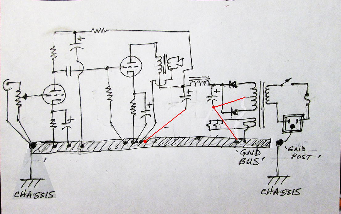

OK, let's see if I'm following correctly. I've done a quick sketch of a two-stage SE amp with the power and output transformers, parts, and where I think everything should be grounded. It would be great if anyone could tell me if this is basically the right idea, or totally off. Thanks.
PS - What I labeled as 'GND POST' is the same as Ian's 'chassis bolt.'
Yup, that's what I do. I have seen other designs where the bus us connected to chassis at the input but that only works it there is just one input (RCA did this a lot on their PA amps in the 1940s and they were very quiet.
Cheers
Ian

Since this is a simple circuit you would probably get away with it as drawn, but if you want to get into good habits you should keep the transformer-rectifier-reservoir in a tight loop, then connect the resevoir cap -ve terminal to the bus. Also connect the bus to chassis at the input end, not the noisy end.I've done a quick sketch of a two-stage SE amp with the power and output transformers, parts, and where I think everything should be grounded. It would be great if anyone could tell me if this is basically the right idea, or totally off. Thanks.
I hope I can get some clarification on this. Do you mean position the power transformer-rectifier-reservoir cap all with their '0V' leads connected to one place, and these parts all located physically as close to each other as possible?
If I'm using a power transformer HT (plate supply) winding with center tap, the power transformer CT should be connected directly to the negative lead of the reservoir cap, and that should go to the ground bus. Correct?
Also, it's still not clear where the LV (heater supply) winding center tap should be connected. Does this go to the ground bus near where the transformer CT-rectifier-reservoir connects?
OK, that's the opposite of what Ian's saying, but I think I understand.
However, are you saying it's OK to connect the safety ground (green wire) to chassis at the AC inlet, and then have a separate '0V' ground bus connected to chassis at the input end, running back through the amplifier to the transformer-rectifier-reservoir cap 0V lead and heater winding CT?

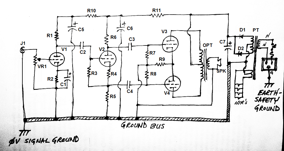

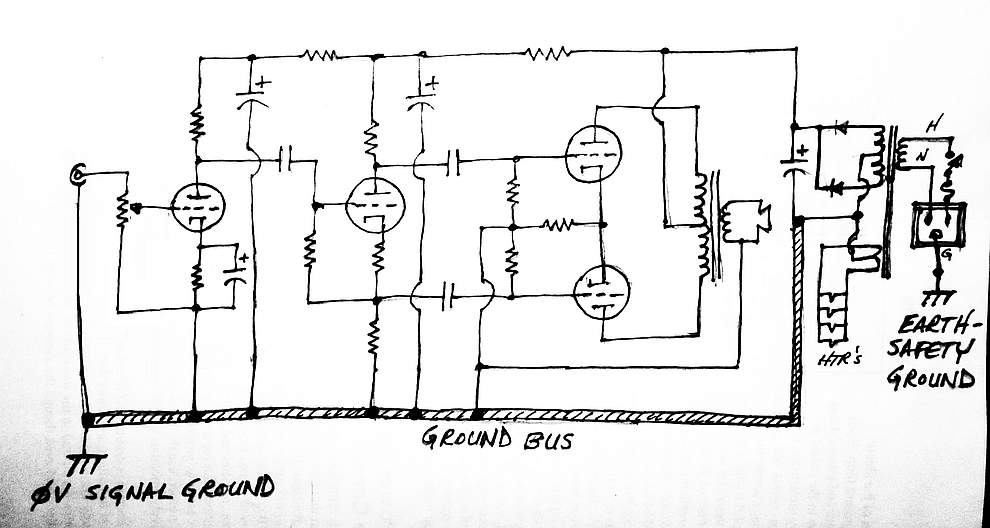

I hope you'll let me try your patience one more time...
Here's a simplified schematic of a push-pull power amp with what I think is a decent grounding scheme. Please let me know if I'm getting warmer.
Thanks.
with ref to the valvewizard, if your building a mono amp its good, however if its a stereo (multi-channel) amp post 13 should give better results.
Read and commit to memory that pdf linked in posts 29 & 31.I hope you'll let me try your patience one more time...
Thanks.
And implement the isolation of current loops. One wire/bus must NOT share currents from two, or more, different loops.
Post13 does not work.
It breaks the basic rule of LOW LOOP AREA.

For unbalanced inputs (i.e. RCA) use insulated input sockets and connect the screen side to the bus bar at the input stage end.
The screened cable uses the screen as one half of the close coupled Flow and Return Pair. The screen must stay with the core for the whole Flow and Return Route. It must not be taken as a spearate link that increases the LOOP AREA.
It's that same rule that Ruff has not got right in his point 4 in post7
The screened cable uses the screen as one half of the close coupled Flow and Return Pair. The screen must stay with the core for the whole Flow and Return Route. It must not be taken as a separate link that increases the LOOP AREA.
Who said anything about it being taken as a separate link?? The signal and screen terminate on the free RCA connector which plugs into the RCA socket on the chassis. The RCA socket is isolated from the chassis. A screened cable goes from this connector to the grid of the first tube and its screen goes to the bus close to the input tube.
I think you are suggesting the RCA socket is connected direct to the chassis and there is no connection of the screen to the bus. This is bad news because all the interference currents flowing in the chassis are now common mode at the input.
It would be helpful if, instead of keep repeating the mantra, you actually explained in practical terms what it means.
Cheers
Ian
I practically copied an illustration from Chapter 15 - Grounding (the pdf linked in posts 29 & 31).
I printed the pdf out and read it through. Then I tried to make use of what I'd just read. That resulted in the drawing I posted.
Can I ask you to show where I've gone wrong?
That is exactly the part I am not getting.
I kept the current loop created by the pwr transformer-rectifiers-reservoir cap very short and contained. (PT, C7, D1, D2) Its 'ground' joins the 0V bus in one place only.
The current loop formed by the push-pull output stage is contained next (V3, V4, R7, R8, R9, OPT, SPK), since that is the audio gain stage with the highest operating current. Its ground gets connected to the 0V bus next.
The split-load phase splitter is the next stage. (V2, R3, R4, R5, R6, C6) It connects at one point on the 0V bus. (Perhaps I should have made C6 -ve connect to exactly the same point as the grounded end of
R5?)
The input stage (V1, VR1, R1, R2, C1, C5) ground connects to the 0V bus right after the input. (Perhaps I should have connected the -ve end of C5 to the grounded ends of C1, R2 and VR1?)
The input jack is the one and only place where the 0V bus is attached to the chassis.
So what did I do wrong?
EDIT: I've updated the schematic with parts labels, so it's easier to talk about which parts belong where, etc.
