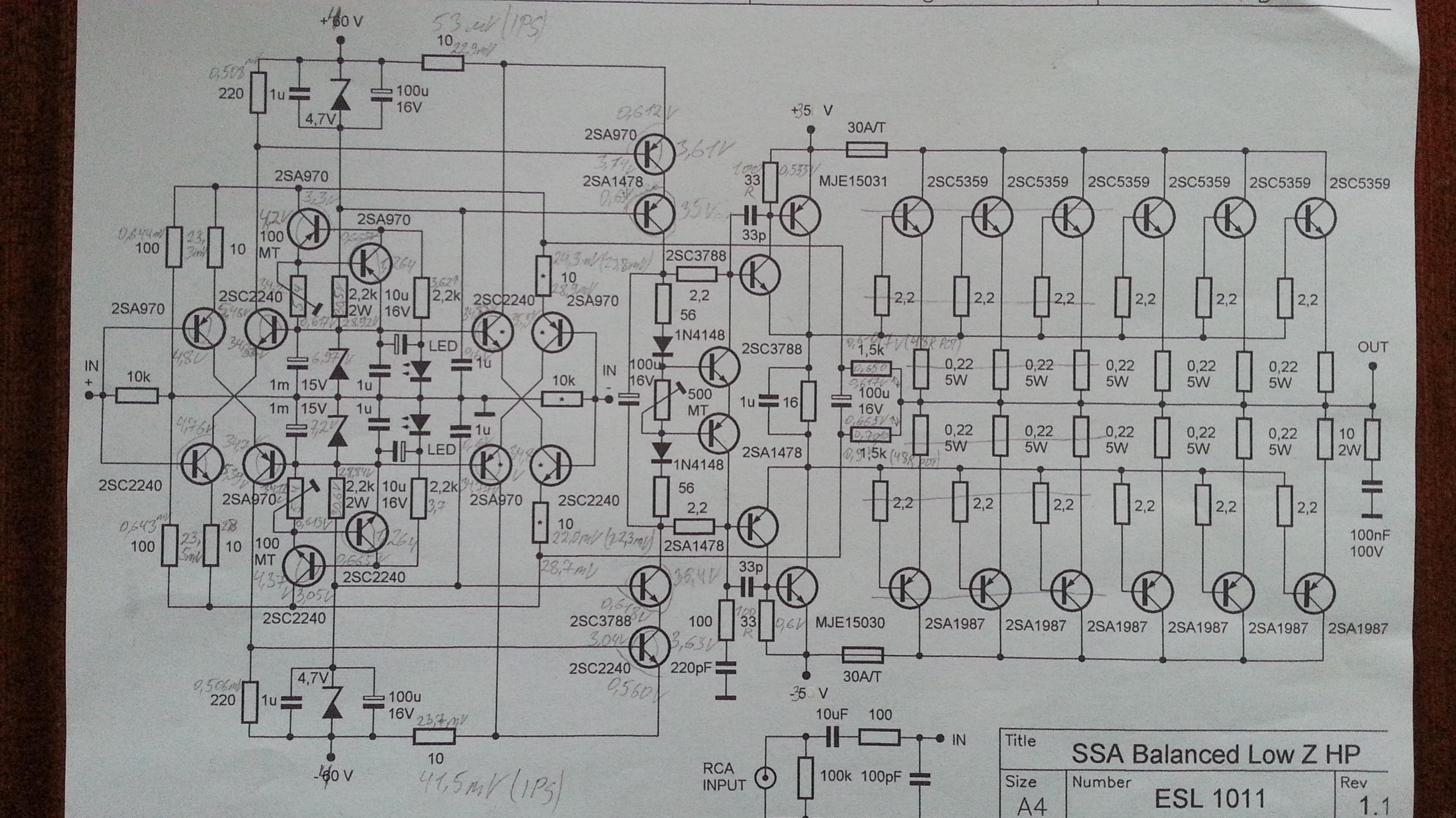

As far as I know there is only one chanel built which is defected.
Isn't here someone how is familiar with this design and could make this circuit work ih LT Spice?
I tried it with a default OPS but couldn't make it work.
It would be very helpful to make it work at least in the simulation.
Hi Andriy,
Just thought that it would be better to have a schematic with measured voltages in main points of both working and defective channels.
It would be of great help to solve the mystery.

Here is the schematic with measured potentials. Still only one channel built, sorry.
Assembled second channel - the same voltage drop on 15V zeners. Perhaps when I had 15V on those zeners the pots were set to 100Ohm - without load.
The only conclusion can be that some of my new to92 transistors are faulty or it's correct behavior for zeners with such a load. However, they are 5W types Onsemis 1N5352BRLG
Yes, reworked from Alex MM design.
Dedegogo, could you please give your thoughts on second ch. results? Schematic is through 3 posts earlier.
I think that you have more than 10mA or 20v across the 2k2. So what is causing the huge current draw?
