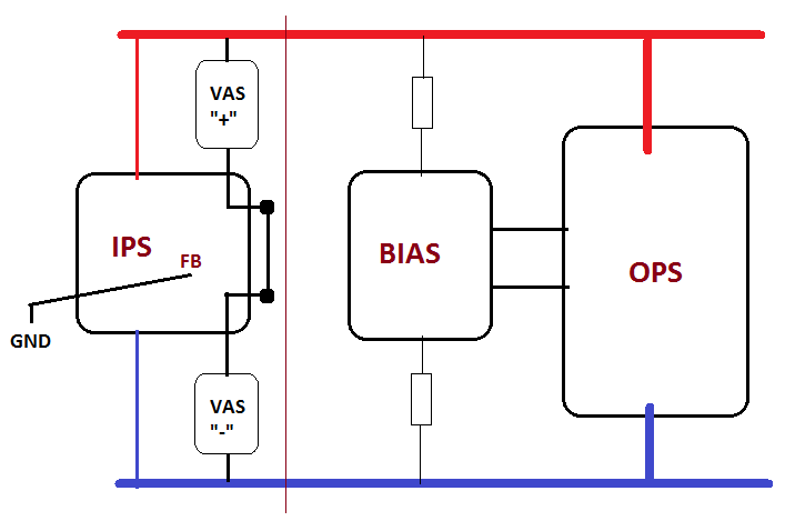

You can half the amplifier and check the IPS and the OPS separately.
The VAS (Voltage Amplification Stage) is the end of the IPS at the common
nodes between the 2SA1478/2SC3788 transistors and the 2R2 resistors.
Disconnect the collectors from everything and connect them together.
The other point is the FB (FeedBack) which you should disconnect from output
and connect it to ground. With this arrangement you can test your IPS without
the OPS (not even powered) and check the quiescent voltages and currents.
If all resistors/pots looks fine check those 15V zeners:
unsolder them and give them the same voltage with
the 2k2 resistors and check their voltages.
Likely they will be ok and one (or more) of the IPS transistors shunts them.
Please measure all the voltages on the 10R resistors which are in series
with the input transistors and also measure the V on the 220R resistors.
OPS test: instead of driving it with the 2 VAS output nodes just use two
resistors from the rails and you can check the quiescent circumstances easily.
The actual resistor values should be calculated based on the VAS current.
For example if it's 6mA and IPS rails are +/-40V, the total value should be:
80V / 6mA so 2 pieces of 6k8 should be ok.
But do not forget this Iq (quiescent current) defines the bias voltage
for the OPS so a bigger current means more Iq on the output devices!

If I understood you correctly,
I should disconnect the VAS Out points on your diagram and connect them (both collectors) together to each other, feedback point where 1.5K meets I should disconnect from Output and connect both 1.5K to GND.

How to measure VAS current to determine correct resistors to drive the OPS separately?
I've checked the IPS separately without OPS.
V drop on 1.5K was equal 0.660V on both, on 10R emitters 28.2\30.6mV, 34.4\30.5mV, they keep changing. On zeners the same - 5.3V on 15V zeners. I forgot to mention before, LEDs are dimmed, they aren't shine at full power as OPS LEDs when I powered both amp parts. When there is less V drop on 15v zeners LEDs glow more weak if bias increased. Only voltage drop changed on feedback resistors with only IPS powered, before they differ twice.
Can I check the OPS with 4.9K resistors on 2.2R and 56R points powered from the same 32V OPS supply rails? Will I still be able to tune the OPS bias currents with 500R POT?

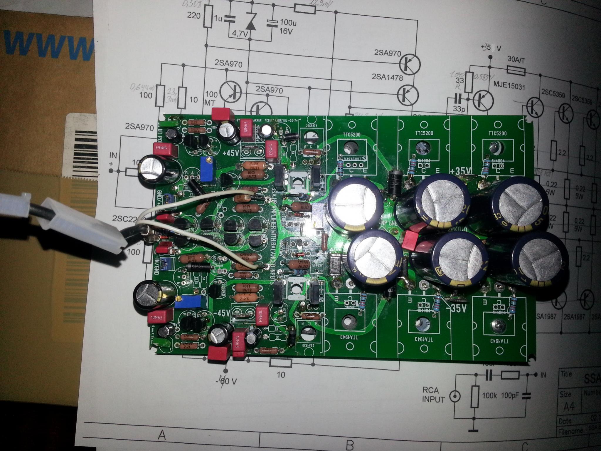

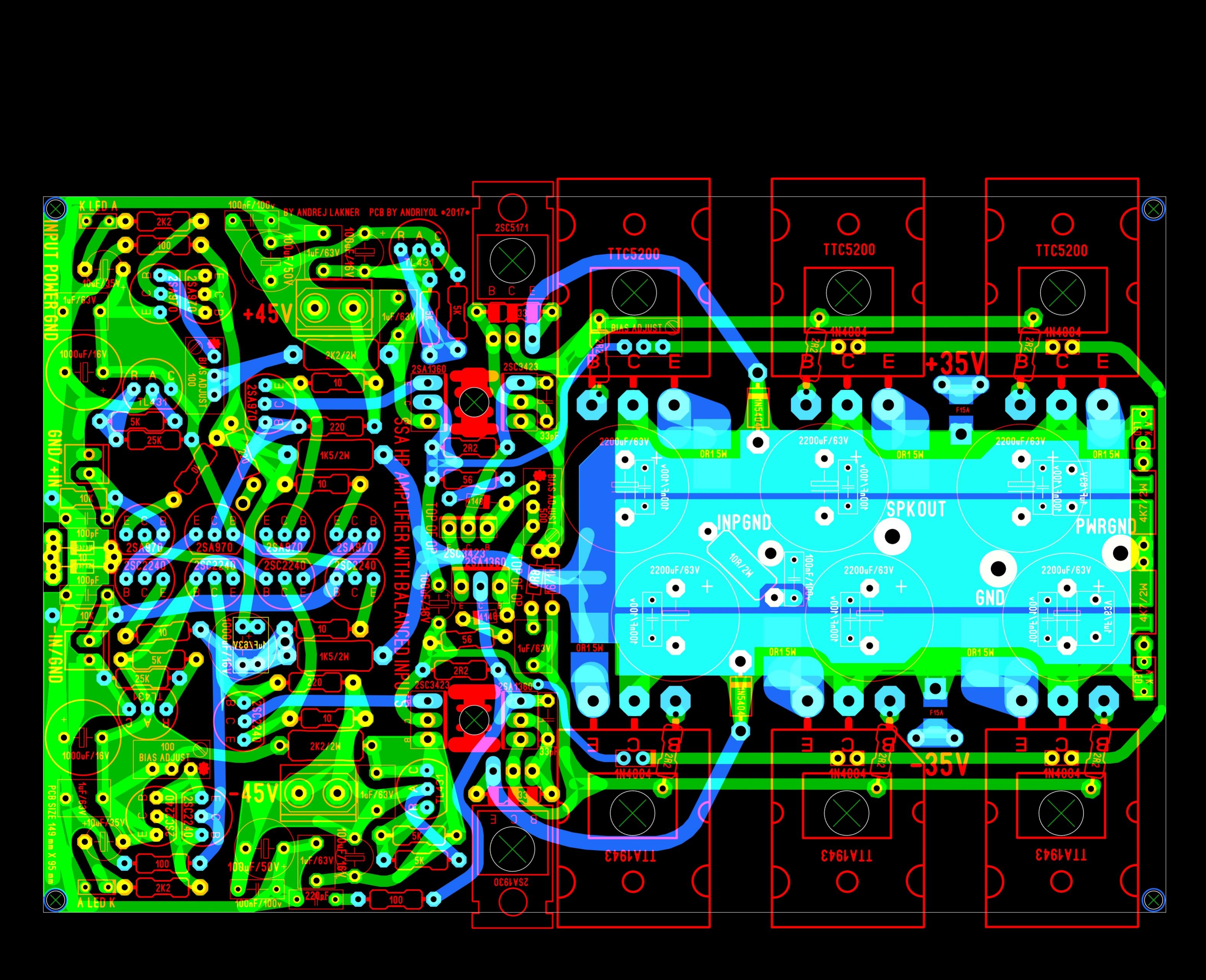

I've added the photos of layout and pcb. I know there are an errors on silkscreen for input transistors and for drivers. I have used only main components on pcb, zeners instead of TL431 by now.

Hello guys.
I've made this amplifier and after a change of bias resistors on VAS transistors I forgot to connect GND on front end part of the board when powered it on for some seconds. The components on front end have stressed 80 VDC without central point connected.
When I powered it again correctly several faults appeared: DC offset before was 10-20mV, after fault became negative 100-200mV; voltage drop on 15V Zeners only 4.8V like on 5V Zeners, however they are not damaged, I replaced them; voltage drop on 1.5K feedback resistors - 0.475 on positive side, 0.925V on negative side. On the entering points of front end voltage - 40V on both sides.
I measured all front end transistors and haven't fount any significant variations in voltage readings.
Could someone help me to find what's wrong with the amplifier?
From the schematic I use only 3 output pairs and 40/32 VDC PSUs.
