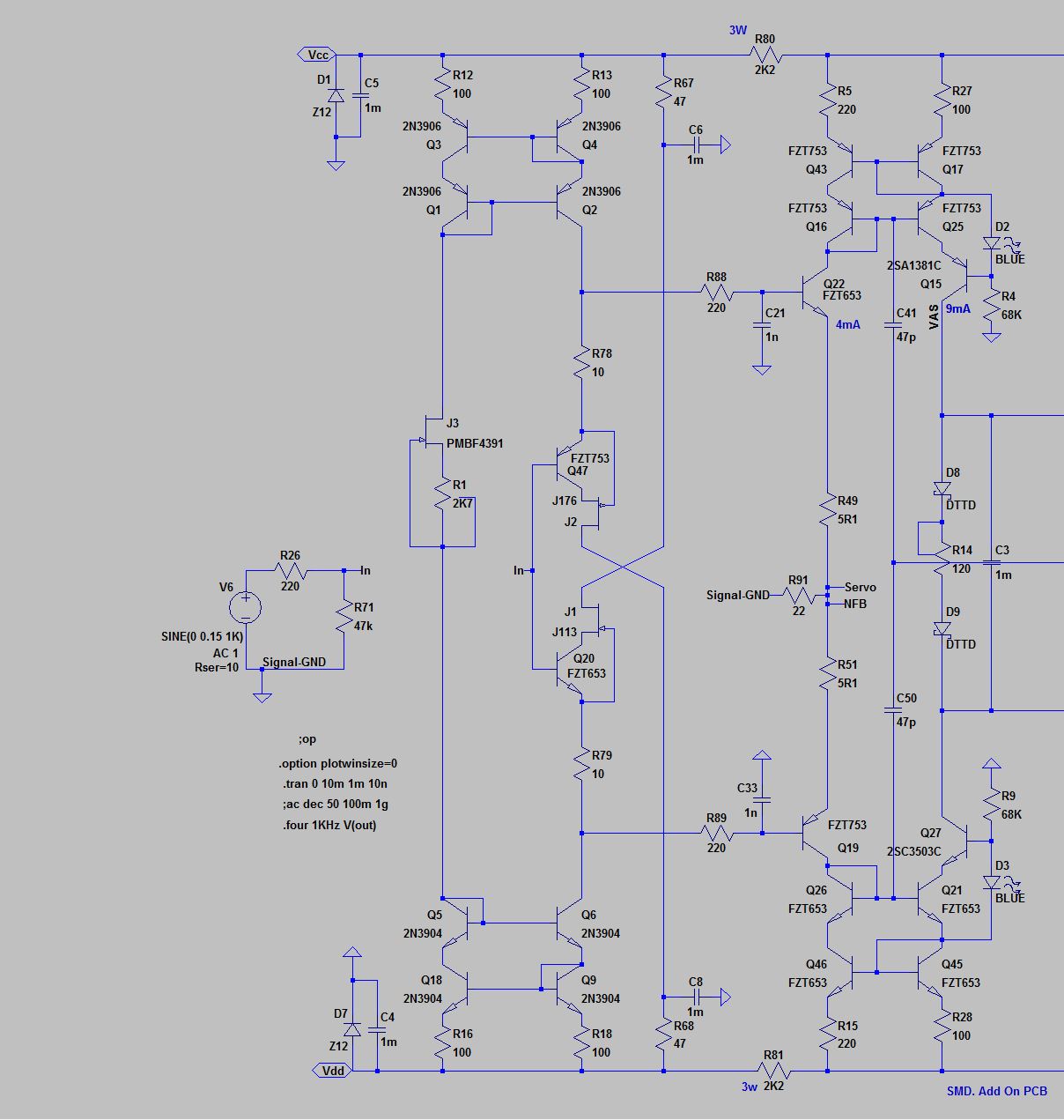

Of course, you are right... on the paper.Esperado, I belivee that CFA-s can have as good PSSR numbers as any VFA, it's just a matter of making sure that gain-componets are shielded by CCS, also currents can be mirrors to the VAS stage, that will increase PSSR and also increase openloop gain and lower distortion figures.
The problem is all the complexity you can add in a CFA (cascodes, diamonds or super pairs, CCS etc. have a direct influence on the open loop phases at HF and slew rate. I believe this is not the best way to go with a CFA.
Same remark about open loop gain. We have to find a compromise between gain and FT. I believe it is better to look for an extended bandwidth at HF , for a constant feedback ratio at least up to 10 KHz in CFAs.
Better, OMHO, fight for speed, stability, and accept decent but no overkill PSSR and HD.
And chose, (just my opinion again), VFAs or Class D where speed is not a matter, but distortions are the goal (low frequencies).
To give an image, to chose a limousine when you have long travels to do (fight for comfort designing them) and formula ones for races (fight for acceleration, speed and handling).

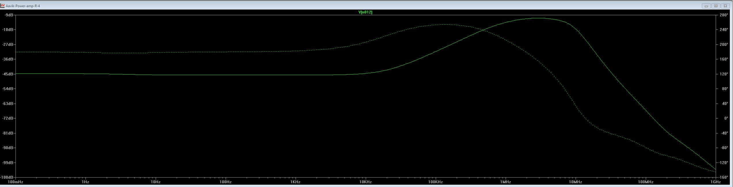

Even with this you have more than 80 degrees phase-margin (tian probe) But true the gain margin suffers a bit when you increase the gain. here its around 24 dB.
I look at it as separating voltage swing from current swing and optimizing circuit's impedance's to accomplish that. The improved PSSR is just an extra benefit.![spin :spin: :spin:](https://files.diyaudio.com/forums/images/smilies/spin.gif)

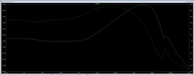

Q22 collector loopgain (with 1GH coil in Feedback)

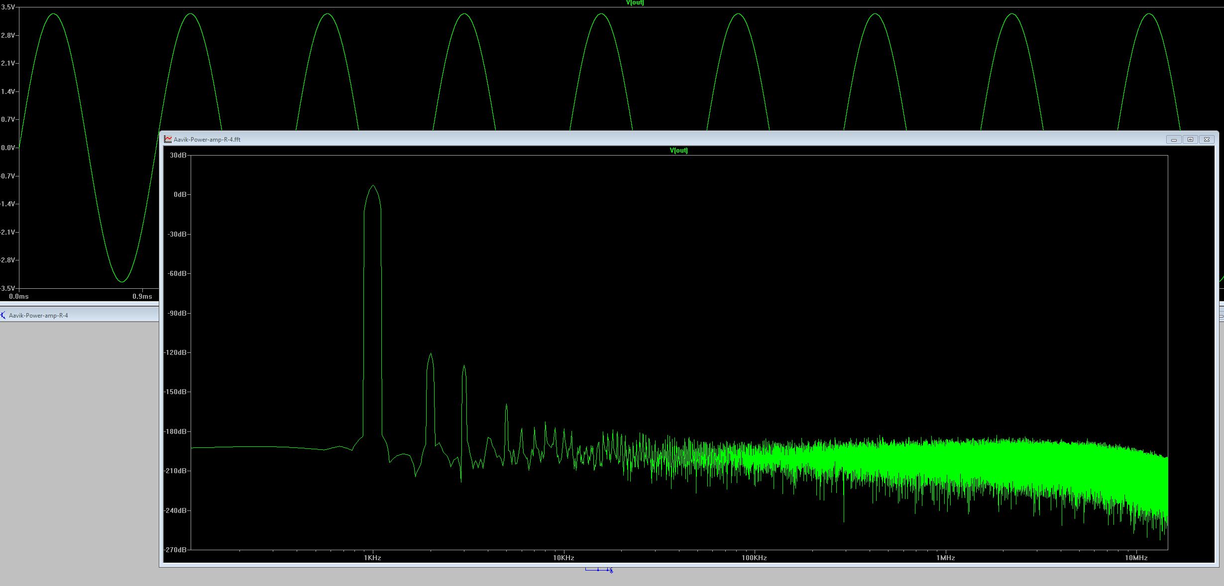

Distortion, just can't complain too much about the profile:
N-Period=1
Fourier components of V(out)
DC component:5.46251e-006
Harmonic Frequency Fourier Normalized Phase Normalized
Number [Hz] Component Component [degree] Phase [deg]
1 1.000e+03 3.339e+00 1.000e+00 -0.16° 0.00°
2 2.000e+03 1.347e-06 4.033e-07 -2.07° -1.91°
3 3.000e+03 4.862e-07 1.456e-07 89.13° 89.29°
4 4.000e+03 3.143e-10 9.414e-11 -173.34° -173.19°
5 5.000e+03 1.595e-08 4.778e-09 91.23° 91.38°
6 6.000e+03 1.264e-09 3.785e-10 46.82° 46.98°
7 7.000e+03 2.874e-09 8.608e-10 -128.96° -128.80°
8 8.000e+03 4.039e-09 1.210e-09 -51.38° -51.23°
9 9.000e+03 8.741e-10 2.618e-10 111.39° 111.54°
Total Harmonic Distortion: 0.000043%

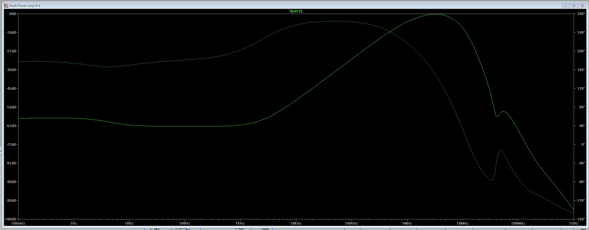

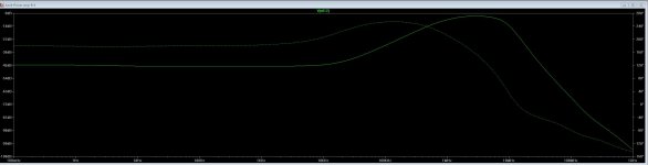

So, you can see the FC is around 2.3KHz on your, while it is 10KHz on mine.
It makes a huge difference and that demonstrate what i was talking about. ;-)
I believe than, despite higher distortion numbers, well above audibility threshold anyway, my graph has a luck to offer more coherency in the sound stage. And that, when we are about CFAs, simple is beautiful is the way.
Of course, it is just *my* opinion, based on *my* experiences, you have to make your own by listening both trials.

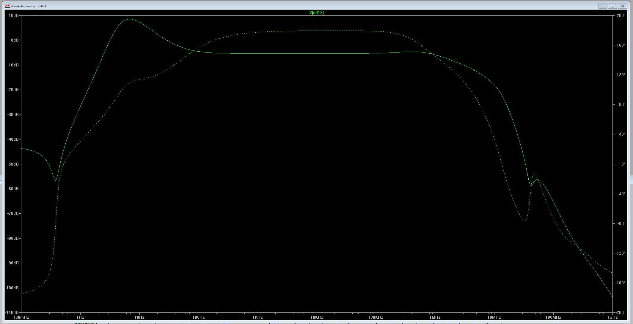

Not understood, loop-gain and feedback ratio sets the distortion,
This curve can be shaped most anyway you desire, it's not a reflection of the mirrors VS simple resistors. here the curve again, mirrors maintained VAS cascode removed. Now this is a trade-off, as the VAS cascode offers 20 dB better 20KHz distortion figures when you push the amplifier as well as 10 degrees better phase-margin, take your choices. here the corner is about 20 KHz does that make it twice as good as yours..??
I too love the simple circuits, but simple may require a better framework to perform, one clear benefit of my approach is that you can make the thermals a non issue.
