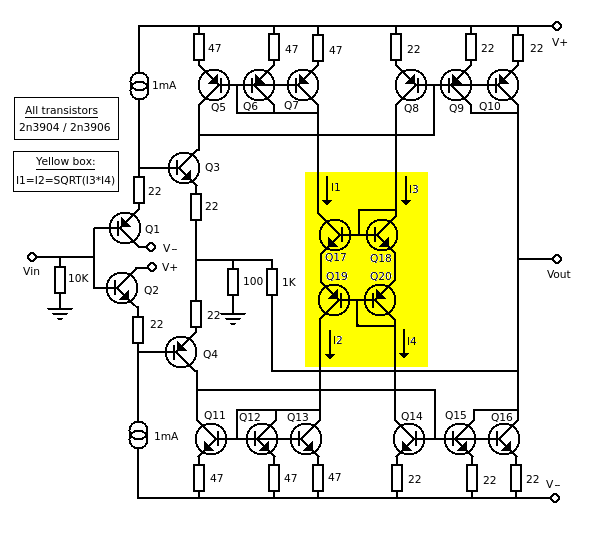

Thanks for explanation (and I agree with your reasoning). Next point: how many additional BJTs are required for a constant product CMCL?
Cheers, E.
Irritatingly, about 12, depending on the details, the way I was doing it.
The circuit below illustrates the idea. in this version, VAS current gain = hFE*2/3 and VAS quiescent current = 4 * input stage quiescent current. One could obviously rationalise the mirrors to save a few transistors. I just drew it like this, with same-value components throughout to make the mirror ratios obvious at a glance.
A number of refinements could be added but I wanted to keep this as simple as possible because:
a) Simple = easy to understand
b) I drew it manually with a paint program, which was even more painstaking and time-consuming than I expected.
Similarly, I didn't bother adding an output stage. The VAS drives the output and feedback network directly. This does demonstrate the current-on demand nature of the VAS quite nicely though.
The one I was fiddling with in the sim was a bit different. It had VAS current gain = hFE and a few extra resistors in the yellow box which allow it's gain to be set to the desired value, even with mismatched transistors. Note that emitter resistors can't be used with the transistors in the yellow box as it relies on the exponential Ic/Vbe relationship to work properly.

Your point about current on demand is a good one. In a CFA, when the demanded current from the input stage exceeds twice the idle current, I think the "other" side of the input stage cuts off and delivers no more transconductance if I am not mistaken.
Thanks. For designs that want to exploit the current-on-demand property, the emitter resistors of the input devices can be chosen so that the transconductance of one device risesas the other falls, so the total transconductance remains almost constant. It's the same basic mechanism as a typical class AB output stage, so one can use similar analyses e.g. Doug Self's "birdwing" diagrams.
If you mirror and scale the current into the VAS then you get the current on demand property in that section too.
Not quite sure what you meant there, but I agree that if the VAS has a constant, linear current gain, then the current on demand property carries over from the input stage to the VAS. Only trouble is that the VAS gain is normally low (3 in your circuit, if I followed it right). I really must get hold of Bob's book and find out what his "magic trick" is.

Why do you think that the bias circuit is made with an Reference (LM431 series) instead of a resistor or bias cicuit with transistors? A step of 12 to around 15mA is a lot to handle with an standard bias circuit Even with an CFP pair as bias it is hard to get a stable bias within a lets say 10mV (10mV/(0.2R*2) => 25mA/transistor rail in change with an RE of 0.2R )
- Sonny
If you mirror and scale the current into the VAS then you get the current on demand property in that section too. That also have the benefit that you have means of controlling the VAS current better as it can thermally compensated in the driving CCS.
Without actually discussing it, Michael and I use the exact same principle to control the VAS current.
It is the one and only way to do it, as I see it. You no longer have the problem with rising current (or falling VBE voltage 2.3mV/degrees) as a function of rising temperature in the VAS transistor.
This way you get just as stable VAS idle current as in the blameless design of D.Self... In d. self design is the current controlled by a current sink/source at the opposite rail.
- Sonny
