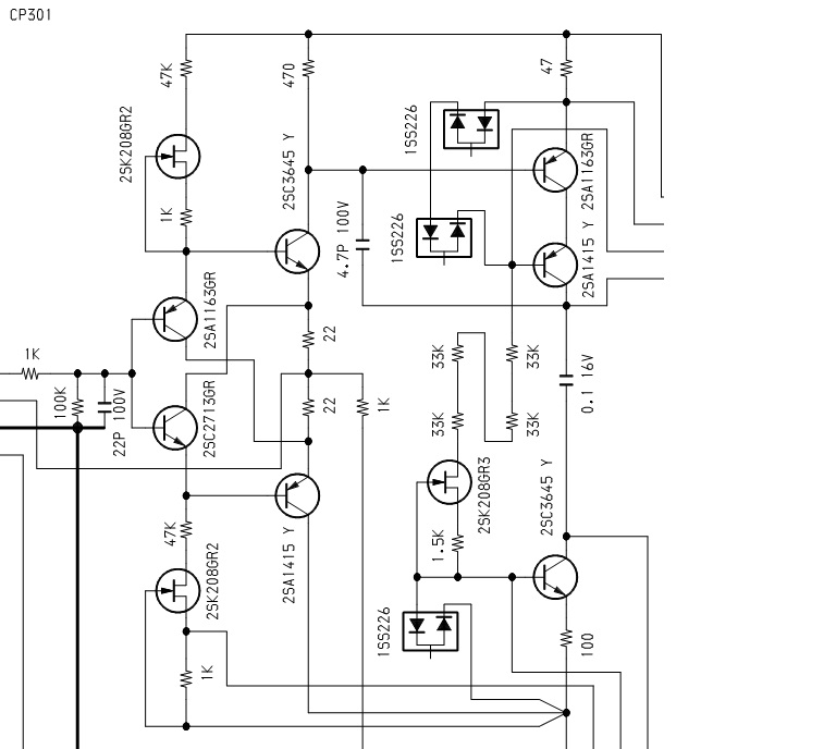

As some object to the use of symmetrical CFA I ll post an example of a commercial unsymmetrical CFA using diamond buffer. Unsymmetrical CFA does not neccessarily mean it has to use a single input transistor topology with emitter feedback. This is the inputstage of a 400w amp by well known and respected japanese manufacturer.
Is this a bridge amp? If so, the whole circuit may be symmetrical. Why did you cut off the interesting parts??
Jan
No, the symmetrical parts some seem to be against is the vas for whatever reason. Current mirrors can be used to obtain better symmetry in the diamond as its only loaded on one side. It has fet drivers driving 5 pairs of vertical fets per channel and wheighs in at 70kg.
I posted it because of a discussion I had with bigun who I think didnt quite understand the concept I was explaining to him.
I didnt post the whole circuit as I dont fancy having my nether parts kicked by the manufacturer in case he prohibited it. :D
