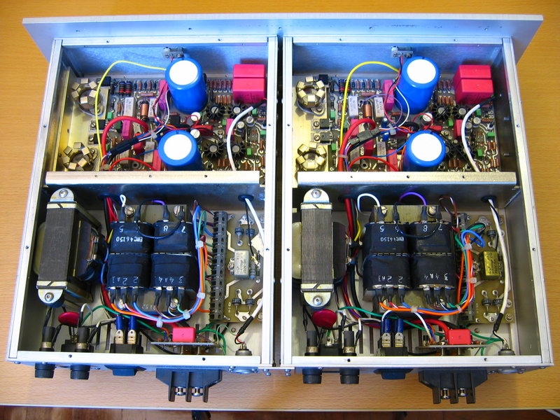

A few comments
This product developed from the original Performance amplifier. The circuit shown was the input and driver stage for that amp. Output stage used 20 outputs per channel. Input / driver stage sounded so good that Cello introduced it as a separate product.

Attached image is a pcb copied from a Cello Encore power amp:
Do you have another side image?
- Cello Encore 20th Anniversary Edition
