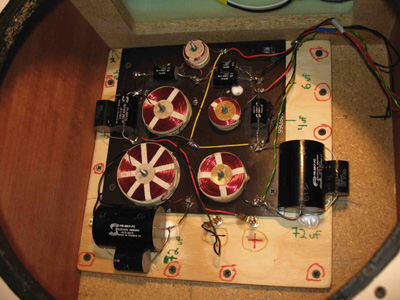

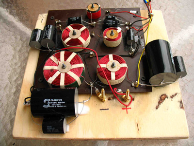

I wonder if Celestion was sort of "cascade bypassing" here at the bottom of the board, mounting a little 6uf 50v on top of the larger 24uf 25v cap.....or just simply assembling a 30uf total?
----> Years ago no manufactures gave any thought to this Cascading idea, and most don't today either, perhaps only a few of the very high priced brands, or highest priced models from a manufacturer of several price/quality ranges.

the paper-in-oil caps
Yes, you can use those caps together in a parallel bundle.
I will describe how you can attempt to re-condition them to hopefully reduce their leakage if you want to ... ?
Then use new poly caps in the other location in the treble filter, and those will prevent any DC offset from your amp from leaking through the older caps to the tweeters.

Re: clarification about caps' usages, and more about Voltages
Seems I've misread something, as I can't see any 25volt rated caps on your list sba, but this information can stay posted in case any other readers have 25volt rated caps in their cross-overs !
25 volts could be exceeded in bass, and some types of mid-range, filters because capacitive reactance is higher at lower frequencies, and thus larger voltages will appear across the caps because there are almost always larger Signal voltages present in Music at bass and midrange frequencies than at treble frequencies.

You're correct....three of my speakers have 25 volt caps (the midrange 24uf red-colored CCL caps).

After examining the original crossover location behind the woofer, I felt that there would be insufficient room for a modified board with larger caps at that location. But there's enough room lower down, behind the ABR. The original speaker posts (worthless actually--accept max 20 gauge wire--I always cursed when trying to attach wire to those posts) and their small 3"x4" mounting board must first be removed. They can be removed by hammering the boards into the cabinet from the outside, and then chiseling off any glue on the inside in order to make the surface smooth.
And here’s my recipe for a modified crossover board, which places the original board on top of a larger piece of plywood:
Cut an 11"x11" by 1/2" thick plywood board, which, following the above mentioned removal procedure, will sit flushly against the back of the cabinet and should be placed snugly into the upper left hand corner of the ABR compartment. (The back of the new plywood board should be painted; hence, my full paint job on the back of the cabinet.) Install some new speaker posts directly into the new plywood board (but slightly below the original locations). To accommodate both the speaker posts and the installation of the large 72uf caps, rotate the original crossover board 90 degrees to the right, and screw it into the plywood, using some spacers to float the board slightly above the plywood. The original board should be placed flush with the top of the new plywood, should have about 1” of plywood margin on the left, and should have larger plywood margins on the bottom and right. Fit the caps into place (the larger caps will sit on the plywood margins), secure the caps with with an adhesive (such as RTV silicone, or some other thick & tacky adhesive). When the adhesive is dry, solder the connections. Install the new board into the cabinet using 1” wood screws
This setup also necessitates soldering longer wires to all the drivers.

Due to time constraints, I'm going to install poly caps throughout the crossovers...though I think it would be fun to try the PIO cap rejuvenation experiment....maybe another time.
A lot of other stuff has been eating away at the available hours for this project. In order to get all four speakers looking similar, the fronts received a coat of primer and two coats of beige paint. ( So now I guess all four speakers can be called blondies.) Prior to that, the vertical, recessed channels for the grilles had to be cleared of deteriorating foam tape and adhesive, and then painted with black latex paint. And the grilles, once stripped of fabric and glue, were also painted with black latex paint. Scratches on the cabinets were also touched-up. Finally, because of the crossover modification, the back of the cabinets ended up with 2 coats of brown latex paint.
I’ll be out of town for a while; but, when I return, I'll post some photos. I’ll have more questions for you, too. I'll also try to get one pair of crossovers installed and hear how they sound.

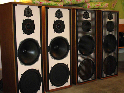

Hi everyone,
Well...the speakers sound very good with the new poly caps installed, and it really seems to bring out both the good and the bad in the recordings. My mediocre recordings sound even more mediocre; while those recordings that were well-made and engineered, sound more detailed and impressive. Overall, it's a wonderful improvement, and I really have to thank Alan for recommending the cap replacement, and then leading me through it.
One thing that I wish I hadn't done previously, was to compress a small portion of my itunes music library files beyond the "lossless" level. I don't recall noticing any difference when I did those compressions, but the differences (compared to the original cds) are apparent now--probably because of the crossover improvements, and because I'm listening critically now, and at a louder levels than before (I'm more confident in pushing the speakers, knowing that the cap replacement has brought the crossovers very close to spec).
I've also discovered in all this that my 40gb ipod--though I rarely use it indoors (it's primarily for the car)-- is a poorer sounding music source than the sound card attached to my laptop. (Same exact music files on both...it must be something about the DACs.)
