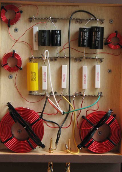

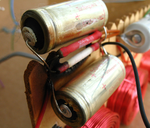

Fitting Caps on the boards ...
Grahame said:
sba,
now those are BIG caps!
Too Big ...
That is a very nice looking job you have done sba with your extended size cross-over boards, and has given you plenty of space to work on.
If one uses 250 volt caps instead of 400 volt size, then one does not need as much space, and likely not need extensions to the boards if one chooses suitable cap values to connect in parallel for the 72uFs.
Why I say that :-
There seem to be at least 3 different versions of the 66:-
- the original using the hardwired x-over board as shown in sba's earlier photos of his "blackie" boards {Post #'s 96 and 97 on Page 4}, and component values for the earlier drivers' part numbers,
- the interim version which still uses the hardwired boards, as shown in sba's photos of his "woodie" boards{Post #'s 98 and 99}, but with some changed cap values, and the second series drivers' part numbers,
-the later version, which Grahame and tonedef2 own, which have the printed circuit boards {Post # 47 on Page 2}, and the second series drivers' part numbers.
These pcb versions have a different layout for some of the components and physically large caps will not fit in at least one of the locations they would on the hard wired boards.
Some readers may not want to build extended boards, thus I will list some smaller size options for the 72uF caps, but first -
How much space is there between those two inductors on the Mk II pcb where the 72uF cap is ?
Please some-one measure the width available - in inches or mm - and Post, and I will allow some space for clearance so the caps are not stuck tightly between the inductors.
There seems sufficient space for the other 72uF cap to be wider, and also for the 24uF cap to be a little wider without being off the edge of the board {on the Mk II pcb version}.
There looks to be sufficient space for all 3 of those caps to be a bit longer, though it would be preferable for them too not be so long as to require their leads to have to be bent back under the caps to fit through the pcb holes, thus -
please will some-one measure and Post the distance between the pcb holes - in inches or mm - for each of the 72uF caps and for the 24uF cap.
For the tweeter section caps, new ones can be placed diagonally to allow for some greater length as there are at least 2 sets of pcb hole for each cap parallel combination.

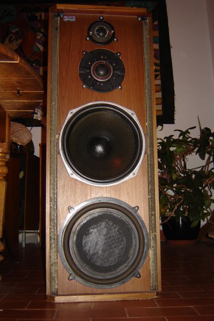

Hello to all the Ditton lovers!
Very interesting thread!
I'll have a few questions especially for Tonedef2, but first here is my story.

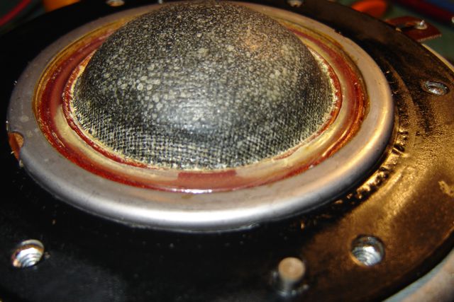

I've been lucky few months ago to buy a pair of Ditton 66. I bought them cheap because one mid-range driver was destroyed.
These are from 1976 and of the "woody type" with the large dust cap and an hard-wired X-over similar of the Grahame's one (see post #34). I re-caped it with MKP caps from SCR.

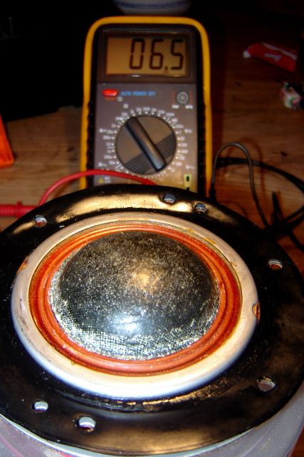

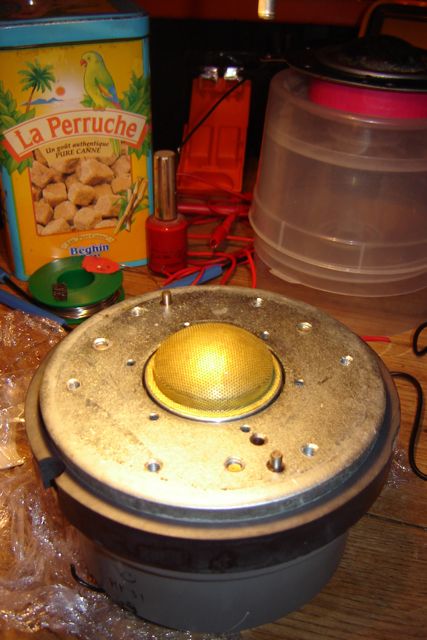

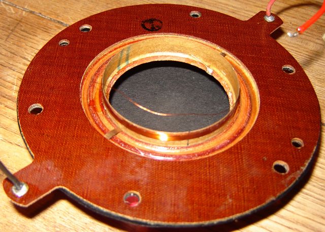

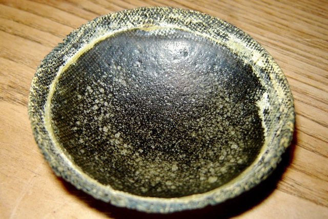

Before trying to buy a new I tried to restore the faulty mid.

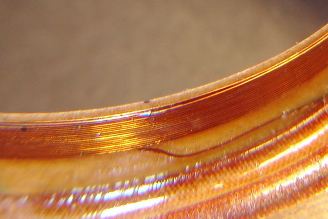

The dome was completely unglued from its suspension and worst the wire of speaker coil was broken (as you can see on the photos in the next posts). I think the previous owner powered them after some period of storage, without noticing that the cone was unglued.
I re-glued the dome using a vinylic glue, and using a big magnifying glass and a lot of patience I soldered the broken wire.
Good news the sound of the repaired mid is for me almost undistinguishable from the other one. I said almost because on some very few tracks, featuring vibraphone or piano recorded with a lot of dynamic, I can hear a little buzzing from the mid. Too bad I like Milt Jakson very much....
I read the whole thread and I've been very interested by Tonedef2 MD-500 restoration, too bad I haven't found this thread earlier.
TONEDEF2: I have finished an extensive restoration of the MD 500 dome mids, won’t go into detail sep to say it involved complete disassemble, custom jig, removal of all old glues & about 18hrs of labor, they have a strange 2 piece arrangement that will result in all the MD500’s buzzing and or low output. Results? I see why theses mids where popular in the studio! Beautiful voice repro now!
This process is not for the faint of hart my custom jig was trial and error...my large 7 inch mag/light was a must have....
For one example, material had to be trimmed as over time it had stretched; very scary work as there is a cancellation dome with little margin right behind the second dome stage.
Tonedef can you tell us more about this "strange 2 piece arrangement that will result in all the MD500’s buzzing and or low output" and about the material that had to be trimmed as over time it had stretched? It would be very helpful. I'd like to know also which glue you've used.
Thanks a lot!

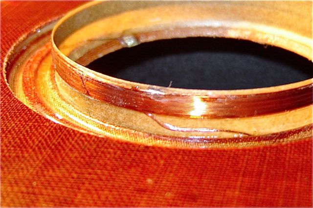

the mysterious MD500's "rubber band"

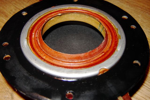

From previous posts:
(quote from rwtomkins) >
(I also have a question on the mid-range speakers, which after all is where this thread started. When I got my 66s one of the mid-range units had what looked like a rubber band lying unattached to anything behind the speaker's little metal grill. I was afraid to touch these units so I gave them to Wilmslow Audio to have a look at. They said they'd put the ring back in place but on checking the other unit they'd found it was completely absent - but not to worry about it because it didn't seem to make any difference.)
Answer to rwtomkins> Was it black or white-ish? wide? Even? Please read my other post regarding our MD500'S…..I believe they have mis-informed you…..see my other posts, not may folks have seen how these where built, it is different!
As you can see on the picture the "rubber band" (if I understand well what rwtomkins mean) from my other MD-500 is starting to come apart the suspension (white parts on the edge of the ring). I' had to remove it from the one I repaired as it was partly detached already.
Should I replace it with some special glue? Indeed to me it looks more like glue than rubber.
What do you think?

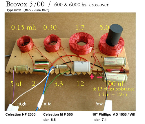

At my local resale shop I found a pair of Beovox 5700s containing Celestion MF-500 mids--which I'll hold for spares. The DCRs are okay, but I have yet to do a listening test as my 66's are in storage until March when the weather warms and the listening room is once again above freezing and habitable. So I'm not able to check the "T" numbers on my mids, but I know that the earlier blackies are mF-500s, and the later woodies are mD-500s.
The rest of the Beovox 5700s were in very bad shape.....the cabinets were trashed, the 10" Phillips woofers needed new dust caps, the Celestion HF-2000 tweeters were toasted, and the crossover boards and some large caps suffered serious burns from overheated resistors. The problems were the same on both boards.....resistors burned away part of the board, and destroyed nearby 50uf caps. Those caps were very low voltage, too (35v). And thinking of the formula that Alan posted earlier, 35 volts is cutting it close there.
I'll post a photo of the Beovox crossover. Notice that instead of the Ditton's 500 & 5000 hz crossing, the Beovox crosses at 600 & 6000 hz.
Also from the resale shop-- I really should stay away from there -- were two pairs of 1970s JBLs (10" two-ways & 10" three-ways) that made it into my car and became my winter project. This will include new foam surrounds on the woofers; all new crossovers based on recent driver measurements and crossover designs done by a guy in Denmark; new dampening materials; and, eventually, new finishes on the cabinets.
Using all new boards, coils, caps, and resistors, I have just finished (after experimenting with three different layouts) building the crossovers for the pair of JBL two-ways. And this led me to re-think my earlier rebuilds of the Ditton crossovers.
For those who have the older point-to-point boards (where the coils can be easily removed by undoing the machine screws); and perhaps for those who are having difficulty with the newer PCB boards (which I have not studied); and also assuming that one wants some flexibility for future modifications, I would recommend that a 66 rebuild be made on a new board....using your existing reclaimed coils, some new soldering strips (via ebay), new caps of your choice, and a flexible layout (similar to that seen on my JBL board), which will allow for easy (or easier) cap changes, and the addition of resistors. There's about three inches of space between the soldering strips on the new boards, which allows for most sizes of caps and resistors, and allows for easy bridging and connection.
Had I originally done such a layout for my 66 rebuilds, it would be a cinch to go back now and add the three resistors that Alan recommends.
More later...
