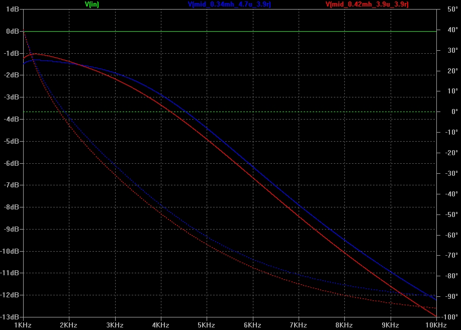

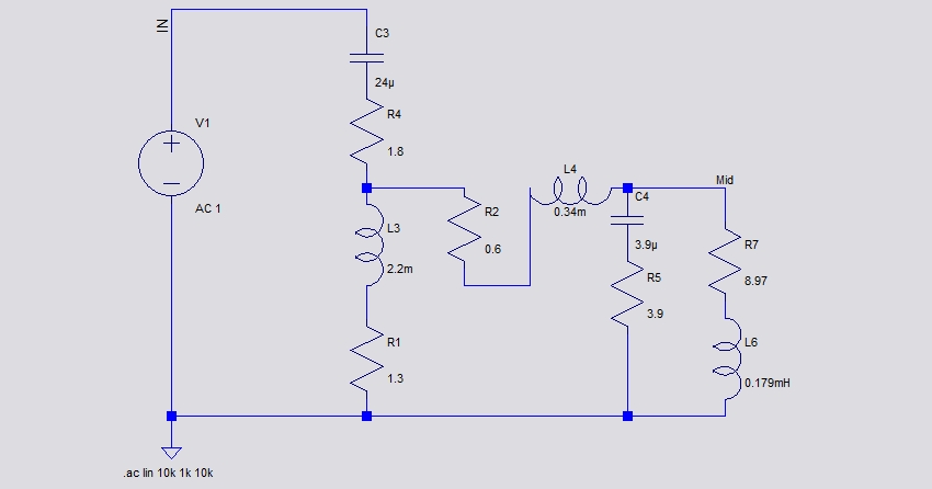

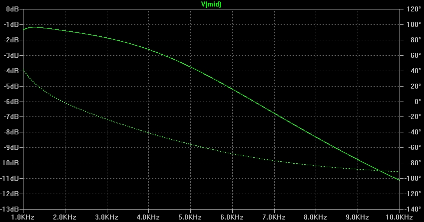

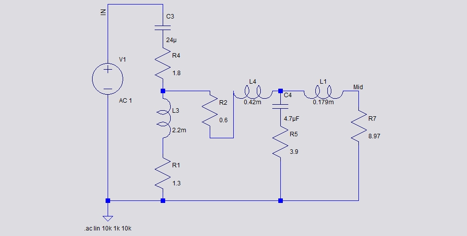

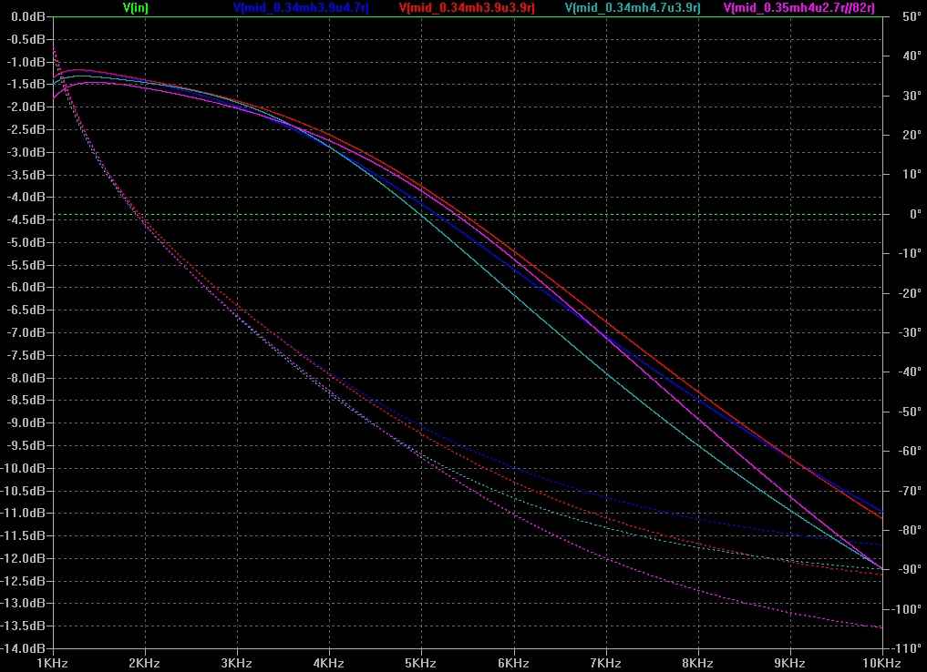

I've had a go with the LTSpice software to produce the plots 2 and 3 as per post 952 in this thread.
Unless I am intepreting the design incorrectly plot 1 will be a line at 0db. I don't know yet how to combine the plots so plots 2 & 3 are on separate charts. The circuits used to generate the plots are included. I've used separate components in the circuits for clarity. Can these be further refined?

G'day Denny ,
Great stuff !
Both circuits as you have drawn and used are correct.

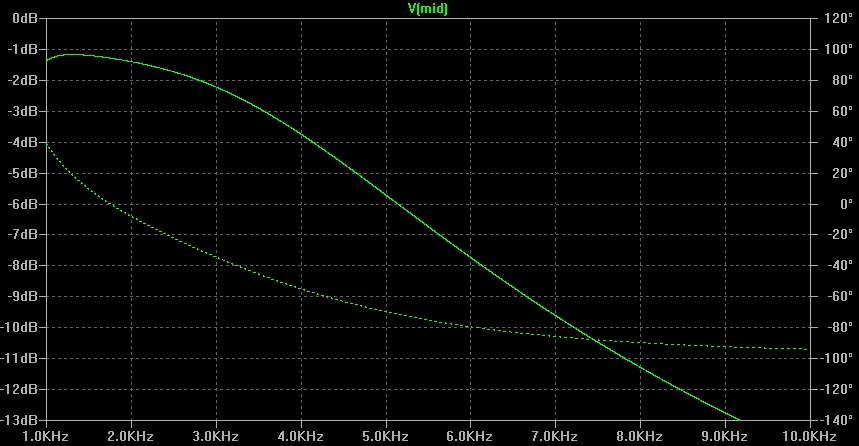

About the plots:
Likely the 0dB line is for a no filter prediction.
To test that , take out the 1.8 ohm resistor from the Input to the filter , and have no resistor there ,
unless your program requires a resistor with that capacitor , and if it does then put 0.10 ohm there.
Try the above with the 0.34mH + 3.9uF + 3.9 ohm circuit.
We can then see the action of the 1.8 ohm resistor.
The .34mH + 3.9uF + 3.9 ohm circuit simulation prediction for 5kHz is very close to what I have all along hoped for following my own estimations.
To try an alternate which will show us further , please do a simulation with 3.9uF + 2.7 ohms there ,
and with the 1.8 ohms in at the Input so that we can compare the new simulation directly to the original with the 1.8 ohms in.

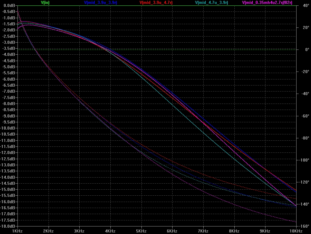

Looking for the Optimum resistance
Great stuff Denny !
First we see that the 1.8 ohm input resistor attenuates the signal by a fraction more than 1dB ,
thus I think it likely that when the lower DCR inductors are used in the woofer filter this 1.8 ohm resistor will not be needed in the midsrange filter.
The resistor in Series with the 3.9uF capacitor will still be needed , because that resistor reduces Resonance.
See in the 2.7 ohm versus 3.9 ohm plots:
Normally one would expect that when less Impedance , 3.9uF + 2.7 ohm , in Parallel with the driver ,
the Series inductor , 3.4mH , would filter more of the treble off ,
but here we see the 3.9uF + 2.7 ohms filters less , and the 3.9uF + 3.9 ohm filters more ...
See the wide , banana shaped area between the 2.7 ohm and 3.9 ohm plots.
That shows the broad-band resonance caused by the 3.9uF cap resonating with the .179mH inductance of the driver's voice-coil
- broad-band because the 8.97 ohm of the driver's voice-coil has reduced the Q of the resonance
-{ but plays the resonance out through the dome to the listener }.
The 3.9 ohms reduces that Q further , more so than 2.7 ohms , { and both reduce the resonance before it can be played by the dome }.
One might then think that the larger Resistance in Series with the 3.9uF cap the more the Q of the resonance is damped ... yes ...
BUT , when the Resistance there gets too large the Impedance of that Parallel arm will be high enough to reduce the amount of filtering the 3.4mH inductor can do.
What is the optimum resistance for that arm to reduce the Q of the resonance but not reduce the filtering off of the treble above the crossover point ?
From those two plots we can only conclude that the optimum is larger than 2.7 ohms ,
and that 3.9 ohms is closer to the optimum than 2.7 .
Let us try to zoom in on the optimum , but with regard to the limited resistance values readily available in 5 watts.
{ 4.3 ohms in 5 watts is only available from one seller.}
Denny , please plot two more for comparison.
Have the 1.8 ohms input in the circuit.
Use 3.4mH for the inductor and 3.9uF for the capacitor , so as to be the same as for the 2.7 and 3.9 ohms circuits ,
but plot with 3.3 ohms and 4.7 ohms as alternates for the resistor ,
because I do not know which side of 3.9 will be the optimum resistance.
The optimum resistance may be larger than 4.7 ohms , such as 5.1 or 5.6 , 6.2 , 6.8 even ,
but 7.5 or 8.2 is unlikely because when it gets close to the 8.97 ohm effective resistance of the driver's voice-coil the effect of the filter will be less.
If you don't get a maximum filtering with 3.3 ohms , then try some values larger than 4.7 , but only if 4.7 filters more than 3.9 did.

This is a plot for the mid range circuit with a range of resistances from 2.7 to 8.2:

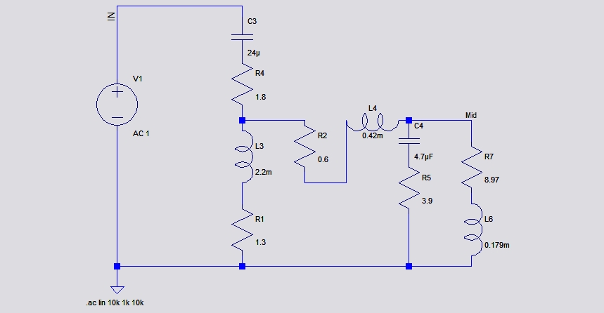

Just for the record the basic circuit for the LTSpice model is the first circuit in post #1006 (circuitforplot2.jpg). Note I'm using 0.34mH in series with the mid unit not 3.4mH as you have written (L4).
other useful variations for the circuit
Good one Denny ,
you have spotted my mistake:- 3.4 instead of .34mH - thankyou for identifying that !
Interesting results , and I was about to post that it may not be possible for the LTSpice to correctly model exactly what happens in a real-time Reactive circuit ,
but then I remembered a related matter applicable to that type of circuit which I had forgotten ... despite having used it once myself !!
Taking the above into account , all interested readers note in Denny's plots that for resistances larger than 4.7 ohm the Right end of the plot starts to curve upwards , that is lessens its downward bend.
This indicates the resistor is no longer contributing much to reducing the resonance of the output ,
but has now in combination with the 3.9uF cap effectively becoming a Zobel circuit opposing the Inductive Reactance of the mid-driver
and reducing the Load seen by the .34mH inductor to closer to resistive ,
and in particular somewhat lower resistive than Celestion intended for this filter.
As result of the Zobel action and the reduced Load the filter sees , the crossover point has been lowered in frequency , successively for each resistance larger than the 4.7 ohm shown.
As the 4.7 ohm plot is mostly so close to a straight line sloping downwards , there is effectively no resonance in the upper midrange.

Thus , if this is interesting to you Denny , please plot the following:
Keep the 1.8 ohm input resistor and the 3.9 ohm output resistor in circuit , and keep all else , and change only as follows:
One circuit: use 0.34mH with 4.7uF as the output capacitor.
Other circuit: use 0.42mH , with 3.9uF as the output capacitor
{ and that includes the 3.9 ohm resistor for both circuits }.

LTSpice plots , + interim to Reggie
Interesting results Denny ...
First I will remind readers of my initial statement about this LTSpice simulation - that is it is only accurate at 5kHz ,
because below 5kHz the driver's Inductance is larger and its Resistance is smaller ,
and above 5kHz the driver's Inductance is smaller and its Resistance is larger.
As result of the above , the slopes of the 2 plots Denny has above will not be Parallel when measured with an MD or MF 500 mid-dome ,
however the difference will be as shown at the 5kHz point.
In reality with a mid-dome the result with .42mH + 3.9uF will be a slightly gentler slope ,
and the result with .34mH + 4.7uF will be a slightly steeper slope.
What the LTSpice result does demonstrate is that 0.42mH is too much inductance for even the possibly most deteriorated peaky sample of a Celestion 500 dome.
At most I think a standard available 0.39mH inductor would be sufficient for such.
The 0.34mH + 4.7uF result will be useful for 500 domes that may be sagging a little in output at and below 5kHz and breaking up at frequencies higher than 5kHz.
Denny ,
so that we can clearly compare the 2 most useful modification circuits ,
please post a File with these 2 together , because each is on a separate page in this thread , so a comparison plots' file will be useful for:
0.34mH + 3.9uF + 4.7 ohm
0.34mH + 4.7uF + 3.9 ohm
If you want to see the differences between those and the circuit I have recommended in the past ,
and if you can get 3 colours to work in the File as before ,
then include the 0.34mH + 3.9uF + 3.9 ohm circuit also.
Include the 1.8 ohm input resistor with all 3 circuits.

replies to 1015 , 1016 , and alternate LTSpice plots to try
Thankyou Denny ...
For the Celestion original and the 2 modification circuits the variations can be clearly seen , and those can be applied to variations in samples of the mid-domes -
- see Page 50 , #499 , for the variations between sba's 4 samples.
Very interesting is your particular modified circuit , where the presence of the Parallel connected 82 ohm resistor has removed the resonance that 2.7 ohm allowed ,
and increases the phase angle of the filter , which will change the output level where the mid-dome and tweeter add ,
-{ which seems to be a little above 5kHz , perhaps closer to 6kHz from some of sba's other plots }.
Thus you have evidence now of the effect you heard !
{ the audible difference lower in the midrange around the 500 Hz crossover point is not shown , and we'd have to change some things to show that }.
{ The slightly larger components at .35mH and 4.0uF caused the slightly lower output at 5kHz than the Reference .39 + 3.9 plot ,
and actually it is a slightly lower effective crossover frequency with the .35 + 4.0 .}

To show better what is actually occuring at 5kHz let us now include the driver's voice-coil Inductance in the filter ,
and measure the output across the voice-coil's Resistance only.
Denny ,
use the same circuit components as before to as far as your numbered L4 , and change as follows:
L4 ; C4 + R5 ; L6 at 0.179mH , draw as a T shaped output filter ,
that is with each L at either side of the top of the T , and C4 + R5 as the leg of the T.
R7 , at 8.97 ohm , is now to be the Output.
Thus configure your LTSpice to measure across R7 only.
Draw that circuit and post it here so that I can be sure you have it correct.
Plot as follows the same 3 as your previous above with:
3.9uf + 3.9 ohm ; 3.9uF + 4.7 ohm ; 4.7uF + 3.9 ohm , all with L6 as 0.179mH ,
and measure across R7 at 8.97 ohm.
Expand the Vertical Axis scale back to that of your first plot , because I think there will be a larger Phase Angle for each with this measurement ,
and we do want to see it on the plot.
If you want to include your specific mod with the 82 ohm , then observe carefully where to connect it in the filter -
- from the junction of the other 3 components at the top of the T , and other end to the bottom of the leg of the T.

Correct circuit point , but not L4 value
G'day Denny ,
the Circuit is correct , and yes , measure the output from the point you marked " Mid " across the 8.97 ohm resistor R7 ,
as that is now the driver load for this test.
I see you have L4 at 0.42mH.
Let's forget 0.42mH , as it is too large to likely be useful to anyone here.
Use 0.34mH for L4 , as that is the middle/average of what has been found in 66s to date.
If you want to do a plot with your 82 ohm in circuit , connect it from the top of C4 to the bottom of R5.
