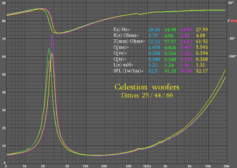

Check plots versus tabulated data for Woofers
Hey sba,
I see discrepancy between the colour code of the plots and the colour code of the tabulated data:-
(1) - Yellow seems to be correct for both.
(2) - No Orange tabulated data, and no Blue plots, and Orange tabulated does not match Blue plots !
(3) - Purple plots do not correlate with Purple tabulated data.
(4) - Green plots do not correlate with Green tabulated data.
I think I would award you a Fail result if in an Engineering Examination !
I think I can guess which should apply to which, but please do check your files and Post the corrections, because there may be some other relevant matter there that I do not know.

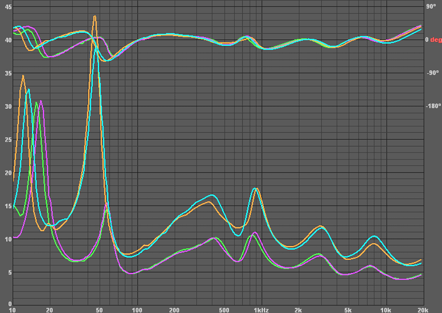

Examine tweeters physically
sba,
see the series of equally spaced humps in the Impedance plot for the yellow tweeter, and the corresponding undulations in the Phase plot for it.
These indicate a fault.
It could result from any of several possibilities, but first examine that tweeter very closely, with a magnifying glass if necessary, to see if there are any tiny holes in its dome or surround, or if any cracks or splits are starting to develop in its surround ... ?
Or, are there small wrinkles in the dome material itself ?
Then examine the Purple and Blue tweeters for similar, though lesser if any.
Orange looks to be a good quality sample.
Can you hear any difference between Orange and Yellow ? -
or between any of the samples ?
If there are no holes/cracks/splits in the fabrics, then look at the back of each chassis to see if any places where there may be an air leak through to the back of the dome.
Also, if it looks that the domes are removeable from their chassis with a simple tool, then Post that here and I'll describe what maybe can be done next ...
Similarly, examine the domes and surrounds of the Orange and Yellow mid-domes, and their backs.
The other four mid-domes seem to not have fabric problems, but there may be small air leaks into their backs, or simply the deteriorating adhesive damping that tonedef2 described, and another member posted a photo of, earlier in this Thread.

measure the inductors if possible
Hey sba,
you invite trouble for yourself !
- but it will be worth persevering as you can end up with some well matched pairs of 66s - I hope !!
Whilst you have one end of each capacitor disconnected from its circuit, then if you choose the disconnection points carefully and if you have a device to measure Inductance with, it is worth measuring some of the inductors for +/- sample variations.
(1) - the .14mH in the tweeter filter,
If one measures less than the others then use it with Purple tweeter.
If one measures larger than the others then use it with the Blue tweeter.
If you can only measure four inductors, then do these four.
And if you can measure more, then as follows:-
(2) - the .34mH/.35mH in the high mids' filter,
the lowest measured can be used with the Dark Green dome, and the highest measured can be used with the Purple or Blue domes,
and next highest with the Light Green dome,
and second lowest with the Orange dome.
I suspect the Yellow dome may be audibly faulty - can you hear a buzzing sound from it of the type tonedef2 described ?
Purple may buzz also, but at a lower frequency, but this dome may be useable when a suitable resistor is connected in parallel with it.
(3) - all the 2.2mH inductors as these can be selected between higher and lower measured values for raising the low-mids' crossover frequency for one pair of 66s.
The other pair I think can be got to work OK at the existing crossover frequency, with a parallel connected resistor trick applied to the mid-dome.
(4) - the 3.5mH inductors, for changing crossover frequency to the woofers for one pair.
Needless to say, if you do measure, then label each sample !

I used the Dayton WT3 woofer tester. The graphs are composites that were made in Photoshop Elements, using a screen shot of the WT3 graph, and text that had been exported to Wordpad.
Parts-Express Woofer Tester
The problem with the woofer graph, Herr Doctor Professor, is only with the colors. The values are correct. A master column was formatted in Photoshop and used to make the remaining columns, with the values being re-entered manually…I just forgot to change the colors on a few. Good observation Alan…keep drinking that strong coffee!

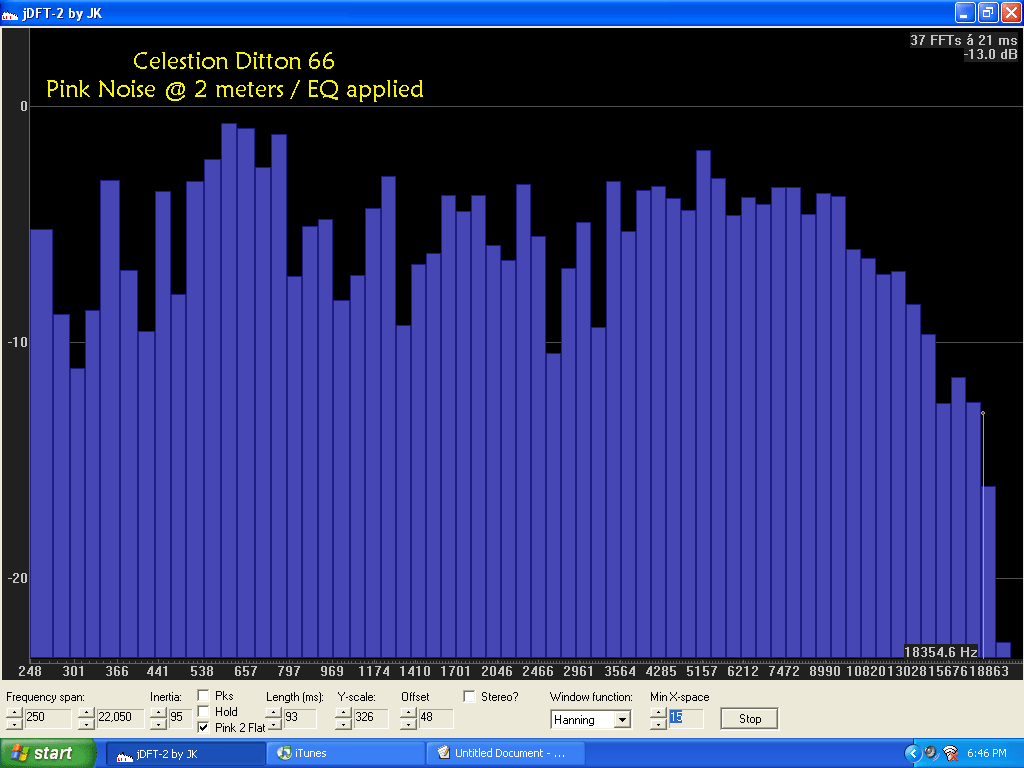

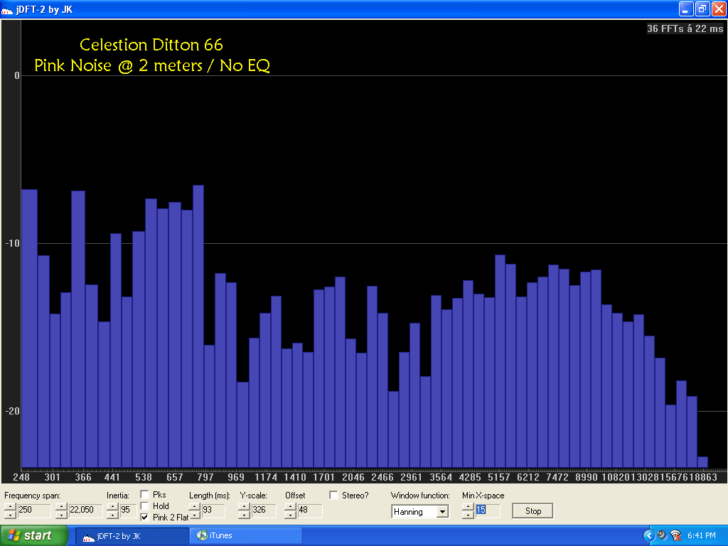

Here are some measurements of the total system. Unfortunately, the measurements were made at different addresses and on different computers. The green & purple are one set. The other set is blue & orange (and with this set I had trouble getting the tester to stabilize). So, some poor data here.
FWIW [Alan, see FWIW & IIRC ] the graph shows general trends, but the test should be redone.

From the latest Impedance plots you posted, it seems that one of your 66 pairs have a different weight for their ABRs than the other pair.

Those Pink Noise plots sba,
I cannot be sure from what is on-screen.
Are they 1/9th Octave spaced, or 1/10th Octave, or ?
It may be necessary to achieve at least 1/12th Octave spaced to get sufficient detail of the Celestion woofer's behavior in the 700Hz <--> 800Hz region, and also around 1k4 <--> 1k6, and some above, if you want to re-design for a higher crossover frequency than exists.

The L(e) data for ALL the drivers - did you measure that at 1kHz or 10kHz or ?
This is not clearly explained in the Manual, so far as I've currently found.
Comparing these L(e) data with the Phase Plots there is sufficient discrepancy for me to wonder whether the L(e) figures are suitable to use to re-design the crossover.
The Phase Plots, together with the Impedance Plots are more useful, BUT I may have to see each for single driver samples and with an expanded Vertical Scale to get close to exact data at the relevant frequencies to fine-tune a new crossover well.

See the small hump in the centre of the large dip in the low frequency end of the Orange impedance plot - that indicates some other object is part blocking an air path in that enclosure - at least at the time you measured.
Given the significant differences in the midrange and treble between the pair for which you stated the measurements would not stabilize and the other pair, I will presume the other pair to be representative of correctly measured samples, because I very much doubt the sample variations between the drivers plus effects of the inductors and capacitors could have caused such large degree differences.
Errors for that pair as result of air-leak -{vented !}- enclosures affect only the bass region of the plots, and highly unlikely to have significant effect above about 150Hz, except for a few narrow-band resonances which can come through vents at midrange frequencies, and I do not see any evidence of such in those Plots, thus the internal sound absorbing material is probably working well enough.
The dip to below 5ohms around the 80Hz <--> 90Hz region in the Purple + Green does surprise me though !
I am not sure that such is possible for those drivers with those inductors in electrical Series with them, perhaps a measurement error there ?
- but I'm going to think more about that before I decide.
The Orange + Blue pairs' Impedances is what I would have expected to see in that frequency region, thus perhaps those plots are the accurate ones ...
What else do you have Plots for that you can Post now ?

Hi sba,
wrt the Links in your #377 above:-
In the first Link, which opened at #14 in its Thread, #14 info is GOOD, as is #16 - both are worth keeping in mind.
In the second Link, this is all good stuff, though a little of it is not necessary for what we are doing here.
If you can do the Le(x) tests at either or both the excursion maximum + and/or - , then you can know the degree of limitations these drivers have,
BUT, it will be almost impossible to do with the tweeters, and very difficult to do well with the mid-domes, and given that it is the mid-domes that are the critical part of the 66 there may not be much point in doing the Le(x) for the woofers because I think the limitations of the mid-domes will be greater than those of the woofers, but do the test for the woofers if you are interested.
It would be more useful to know at what frequency(s) the L(e) data you did Post was done at, so that I know whether to advise incorporating it in the crossover calculations OR ignoring it ... thus do you know the frequency/s ?
Also in the second Link, the 3rd octave smoothing is really only useful to estimate the general spectrum of the soundfield from the loudspeaker in the room.
That is not much use for designing for a small change in the crossover of a loudspeaker which was designed to produce potentially good soundfield in a room - the room is the limiting factor for well working 66s ... if one likes their basic sound.
For any measurements, do as little smoothing as possible, and if anything radical shows that you don't understand I'll attempt to explain it.
The third Link, for HOLMImpulse - if you can get it to work with your equipment it seems it can be useful for what we are attempting to do.

Can you do a Pink Noise test with a High Pass filter applied to the pink noise ?
- and if so, what are the corner frequencies you have available for the filters ?
If you have time, do the total impedance and phase tests again before you disassemble the crossovers, though I can guess the general behavior around the bass<-->mids x area from comparing both the faulty plots.
There are other tests, which your equipment can perform, that will be more useful in deciding which drivers to apply with which others and where to cross them.
I'll Post about this when I next have time available.
