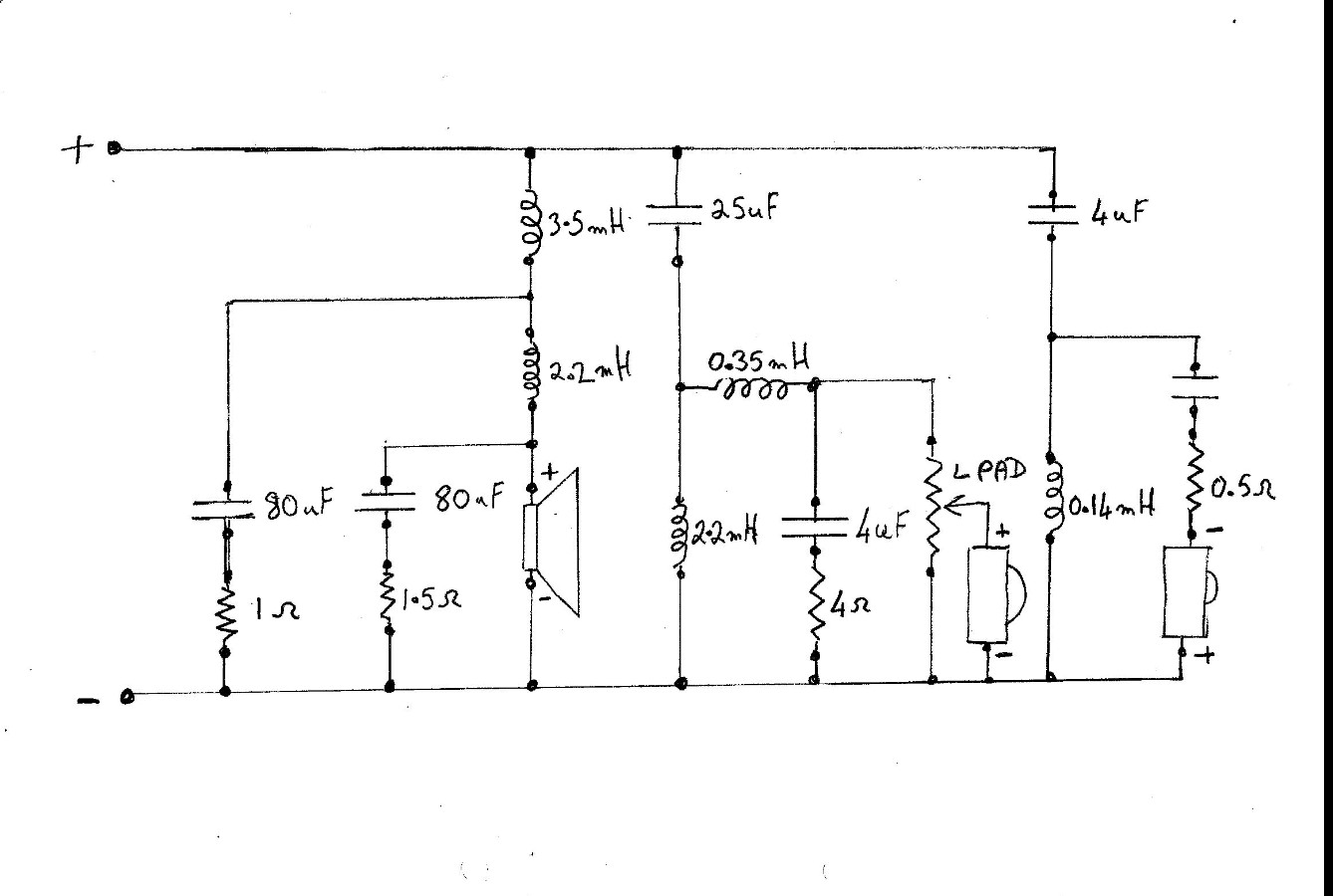

Hi Alan - I've attempted to upload a copy of my current circuit diagram, so everyone can see where we are and what we were talking about.
PLEASE DON'T ANYONE ASSUME THAT THIS IS A DEFINITIVE CIRCUIT. IT IS STILL A WORK IN PROGRESS!
In reply to your last post, the slight thickening to male voice and piano etc. does seem to emanate from the bass drivers. There isn't any significant difference that I noticed in the cabinet vibrations between the front baffle and the sides. All the original foam is in position. I'm not too sure about the cabinets integrity and seal though, they have been hard used in the past, scraped and bashed as if used as a portable PA system. I'll go over all the seams with silicon goo, and think of some kind of removeable seal I can use for the drivers. Some time ago I added threaded rods and nuts in tension from front to back next to the bracing between the drivers to kill some buzzes that were coming from the cabinets. That helped the sound a lot, just as much as putting the speakers on spikes. They are never going to be pretty boxes, so I also intend to make new ones at some point. My cabinet making skills are quite good, so I may change the shape, keeping the internal volume the same, but minimising the size of the front baffle, rounding all the edges and doing away with parallel panels. For the purists, I know it's not a Ditton 66, but I'm trying to make the best of a shabby, well used pair which would otherwise have ended up as spares.
As for the 'missing', I'm sure it was something we've noticed since the crossovers had their caps replaced. It's hard to define, but I used to find myself turning around occasionally, wondering if someone had just come into the room. There was often an element of surprise when a backing singer or an instrument burst into life and sometimes there was a feeling of sounds coming from nowhere near the speakers. Some of this has returned since adding the resistors.
I'm having fun tinkering...

Hi Stuart,
indeed Computers can be frustrating things at times, and sometimes one does not know whether something has been accepted or not till after a delay caused by I do not know what !
At the Top of the page click on FAQ
and on the then displayed page go to the bottom-left of and under "New To Site" click on "Contact Us",
and use the Form there to ask the Administrators to remove all the duplicate Posts from #326 <---> #331 inclusive, because #325 is displaying the schematic OK.
Tell them all the additional Posts are adding to the clutter in our already very long Thread.
You will have to list the exact Title of the Thread, plus the exact starter's name :- Mr_White.
You will only be permitted to ask for your "dloper" Posts to be removed,
but perhaps they will remove this Post of mine also when they read what this is about ... otherwise I will ask them later.
More information please
Hi Stuart,
the "thickening" :-
part of its source may have been previously obscured by the sound of the old deteriorating mids' filter caps.
Do you currently feel any significant vibrations in any of the cabinet's panels when the thickening is occuring that are not there, -{or are a different type of vibration}-, with music/voice sources that are not subject to thickening ?
Do you hear the same degree of thickening regardless of the Vertical Axis you listen on ?
That is, is there any difference when you listen below the mid-driver axis towards or on the woofer axis, compared to if you listen on the mid-driver axis or above, towards or on the tweeter axis ?
What is the usual vertical axis you listen on for critical listening sessions ?
Before you build new cabinets, do Post your intention, because if you decide to change the ratios between the internal's Height v/s Width v/s Depth you may as well do it towards new ratios that can perhaps improve the audible performance rather than towards ratios which can cause audible deterioration.
I will explain more then, and also about curved edges to the baffle, etc ...
For now, do at least try the rolled up woollen sock along the entire under edge of that overhanging lip at the top of the cabinet.
I Posted about that somewhere earlier in this Thread.
After that I have another treble trick for you to try.
It can be tried with your KEF 104s also,
and do Post about those before you buy any new caps for them.
I'll eventually get to what I was going to say about KEF 104 when I have time available.
The "something missing" may be a bit harder to solve, however I fear to warn you it may be related to the new 80uF electros, as may also be the thickening in at least part of its emphasis.
I will explain that next time, but I do need to know the audible results of what I asked above first, so as not to risk pushing you along the wrong path.
The "thickening" and the "missing" issues should be investigated before you replace the L-pads with a choice of resistor,
but do continue to fine-tune the L-pads to decide best compromise position to suit your favorite recordings.

The Inductors' relative positionings now ?
Hello Stuart,
I have remembered you posted that you rebuilt your x-over boards.
Did you place any of the Inductors differently on the rebuilt boards to how they were on the original boards ?
That is:-
Are any further or closer to any others than they were originally ?
and if so, then which ones, and relative to which others ?
Did you change the physical orientation of any of them - in particular did you place one or more upside-down
to what it was originally -{even if still lying it flat on the new board}- ?
And/or, have you placed any standing on their curved edge now ?
On the original board all the inductors are a bit too close to each other, thus there will be some magnetic coupling between them.
If this has been changed the sound will change, and it can possibly be got to change for the better by specific orientation and placing, but it can also be got to sound worse ... and where-ever in between that is simply different ...
A small change in any of the ways I have described could have caused the thickening of the lower midrange sound you are noticing, even if that is primarily from the bass driver,

Thus, before I proceed to suggest anything else, Post the current situation of the inductors.

Hi Harnfield, Alan
This was my experience too, that the midrange was very aggressive when I first changed the caps to polypropylenes of equivalent value, but I found that with resistors, in the value range that Alan estimated and suggested to me in another thread compensated for ESR and brought things into line admirably. The result is quite sublime, actually.
What values of resistor are you currently employing? Perhaps you could draw us a schematic of your current crossover configuration.
