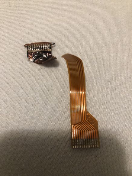

.....it's working - i repaired it.....
it was the lasers thin foil cable that was damaged, one of the copper leads was cut in two.
i was really nervous that the krell was dead.....and now it's playing better than ever - i replaced all the caps on the controller/sevo board with oscons.
next up is black gates nx arround dacs and I/V opa's.....

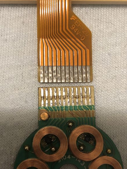

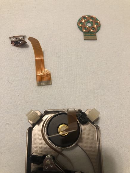

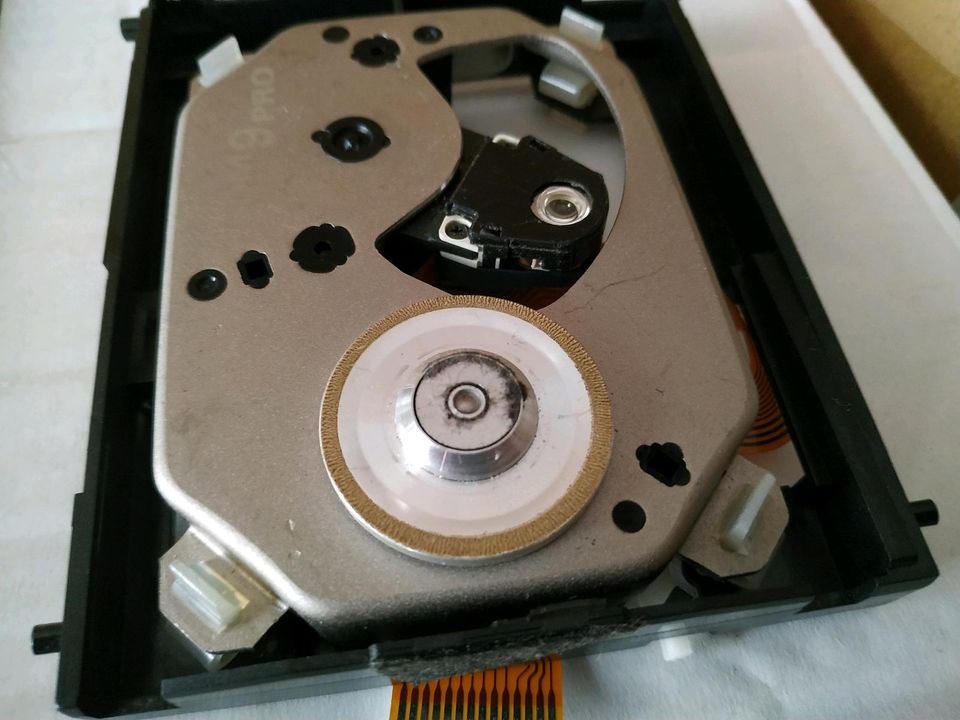

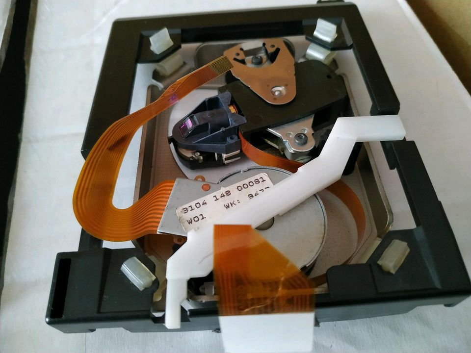

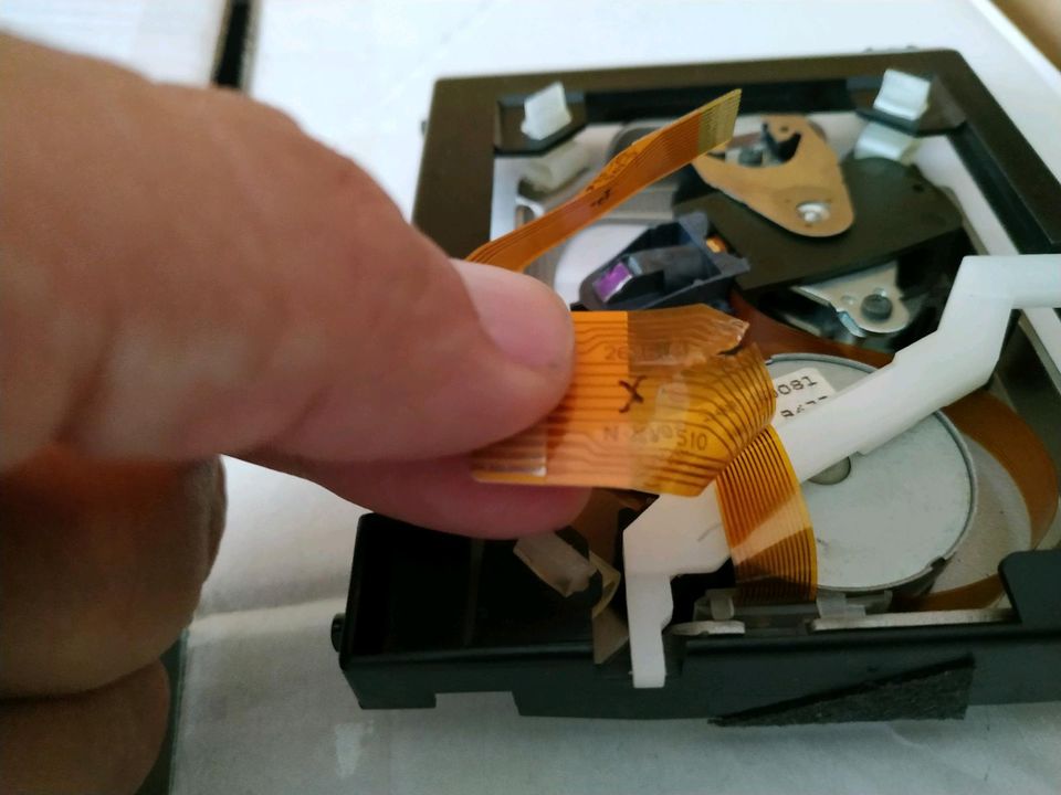

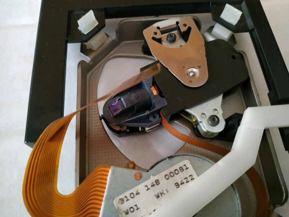

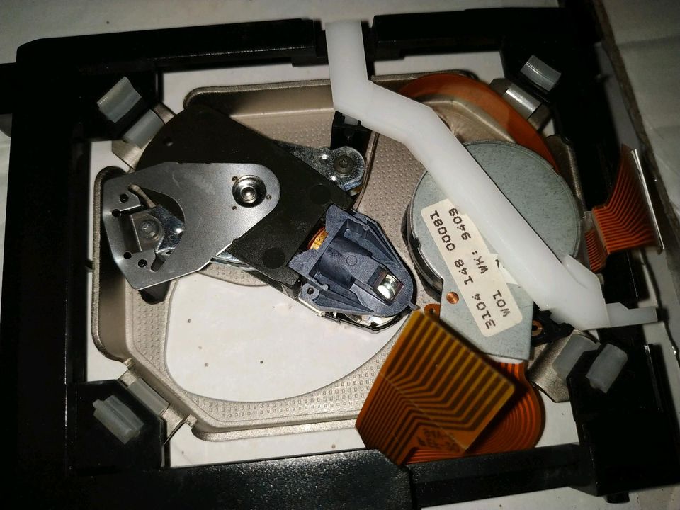

not the brushless motor itself, but the ribbon connector, if destroy.The brushless motor is never the issue. If you want to find a low mileage laser buy a kodak pcd865. I picked one up, nos, unopened on ebay for £100. Ten minutes later I'd gutted the cd mech, vac bagged it and now I have a spare should my audiolab cdm transport ever die.

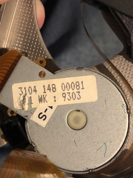

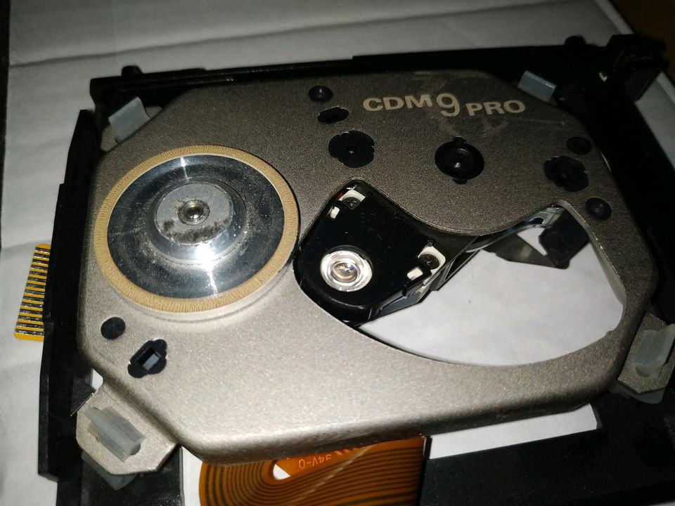

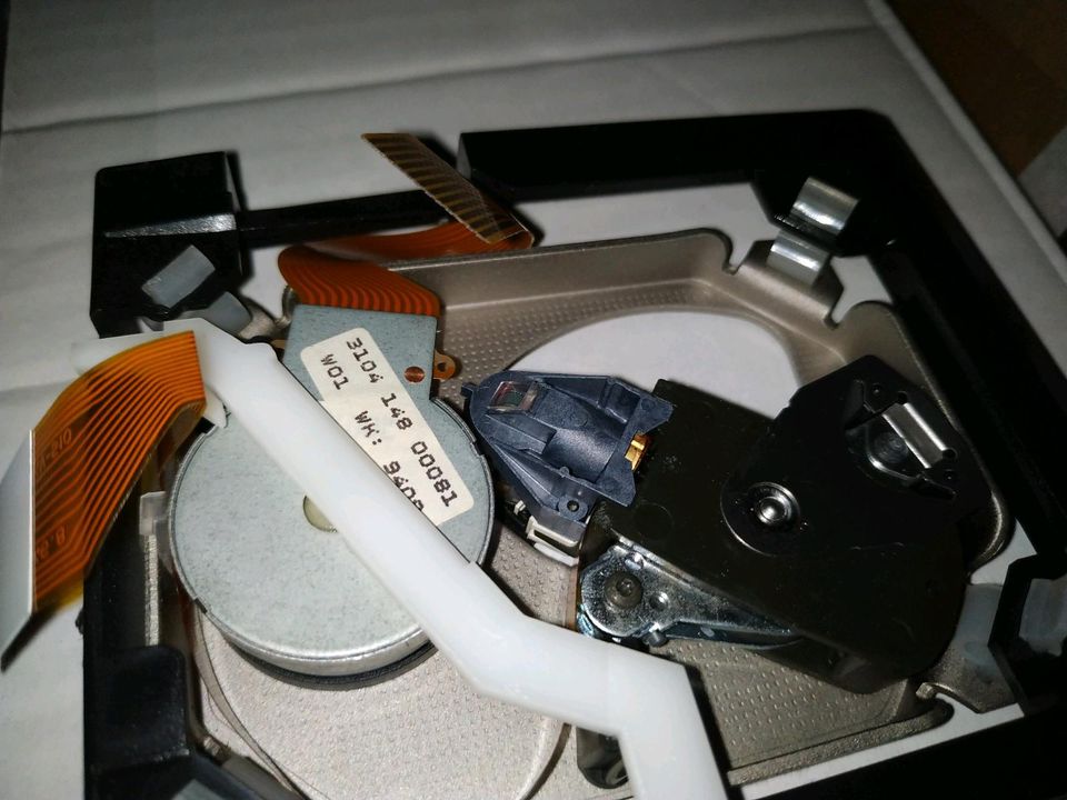

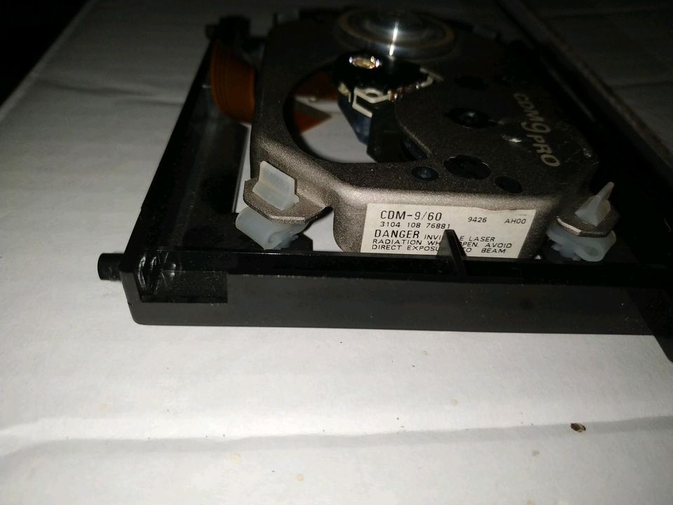

some images - even from from open brushless motor in the attachment (maybe it is possible, now replace the flex cable by an other version).

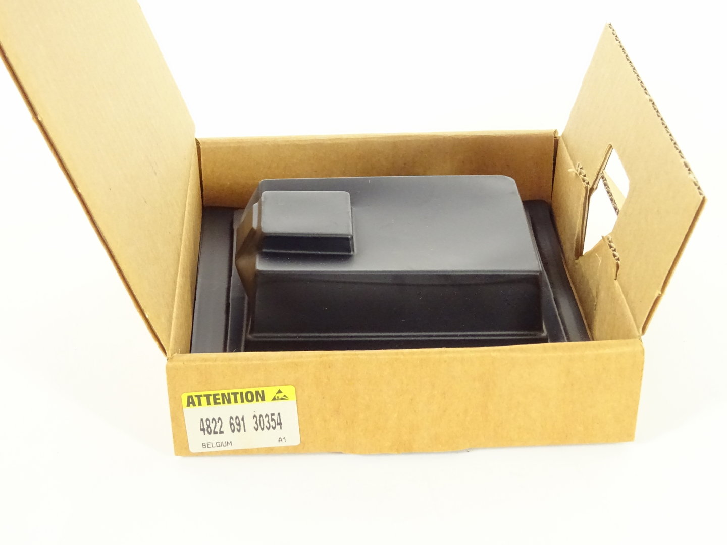

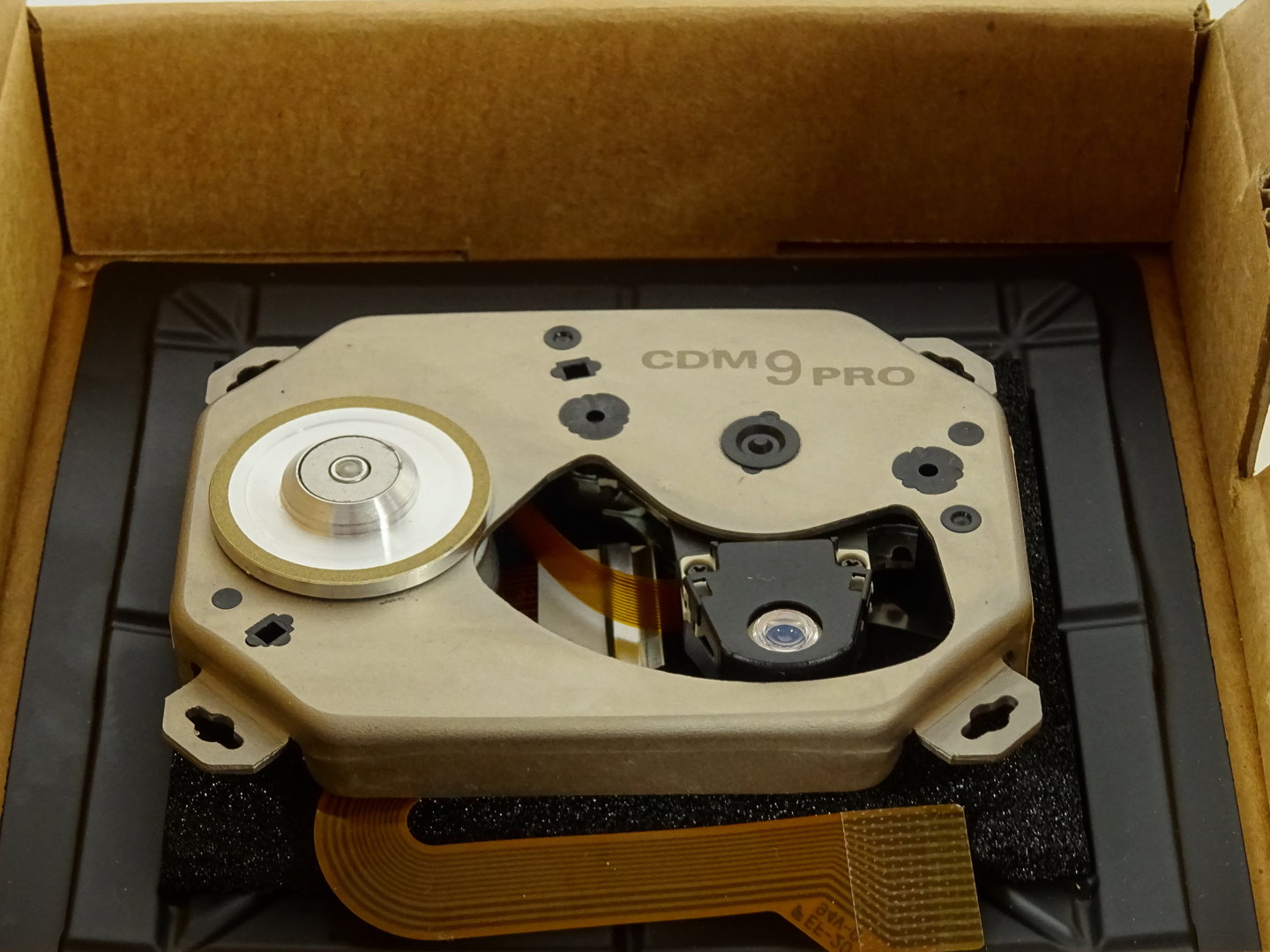

And an offer (low price - so I think)
https://www.kulthifi.de/Original-Philips-CDM9-Pro-drive-NEW-and-unused-CDM9
https://www.kleinanzeigen.de/s-anzeige/philips-cdm-9-pro-laufwerk-aus-emt-cd982/2532010509-172-3169
https://www.kleinanzeigen.de/s-anzeige/philips-cdm-9-pro-laufwerk/2539918052-172-3169
