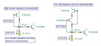

Thanks for all those ideas. I will give a look at them next weekend as i have a quantum mechanics exam friday.
I see that you use voltage regulator ic's. Aren't they noisy? I use to bypass all voltage references with caps for that problem and to be sure that impedance does not go too high at any frequency (including 300MHz) to be sure the system will be stable and won't develop sustained gain at any frequency, is there any problem in doing so in your schematics?
I like very much the FR of the bf's, but i don't use them because the low transconductance of the jfets makes it difficult to degenerate them to minimize distortion, but for ccs's they may be wonderful.
Hugh, do you belive that a distortion like the one i get from spice simulation would ( a ) be possible in practice and ( b ) sound nice?
My design method is to simply reduce the distortion as much as possible without increasing anything above the 3rd. The 4th and 5th were even bigger in the simpler designs, but they were invisible compared to 30 times higher 2nd harmonic. I hope this does not happen during listening (the very low second and third making the others visible). I see in your website that you say that your amplifiers have distortion that is mostly second and third harmonic and that both are musical, is there anything to worry about having more third than second assuming that both will be always under a part per million?

My spice simulations show that cascoding makes the output stage more stable. It should also minimize the Cgs effect, because in the non-cascoded situation it gets magnified by 17 at a Gm = 4S and Rl = 8Ohms. Tests show that it cuts the distortion by more than 3.
I get ringing on the upper half on both simulations and lab in the not cascoded amp. In the cascoded one this does not happen. The voltage cut by the cascode is low because it's a bjt transistor, negligible in comparison to the cascoding voltage.
Ion,ionomolo said:Hugh, do you belive that a distortion like the one i get from spice simulation would ( a ) be possible in practice and ( b ) sound nice?
Though I'm not Hugh, I think your distortion values (those 1ppm @25kHz) are hard to believe.... I'd certainly need to sim you circuit with as close as possible parts (models) I can find and then compare the results, also taking a look a stability. Often I find that a circuit that sims nice with sines in fact is close to oscillation nevertheless, and once you compensate it to be reasonably stable (into a typical speaker cable load, not to forget) you'll loose a lot again. Either only at the top end, or over the whole audio range (depending on how you arrange the openloop gain roll-off, inside or outside the audio band).

In the version i posted the driver is too hot and it starts oscillating at about 3nF, but the open-loop gain can be tweaked. Assuming that cascoding gives no early effect, the amp is a transconductance amplifier coupled to an integrator, quite similar to an instrumentation amplifier.
Since the cascoding of the driver makes the driver independent from the output, the transconductance can be tweaked by simply changing the output stage. I belive the proper value should be the highest possible that is stable on the particular real load you run it.
the "small-signal rate of error voltage correction" (i have never assisted to an electronics class, sorry) is Gin*Go*Rl/(Cgd+Cgs) = 0.04*Iin*Go*Rl/(Cgs+Cgd) = 6400 (V/V)/us at 10 mA , where Iin is the driver idle current in mA's. Wow, this looks like the inverse of a time constant! So the time constant can be tweaked by changing the bias current without having to add any new parts.
If the driver is not cascoded it becomes 0.04*Iin*Go*Rl/(Cgs+GoRlCgd) (roughly) 0.04*Iin/Cgd

I think my last simulations will make me follow your suggestions. I have just discovered that i had to add the exact ammount of compensating capacitance to make it stable in a certain capacitive load that i did remove with cascoding, so shows the maths are ok and the cascode is worthless.
You belive that cascoding the driver is worth the problems?
Your comments are of great help! Thanks.

Klaus,
MOSFETs are genuine transconductance devices, where the the input voltage and the output current are directly related, buffering would make the conversion less accurate (meaning decreased linearity). So the driver has to provide the necessary current, cascoding helps in this regard too. Cascoding has many benefits not just stability.
The driver current is a generally neglected issue, I cannot make estimations just instinctively feel that it`s about a considerable amount to handle such large input capacitances (fast enough), maybe at least 50mA.This needs a very healthy driver bias current or even better yet, buffer the gate drive with a follower.

Ogir,
How much slew rate do you want at the mosfet output?
50mA is far more than is needed......
The change in voltage at the gate wrt rail is not great; only about a volt, the C/E of the driver is working as a concertina, like a phase splitter.
Anywhere from 5-10mA is fine; we are designing for human hearing.
You could supplement the gate drive with an EF driven from the driver collector and supported from its own CCS at the rail. That would work fine, greatly reducing current at the driver.

Lumba Ogir said:Klaus,
Beware that the driver current in that circuit sets the open loop gain and the time constant of the integrator. High currents make the amp unstable and distortion is closely releated to current because it sets the amount of feedback.
Non-cascoded designs don't have this issue because transconductance goes with the bias current and output resistance goes as its inverse, so the effects cancel and the "mu" of the transistor becomes constant with current, if this effect dominates then it does only set the slew rate. Anyways the non-cascoded design has both effects and it needs more detailed analisys.
