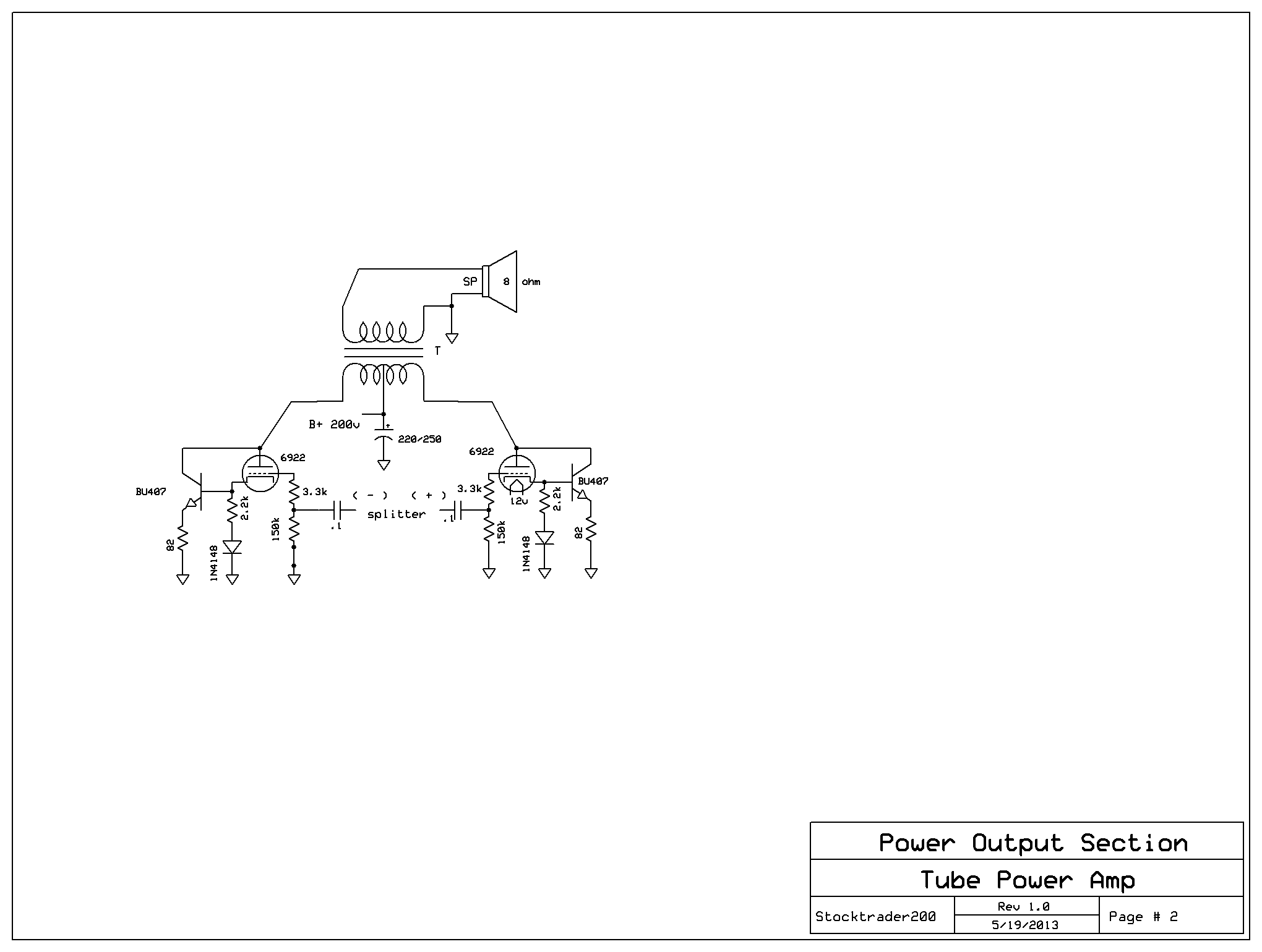

the tubelington works brilliantly with 6922
50 w push pull config 200 volt B+
Is that your tubelington PP OPS formed as SEPP power bridge( Single Ended Push Pull ) configuration ? or ...,
Which type of BJT`s you use for B+ = 200VDC ?
Maybe some basic schematic ?

The 82 Ohm emitter resistors are changing the transistor drive sensitivity to voltage input somewhat. That might account for some bipolar exponential character intruding that Luckythedog mentioned. If the BU407 are near constant Beta, it could help to remove the emitter resistors, or at least lower them to a low R Isense value, for some idle current control servo to operate from.

OldEurope's (Darius) design without the emitter resistor looks like it preserves the tube characteristic well (he just used 12AU7 that looks bad)
http://www.vintage-radio.net/forum/attachment.php?attachmentid=7529&d=1167819193
Putting an emitter resistor in, changes the circuit to a V to I converter, which will not sound or curve trace the same.
the emitter resistor linearizes the transistor while also feeding the tube transfer characteristic at manageable ( 75 ma to 150 ma ) current levels.
a ground biased 6922 will drive the resistor-less BU407 or MJE13007 to over an amp.
I have been thinking of trying an OTL 6922 amp running this way.
