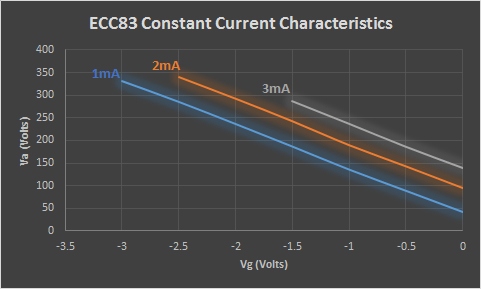

Browsing vintage texts (as you do), there's an imperically derived general relation describing transfer characteristic for a triode :
Ia = P[Vg + Va/µ]n
(e.g Dow 1937 p122 equation 282p)
Ia anode current
Va anode potential
Vb grid potential
µ is amplification factor
P is a constant depending solely on geometry/construction
n is a constant depending on operating point and cathode parameters
For indirectly heated cathodes at normal operating points n is expected to be near 3/2, and the well known Child-Langmuir 3/2 power law is recognised. Whatever its exact value, the n term represents non-linearity in transfer characteristic for Ia versus Vg.
However, if Ia is constant, eg a CCS anode load, something very interesting happens it seems:
Define a new constant for convenience k =[Ia/P]1/n
Substitute k and rearrange Va = µ [k -Vg]
Diiferentiate to obtain transfer characteristic dVa/dVg = - µ
That is to say, the transfer characteristic is linear, there are no terms in n, no matter what the original value of n was !!!
Then a triode curve for Va versus Vg with a CCS anode load is simply a line of gradient µ, in principle. This is confirmed in Langford Smith, Radiotron Designers Handbook Ch 2 pp22 et seq, and by fig 2.15 p24.

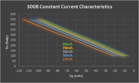

Transfer characteristics for real triodes valves in constant current mode can be found simply by transposing curves from published specsheets. I did this for three devices below 300B, ECC88, ECC83. They each confirm straight line transfer characteristics over a wide range of Ia and Va. Where there are wobbles I suspect the accuracy of my ability to read graphical values accurately, FWIW.
So as long as the relation between Ia, Va and Vg conforms to the general form above, the power term n such as 3/2 is eliminated from transfer characteristics for triodes operated with a CCS anode load, and a linear characteristic is available over wide operation conditions.
For this to be true, external load has to be very high impedance and CCS ideal BTW, so in real circuits an impedance buffer stage and good CCS seems essential if linearity is the aim.

Nice work, LuckyTheDog. Nice indeed. I was going to argue that the (Ia/P)(-1/n) equation isn't a constant. But then ... you "made it a constant" by saying, "using a CCS". Excellent.

Yes, Mu, that's how it is defined at constant current. It supposed to be constant.
Only problem is that the grid1 on most tubes is close enough to the cathode surface to show grid wire proximity effects. Old tubes (well spaced for linearity) may show close to 3/2 power for the grid1, but later tubes are closer to square law. Usually it varies from somewhat above 2.0 power law at low currents down to less than 1.5 power law at high currents (may be exponential even at very low current). Grid2 on the other hand is far enough away to operate close to 3/2 power law reliably.
So the mis-tracking between the grid1 power law and the grid2 power law causes Mu to vary some as current increases (generally increases until saturation effects make it drop again). But the Mu will usually stay fairly constant if the current is kept constant.
That 12AX7 has such low grid1 gm (like an old tube, its got more space between g1 and cathode) that it is close to a 3/2 power law on g1, so Mu stays fairly constant versus current.

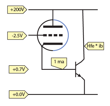

"the output tubes "job" is to strongly modulate the current fed into the windings of the output transformer. "
Put a constant Beta (current gain) power bipolar transistor under the triode's cathode (cathode connects to base terminal), and connect the collector to the tube plate. Now you have a 3 terminal device (grid input, emitter, collector/plate) that has triode Mu V gain, and bipolar Beta current gain, well, bipolar current output (current gain would be infinite from grid).
A tube Darlington, or "tubington".

Yes. There's no escaping non-linearity in the current domain, normally near 3/2 law. In cascode case linearity depends on how current is then converted to voltage in the top half of the cascode - if conversion is linear ie resistive then that is as non-linear as it gets in principle - if conversion follows exact inverse law then it gets perfectly corrected, so devil's in the detail I think.Let's see … then by the observation that "real world anode circuits" have an effective impedance less than infinite (real loading, both a/c and DC), and recognizing that the closer to infinite impedance the load gets, the more linear will be the triode's amplification, then the opposite also stands to reason: the worst linearity will be had when the anode voltage is held constant, as in a cascode arrangement. (Cascode loads offer "near zero impedance" to the tube, the opposite of the CCS load).
Optimal linearity for conventional triode operation is when anode load impedance is infinite, so mucking with negative impedance via feedback is never going to improve !
"In cascode case linearity depends on how current is then converted to voltage in the top half of the cascode - ...."
One could look at the cascode as a variant of the Aikido input stage setup, but with a very low Rp tube up top. In the Aikido, the gm and cathode rk need to be scaled proportionally between top and bottom. (normally an equal top and bottom setup in the Aikido) But the gain is only constant at constant current, so maybe need a CCS on top of both. Looks unstable.
Maybe put a tube diode in series between top and bottom tubes to inject more 3/2 power Z.
Or put a HV diode up top for the load. 3/2 power V to I followed by 2/3 power I to V.
Yep, Tubington
Can also put a PNP on the top side instead. (plate to base, cathode to collector).
