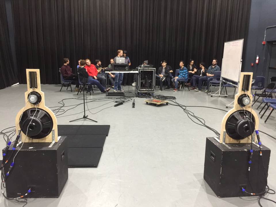

Haha no kidding....on a more serious note aesthetics and price-point are indeed the two driving factors in what we do as well. Here is what we have been playing with lately: Dipole low/mid transitioning to cone beaming to waveguide control. They work great because they put the singer(wearing an omni mic) right in the dipole null. Makes life a lot easier. :). Here is a video where I'm demo'ing the idea for a show we are working on.
https://www.youtube.com/watch?v=HlYiIho5c1A
Brett
Thanks for the video - you could do a dipole CBT.

Rick I was contemplating something based on the Dayton AMTPRO-4, which I think would work pretty well as we already use them in our Linkwitz inspired dipoles. The issue is the midwoofers; I'm thinking with the shading and trying to overcome the dipole loss smallish woofers are going to run out of steam pretty quick. I wonder if I can get away with 8 inchers and cross hard about 1.2k????
Pic of our AMT dipole prototypes....which are ok but have issues. One problem is the narrow vertical on that ribbon, which is what got me thinking about these CBT's in the first place.

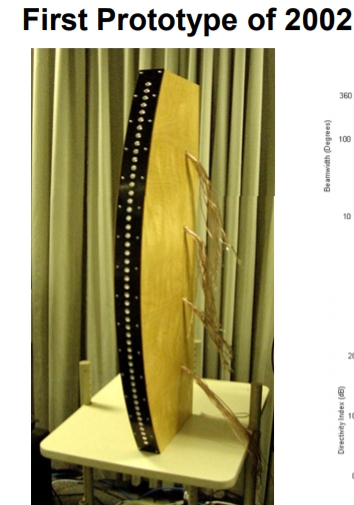

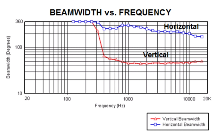

Need to clear up a few things. The 3D balloon that I showed was of 1 m tall CBT prototype, 60° circular arc. and 45° vertical beamwidth. Polars and balloons were measured at a distance of 6 m in JBL’s “Arena” test lab.
So this small prototype becomes wider much earlier in frequency.

In the balloons, notice how the vertical coverage narrows as you go off axis horizontally. It actually reaches a minimum at plus-minus 90 Degs! This is a characteristic of all circular-arc arrays, not only CBT!
attachment.php
Note: For the ground-plane CBT36 array, this narrowing occurs at floor level! Effectively the bottom of the following balloon is cut off! This is why the horizontal coverage of a CBT array that sprays the side walls is much reduced compared to a conventional speaker, the vertical coverage is very narrow at the sides!
The horizontal beamwidth of CBT36 is 180°, 90° to each side as shown earlier in another post. But only at a certain height as Don points out, it get's narrower at the bottom. So it's not omni, unless you define 180° as omni. Personally I regard a speaker that's close to 360° being omni.

I've not heard the JBL Eon, but I am well versed in the Bose and have owned the K-Array($$$$$) KR systems. They are small and portable, but ignore the elephant in the room, just like all of these systems: **low frequency and mid-bass pattern control**. All I want is a speaker that illuminates a room roughly similar to how a real instrument does. In theatrical sound that is the goal.
Despite Keele's, and other's, claims of broadband pattern control, none of them actually achieve any semblance of pattern control in the lower octaves, vertical or horizontal. In the horizontal, 180 degrees from 600hz up and 360 degrees 600hz down is NOT constant directivity in my book, while the upper octaves are 120 degrees or less. Can you imagine what a sonogram for those looks like? Klingon "Bird of Prey" comes to mind.
