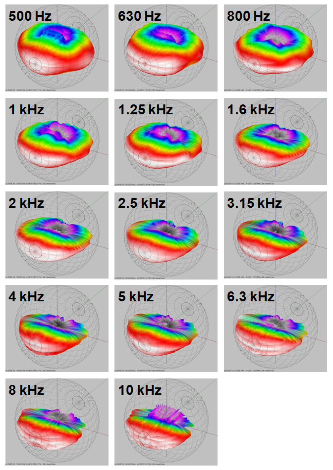

These are the 3D polars of a CBT. I took this measurement from one page ago. Note that directivity is controlled in the vertical plane, but not the horizontal
Here's a Danley SH96. Note the directivity is narrower and it's (mostly) symmetrical.

It's a little hard to read the directivity from that balloon. And I'm not sure if the balloon is from CBT36 or a smaller CBT prototype. I'll check this.

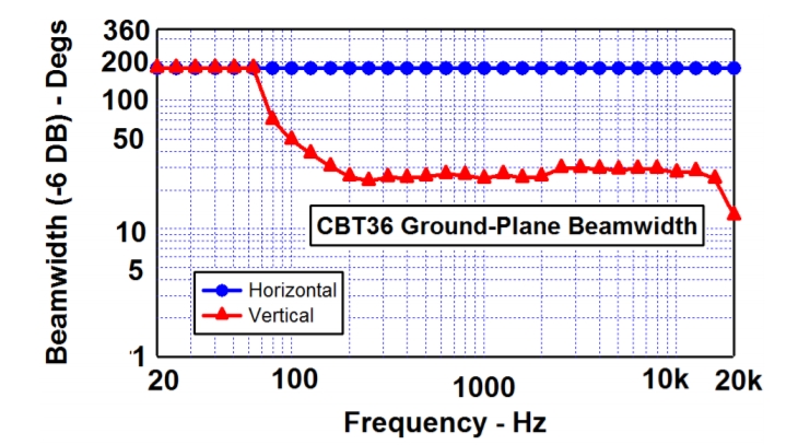

But if you look at the beamwidth of CBT36 from the manual, you'll see it's 180-200 degrees. I believe it's closer to 180 degrees, 90 degrees to each side.
While this isn't actual measurement (a simulatation) it corresponds well with my measurements in an actual room. I haven't seen high gain specular reflections from the front wall, which would be the case if it was omni. With much toe in though in a very small/narrow room, I've seen reflections from the front wall corners but that can be explained with the wide 180 degrees beamwidth.

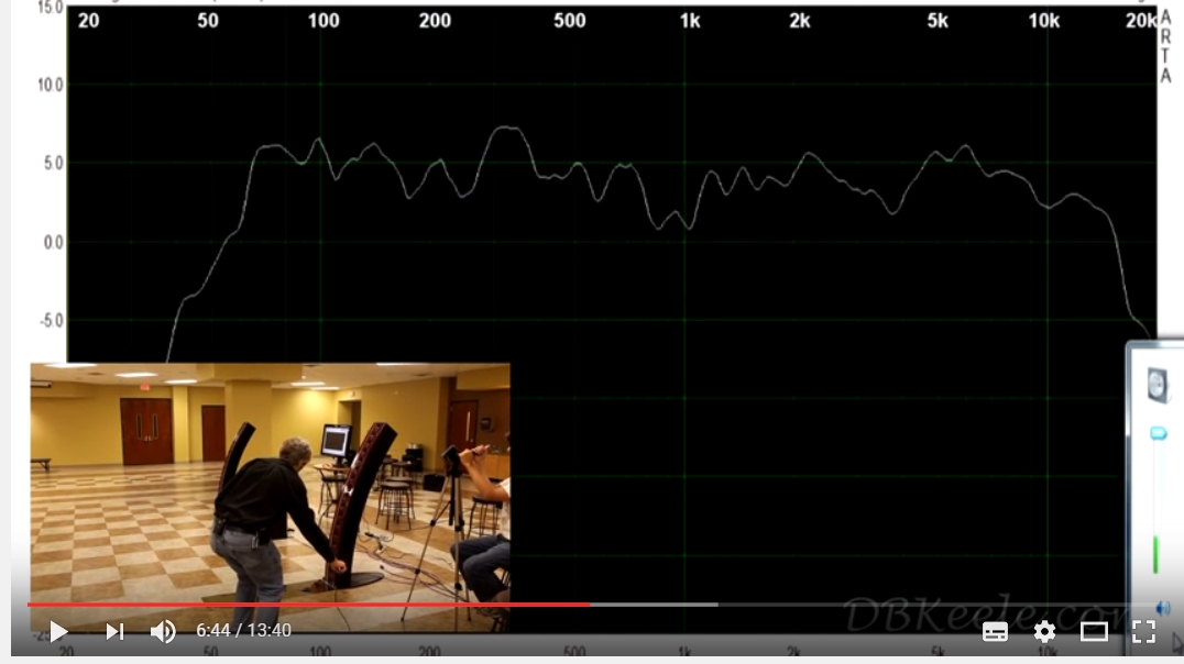

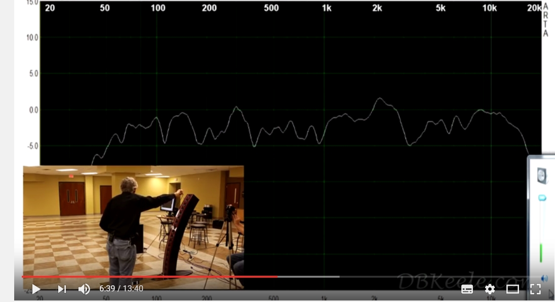

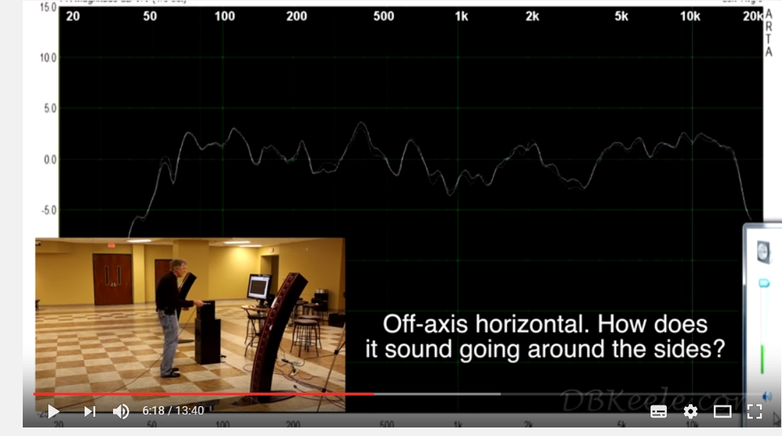

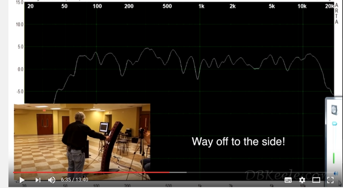

If we look at the actual off-axis measurement of CBT36 Don did in the room from the video, I would say the horizontal shows an incredible consistency. Remember that it's shown with 5 dB large increments. Even far to the side (perhaps 70 degrees?), the response is within 3 dB. Not only does it do that at one height, but at all heights! While the horizontal isn't perfect, it's darn good and I don't know any speakers that are close to this when we include different heights. An omni speaker like MBL is only constant at one height.
Just to avoid any misunderstanding; a controlled directivity doesn't necessarily imply a narrow dispersion. People use the words differently, but controlled basically implies a uniform directivity that doesn't change much. In this regard the CBTs are controlled which the video shows. However, a CBT like CBT24 and CBT26 have wide dispersion. CBT36 is wider higher in frequency than CBT24 due to the fact it's using smaller drivers in this area. When it comes to how a CBT reacts to the baffle (which Patrick pointed out), I'm really not sure if it's similar to a typical frontfiring speaker. I'll find out.
If you compare the CBT with a typical waveguide speaker where the waveguide only operates from 1-2KHz, there's no comparison. The waveguide speaker has a collapsing polar which is very audible when you compare it to a speaker with constant directivity much lower in frequency. The rapid change in beamwidth at a very audible range, colors the sound and it doesn't sound natural/right unless you treat the side walls with broadband treatment. I have heard this several times when comparing Abbey to CBT36 and my visiting friends who have listened to both preferred CBT36 by far. With direct comparison it's easily heard. The CBT36 sounds sounds correct in tonality with no side wall treatment (though you get flutter echo with no furnitures), while the Abbeys don't. I have also worked with PA by the way and have set up and listened to many other waveguide speakers.
You also see the lack of controlled direcitivty below the operation from the waveguide in the frequency response measurements. It becomes very uneven in a living room, while the CBT36 changes little above 300-400 Hz in most rooms.
However, if you compare a huge horn speaker with controlled directivty to 300-400 Hz with the CBT it's completely different comparison. I have done that too. And here they are more different than one being better. The horn avoids side wall reflections to a larger degree, while the CBT has a wide dispersion with lateral contribution. Obviously one can treat the side walls with absorption and they are much closer again. Anyone who wants the best imaging and accuracy should really use treatment with both types of speakers in a small room. But without any side wall treatment, the horn will yield better imaging while CBT will sound more spacious. It's really a matter of taste. A large horn speaker does have advantages of high sensitivity and better midbass capability than CBT36, which makes it more engaging to listen to but those things can be achieved with different drivers in a CBT as well. CBT36 has a very low sensitivity because of it's small and inefficient drivers.
Vertically the CBT is more uniform than the horn. And while the horn minimizes floor reflections, the CBT completely avoids them. Ceiling reflections are very similar and dependent on the CBT arc and the shape of the horn but the CBT holds it's direcitivity lower in frequency even compared to a very large horn.
IMO, the discussion shouldn't be about a rather small horn speaker vs CBT but a horn speaker with directivity down to 500 Hz or lower vs CBT. They are both great and I personally love both.
Obviously I'm takling about the regular circular-arc line arrays here. It possible to make a CBT in other ways and minimize the horizontal directivity. That can be done several ways and it would also make the CBT even more uniform. However, in polar plot with 1/3 smoothing this would not necessarily be seen. You would most likely need graphs with higher resolution.
