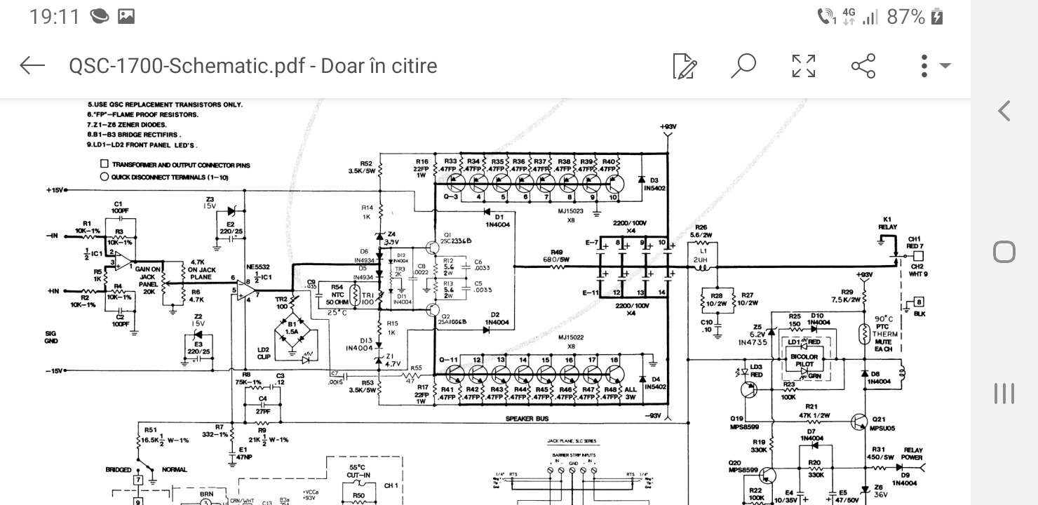

Once you can use an op amp for all the low level processing, why would you bother with cascodes? Well...you can cascode an entire op amp or use folded cascodes for better headroom, but then...QSC cause most good opamps have a cascode of some sort as the input stage .
And... not all cascodes are born equal.

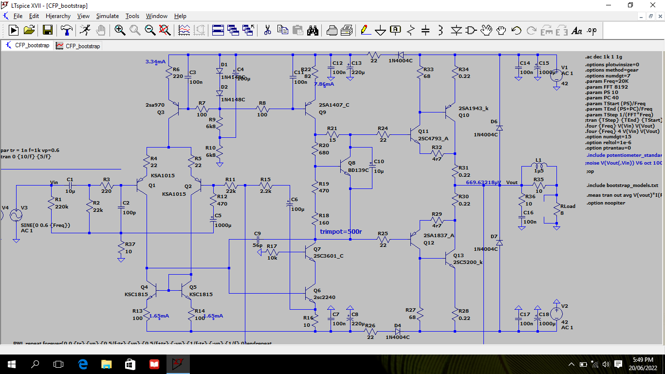

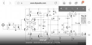

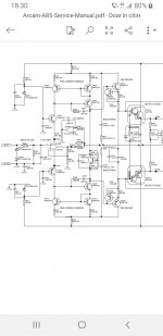

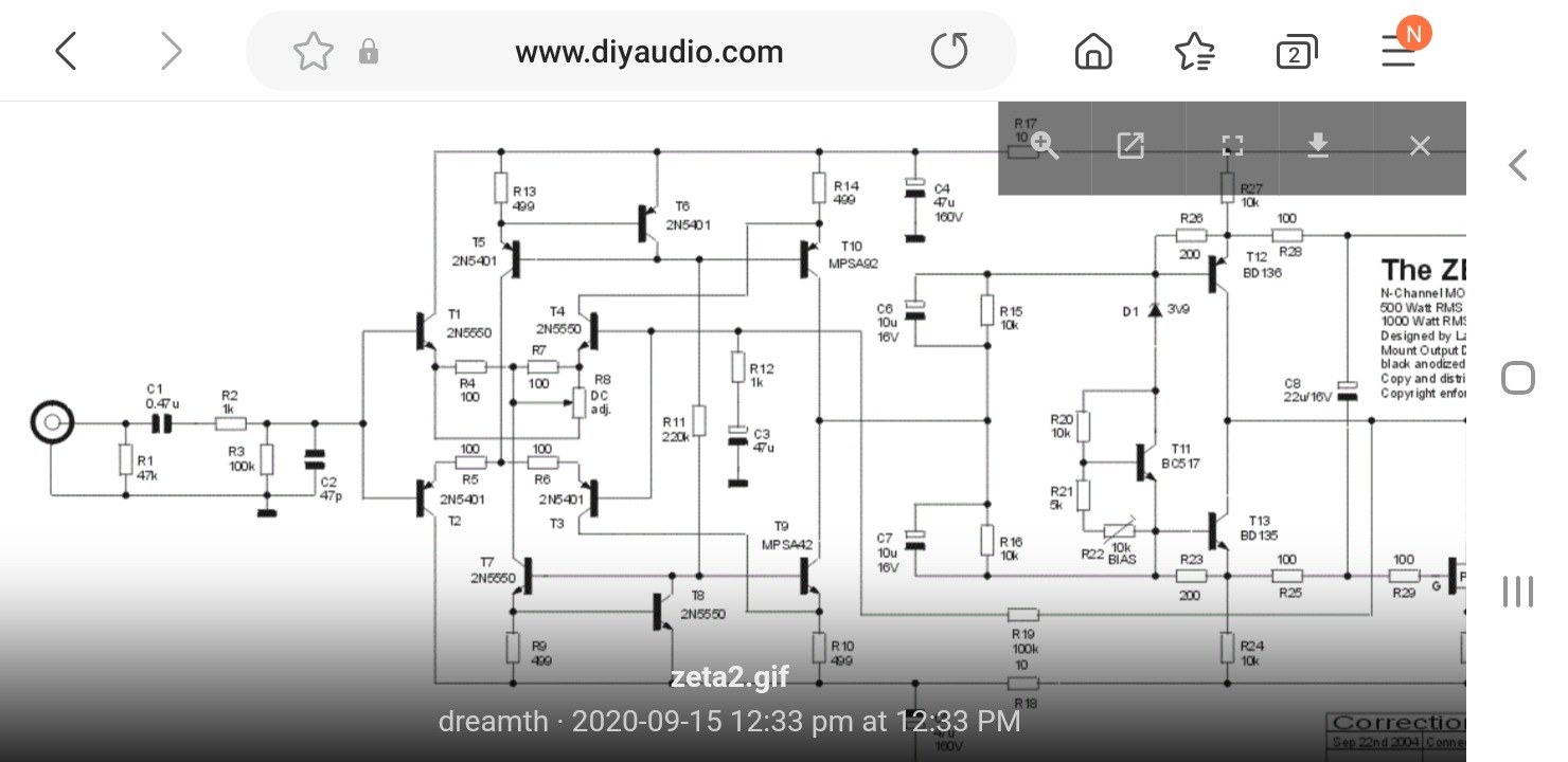

Brief update: The DC offset and oscillation I was observing had nothing to do with the cascode arrangements shown in my schematics earlier. I just like to point this out.
The issues were related to a different cascode however and the root cause was trivial: The cascode of the VAS was chosen with too low voltage across the VAS transistors. Just a stupid mistake. Lesson learned: Make sure the cascoded transistor has enough Vce headroom to work well.
I still get some offset and oscillation however once I connect my DAC to the amplifier input and need to figure out what is wrong. The oscilloscopes square wave generator as input does not cause this issue. In case this is related to any cascodes, I might post here. Else, I will just sort out another stupid mistake I made.
spot on, missed this one.If I am reading your circuit correctly your cascode (Q7) is referenced to 0 V Via R17. It should referenced to 3-4 volts above the -ve rail after R26. You can use a Zener or two LED’s to create the correct voltage.
