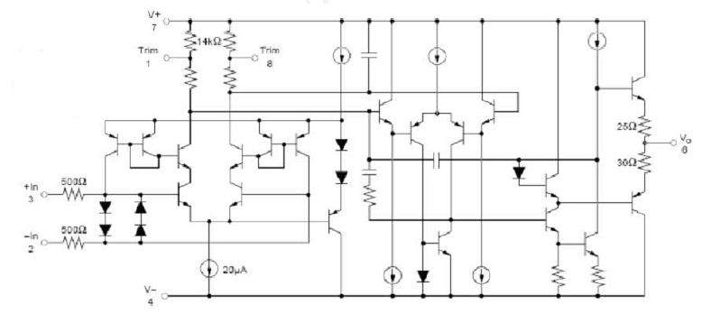

I don't know how Halcro regulate their supplies, but I imagine they do it pretty thoroughly. Even if PSRR is not the point, Q5 & Q6 still provide a small CMRR benefit. There may be other benefits that would take more time to flush out. I very much doubt that Halcro put those transistors in there without very careful consideration. Lesser brands, maybe! :)
That's what brought me to my initial question; the merits of cascoding on the basis of referencing the signal waveform (representing something like a ripple influence, however "congruent" to the signal itself). My conclusion has become: If Miller effects and associated impedances are accounted for and/or minimized in the bandwidth of interest, biasing cascodes relative to the signal waveform can be made practicable to the end of containing the gain transistors at INDEED constant Vce. This of course based on assuming it is approached in a way that does not load or affect the input signal source.

Here's another configuration to consider, JW. This is some unidentified op-amp schematic I found. This appears to provide a dual function cascode, one to minimize Vce variation and the other to servo the base current, thus boosting input impedance.
