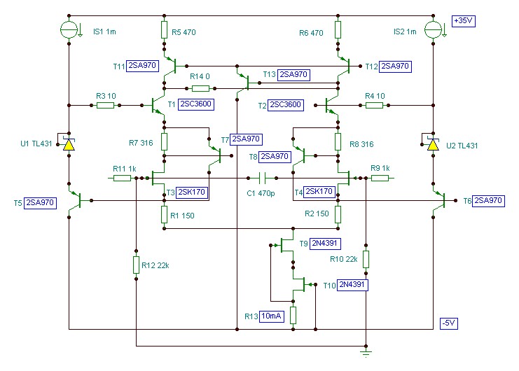

Lumba Ogir said:acoustixman,
consider this circuit as a starting point.
Thanx a lot; I'll have to study more closely later though; busy day of coding at the orifice today!

Lumba Ogir said:...starting point... (schematic)

acoustixman,
In my view:
-this is a very linear stage (even under demanding dynamic conditions).
-I would not apply GNF to this stage.
-I would only use it in balanced output mode.
-both the CFP and the cascode are prone to cause oscillations, if other types used:
-especially T3/T4 and T1/T2 should be selected carefully.
-T3/T4 should have very high (implemented) maximum operating frequency.
-please study the (astonishing) properties of T1/T2 thoroughly (not all may immediately be apparent).
-the CFP provides precise control of all parameters, inclusively DC stability.
-R14 (its value not defined) sets the gain.
-TL431 configured for 2.5V works fine @0.5mA, otherwise up to 36Vref @1.5mA,
typical dynamic impedance 0.2Ohm up to 100MHz, noise level 50nV / sqHz with fast and smooth turn-on characteristics.
For bypassing I would use high quality film capacitors aiming high frequency range.
Have a good day, Sir.

Lumba Ogir said:Brian,
In your drawing the CCS to the bases of Q3/Q4 and Q12 is missing. Of course, the VAS should be referenced to the pos supply, it looks OK with Q5 & Q6 removed. I still don`t understand their intended role, for me that configuration is unacceptable anyway.
I don't understand what you mean. I used voltage sources in my diagram; why are current sources needed?
I agree that the benefit that Q5 & Q6 provide appears to be very small. Why do you consider this configuration to be "unacceptable"?

And likewise. I'd be interested in being pointed to examples of utilizing a differential error signal as from this stage to drive outputs. I'm accustomed to referencing output to ground; but would this require "+ side" AND "- side" drivers/stages down the chain? I guess another way to ask this is "Are the speaker outputs differential too?"

acoustixman,
I would go for fully balanced topology.And likewise. I'd be interested in being pointed to examples of utilizing a differential error signal as from this stage to drive outputs. I'm accustomed to referencing output to ground; but would this require "+ side" AND "- side" drivers/stages down the chain? I guess another way to ask this is "Are the speaker outputs differential too?"
I cannot see how Q5/Q6 could be helpful here. Each component should clearly enhance the sound and/or the function instead of merely being deteriorating.Lumba Ogir: Is this what you're saying too, or are we yet seeing different angles to it?

traderbam said:...You refer to the psu as being "dirty"...but why should it be dirty if regulated very well, which I assume it must be to keep the VAS output clean.
I'd say we fully agree with just one caveat of mere opinion... I prefer to remove the requirement for power supply regulation via design of the amplifier itself. I agreed when I heard it said once by an audio 'pundit' (G. Randy Slone if I recall) that a regulated power supply doesn't necessarily do better than an amplifier at providing PSRR in principle. It's like using an amplifier (per DC level/polarity?) to power an amplifier. Just in the sense that making the amplifier circuit more complicated in a way that calls for complication of the power supply seems superfluous. Not necessarily bad (and I'm certainly not trying to argue), just not the way I'd do it. I generally stick with the "heavy toroids to beer-can-sized caps" approach to power supplies, with good quiet differential stages (and bypassing of the bias sources for cascodes and current sources as applicable; fc ~ 0.1 Hz) handling ripple-rejection. The cascode becomes the regulator for the sensitive parts that care at all about regulation; that's why I wouldn't cascode a cascode relative to an alternate rail potential (V+, V- vs GND). With a bunch of passive components ensuring DC to ripple-sensitive parts, themselves numbering few, I'll definitely take the Pepsi challenge against a regulated supply amplifier.
That's what brought me to my initial question; the merits of cascoding on the basis of referencing the signal waveform (representing something like a ripple influence, however "congruent" to the signal itself). My conclusion has become: If Miller effects and associated impedances are accounted for and/or minimized in the bandwidth of interest, biasing cascodes relative to the signal waveform can be made practicable to the end of containing the gain transistors at INDEED constant Vce. This of course based on assuming it is approached in a way that does not load or affect the input signal source.
It is worth checking out the CMRR and PSRR impact of Q5 & Q6 in simulation. I think they will add a benefit. My only question is about whether the benefit will be significant. We don't have the full circuit/layout. Halcro obviously think so.
True that is. I'd also like to do/see a simulation of this at some point. Now, to get around to acquiring some user-friendly simulation software somewhere...
