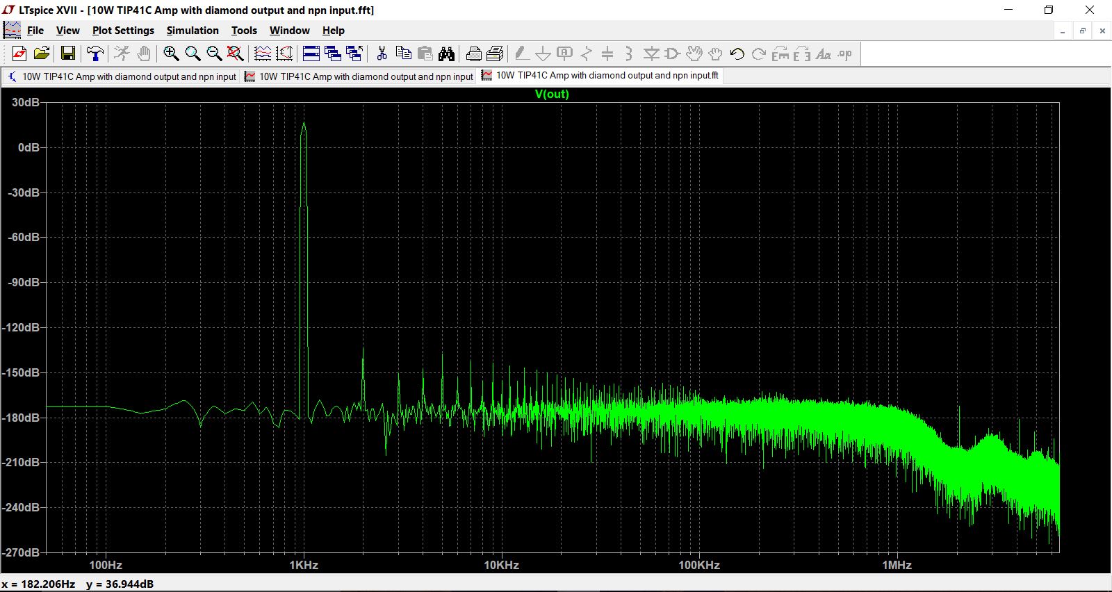

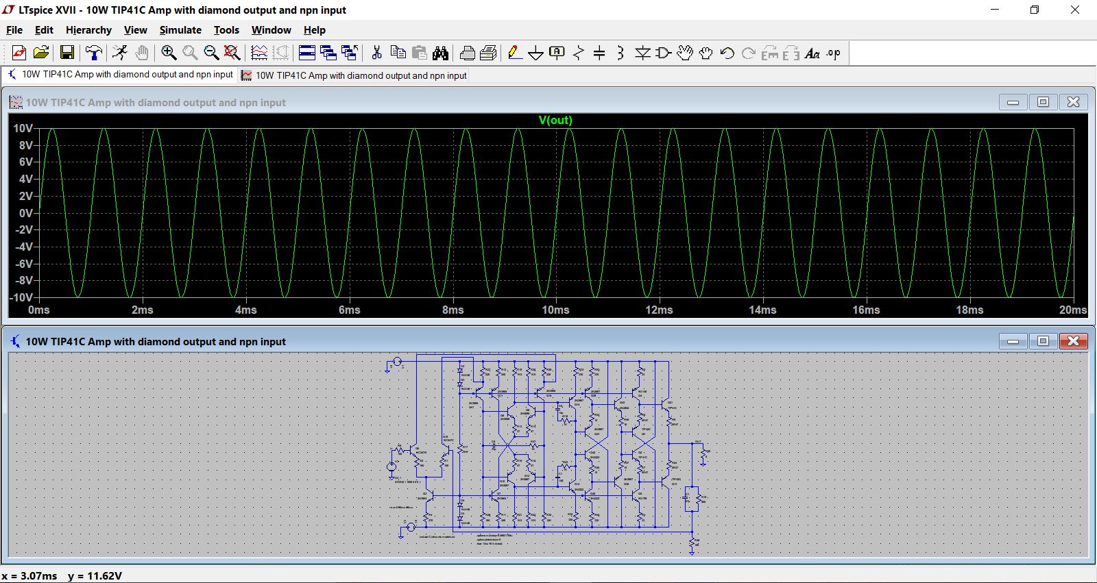

I've just been trying the TIP41 version and the distortion result is remarkable. A square wave test needs investigation though.
Interesting :)

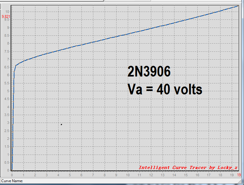

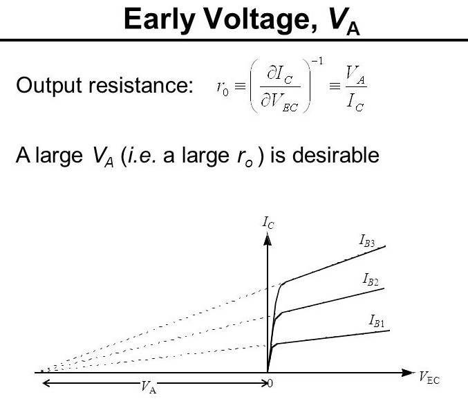

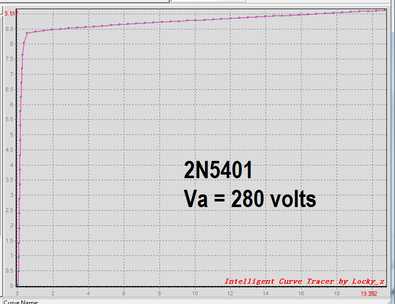

Suzyj, why are the push-pull transistors [Q14-Q15 in post #11] chosen to be 2N3904/6 ? Doesn't their rather terrible output resistance (low Va) roll off the low frequency gain unnecessarily? Perhaps 2N5551/2N5401 might be an improvement in those positions. Here are a couple measurements I made a year ago.
Thanks for any insight.
Thanks! It's wide open to HF, and loop gain is nowhere near unity at 180, so it rings like a bell given the right stimulus. Adding a HF blocking cap at the input and Zobel to the output shuts it up nicely, cleaning up the square wave response pretty well, with no effect on THD. See attached image and sim.
Interesting, good idea squeezing out top performance from widely available and affordable parts for anyone to replicate, what's the OLG for the circuit?
OLG is perhaps 105dB. Most of the linearity improvement comes from linearising the final stages with diamonds rather than just chucking piles of gain at the problem.

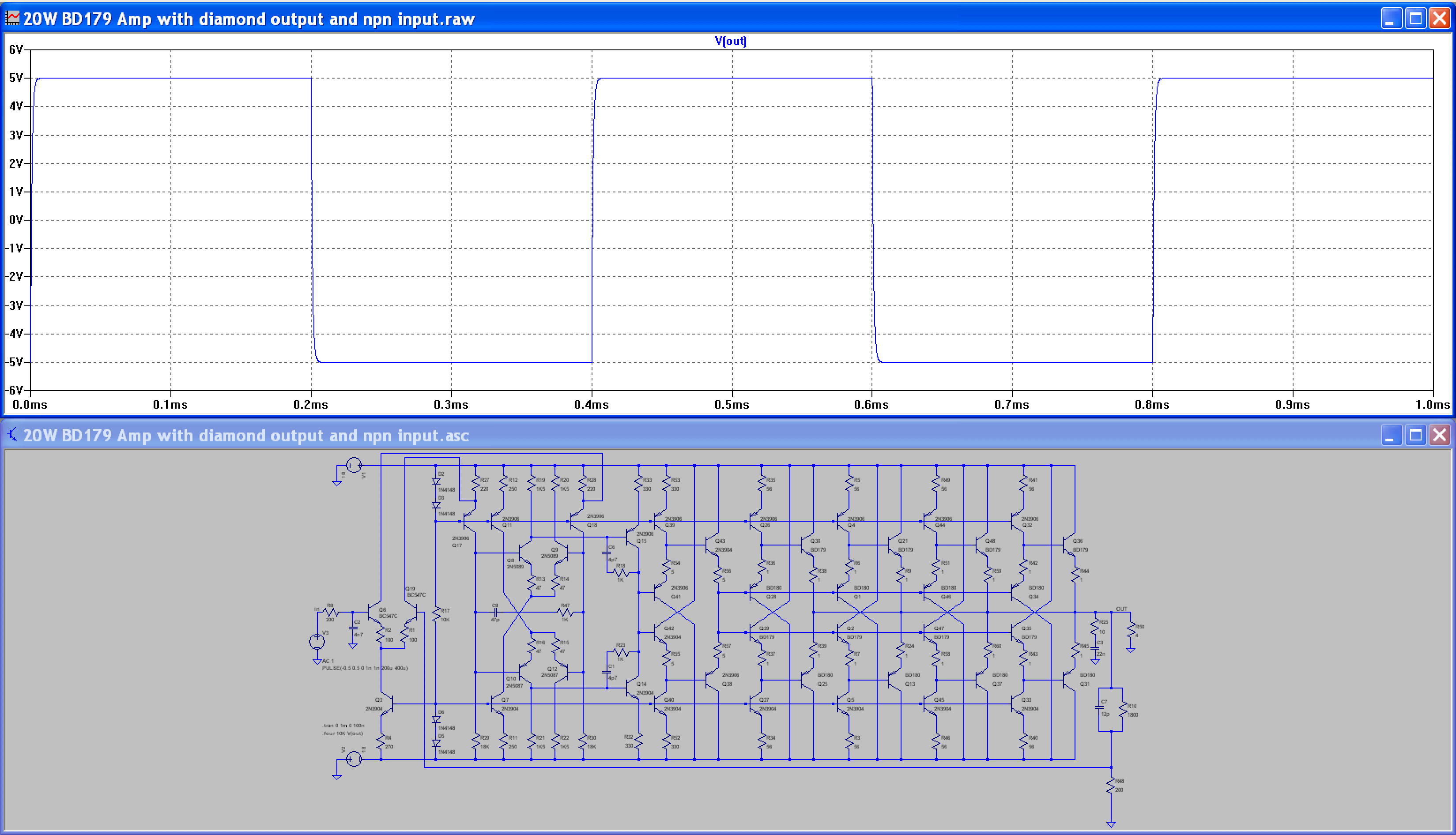

There's not terribly much in it - I think the slightly worse output resistance of the 3904/3906 is ameliorated by the slightly better Hfe at the reasonably low 3mA operating current, not to mention lower input capacitance. 5551/5401 would definitely be the transistors of choice if I wanted to push the supplies beyond +/-20V.
  • 20W BD179 Amp with diamond output and npn input.asc
The amp is ridiculous complex for such low output power capability.
And it will not work as shown - it is oscillating even in simulation.
Thankyou! I pride myself on the complexity of my amplifiers. No, it's not oscillating in simulation.

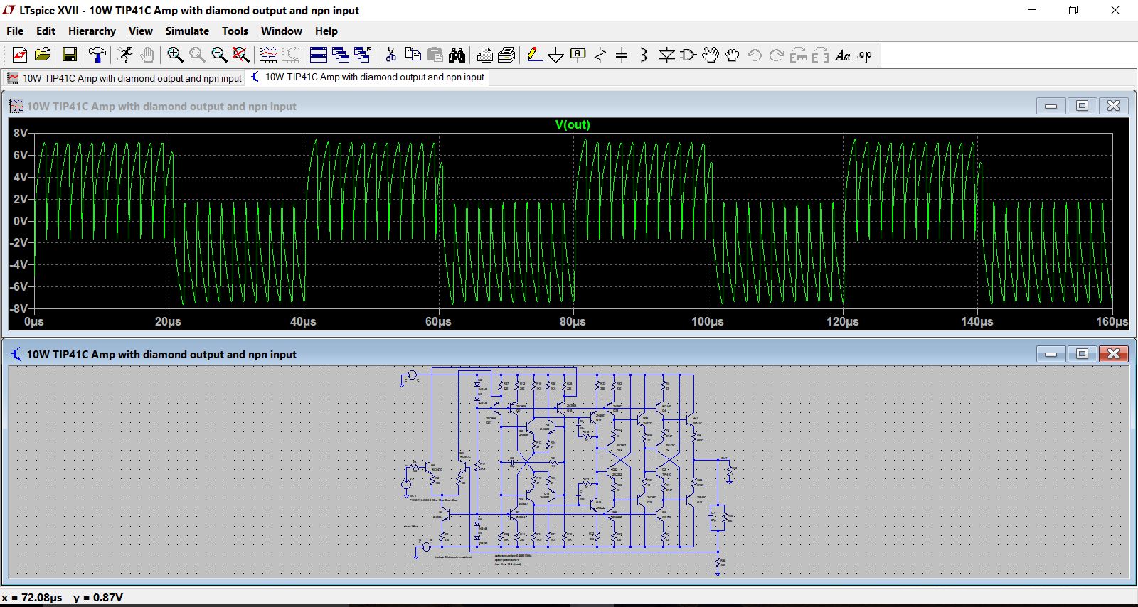

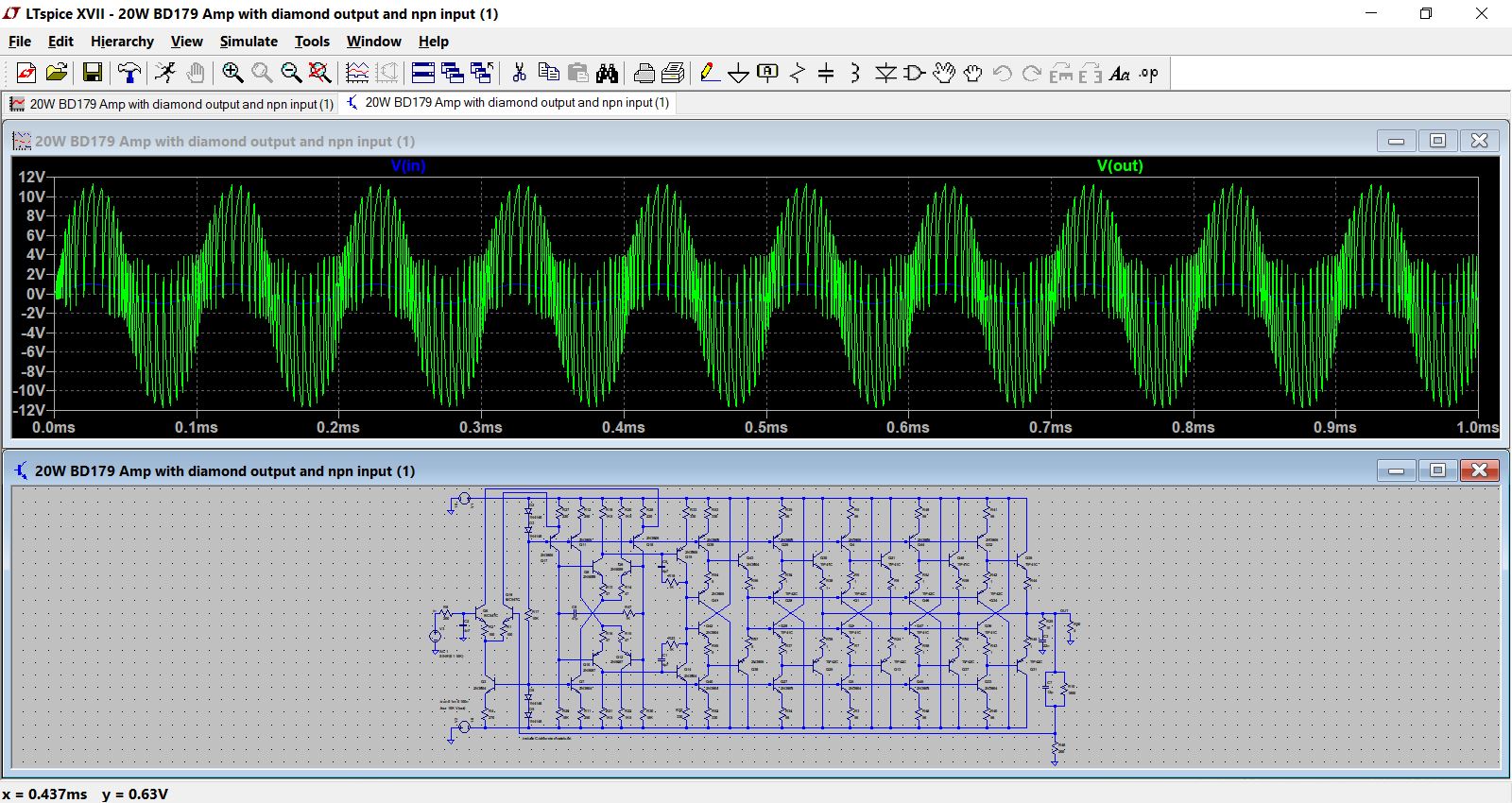

Thanks Suzy, that certainly looks better in your sim. It was your TIP41 version I was trying yesterday and I hadn't actually noticed there was no Zobel at the time. That one still seems unstable tbh, even with the filter and Zobel network added.
For your latest file I haven't got the BD179/180 models and so swapped in TIP41/42's.
It seems very critical on models used...... this is the .asc you just posted.
(sorry, it all sounds a bit negative... and I don't mean it to be :))
Hmm, at least in my simulation it is oscillating wildly. See attached picture.
This is no suprise as the open loop gain at 10 kHz is over 100 dB - far too high.
To stabilize this crap, you need at leat 10x the feedback caps.
And you are generous with the number of transistors, but stingy with the bias current.
Look up a transistor datasheet and you will see that a discrete transistor
needs about 5 - 20 mA for best HF performance to overcome the plenty
of capacitance in a discrete design.
I am using LTSpice IV, and had to download the BD180/BD170 models from Onsemi.
The input signal is the green one, 1 Volt sinus with a 100 mV square wave.
See post 25 above regarding HF rejection. An amplifier must be seriously over-compensated to avoid oscillation if you apply a square wave without any HF filtering.
I’d suggest you try the sim from post 25. If you’re still keen on showing it oscillating, I suggest the best approach would be inserting a square wave current directly into the base of one of the VAS transistors.
OLG at 10KHz is a healthy 76dB. Not 100dB. It’d be a neat trick if I could manage 100dB of OLG at 10KHz.
Maybe it would be more clear if we were to say the amplifier would be ringing, rather than oscillating, with a non-band-limited square-wave input excitation?
Yes, absolutely. Apologies for the sloppy language.

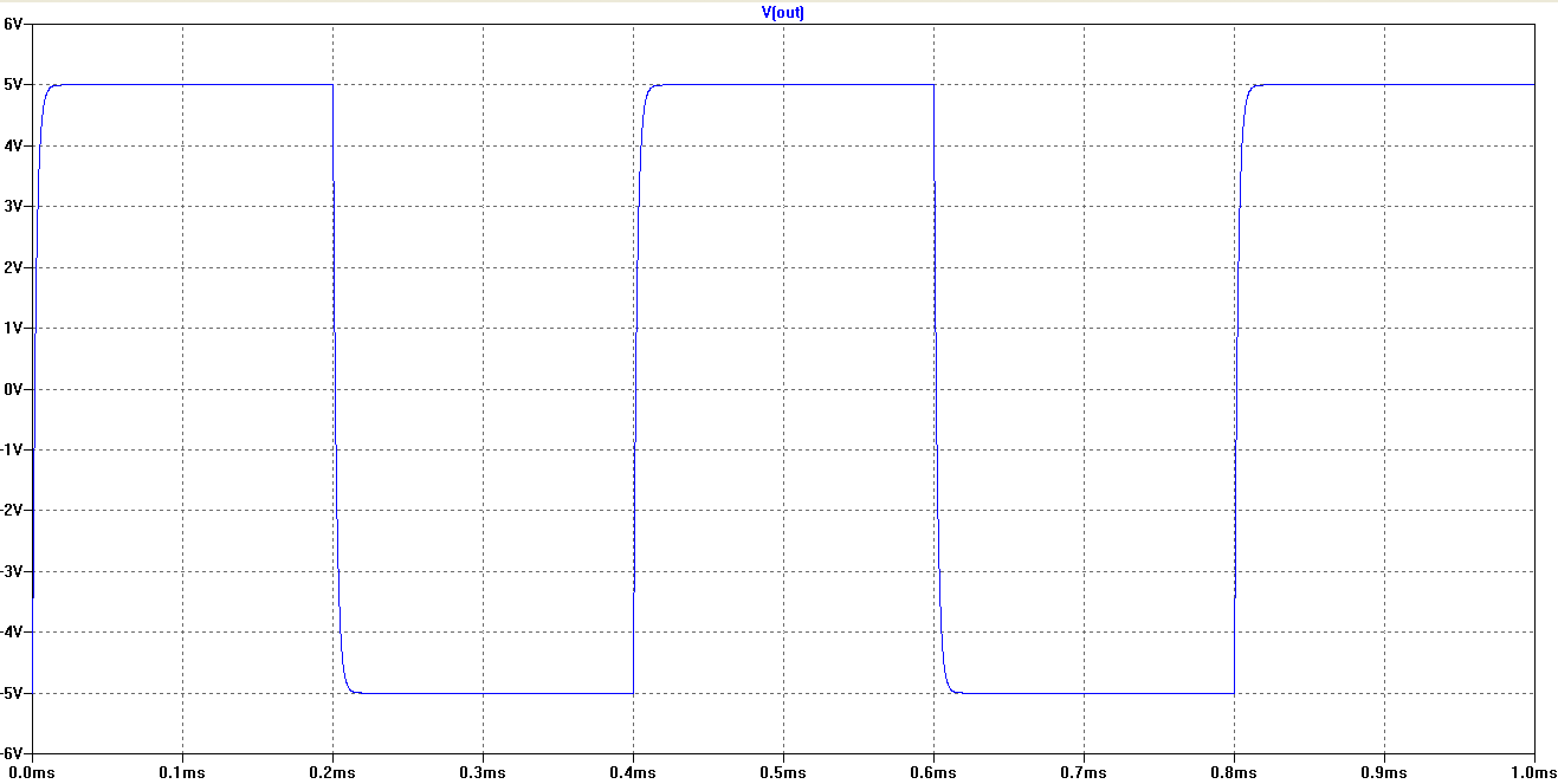

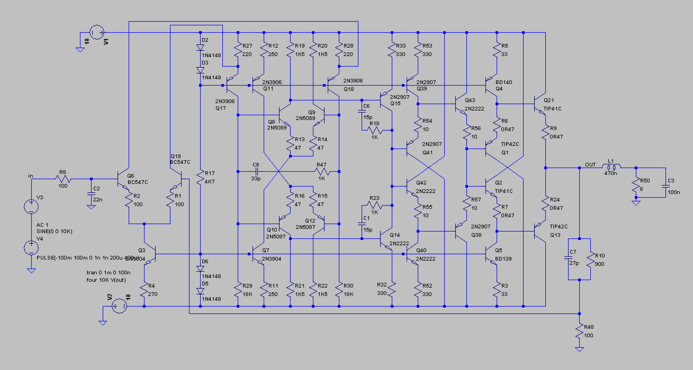

Mooly, I've attached a reworked TIP version, with HF rejection. The Zobel network wasn't useful, so I've thrown a 470n inductor (12 turns of 22AWG wire on a 6mm former) on instead. The cap across the output (C3) isn't intended as an actual component, but rather is a test of how it goes driving capacitive loads (due to it not liking the Zobel).
I much prefer the BD179/180 version - it's significantly less fussy to compensate.

There's not terribly much in [boosting Early voltage from 40v to 280v] ...
A mere factor of seven, which increases low frequency gain by only 16.9 dB
Perhaps extra LF gain is actively and vigorously spurned; perhaps one might actually prefer to decrease LF gain instead; this is easily accomplished by increasing the loading on the collectors of Q14-Q15.
I played with your later amplifier from post 25 and 34 and they all burst into
wild oscillation with HF excitation at the input shortly after simulation starts
- You definition of stability seems very strange to me.
This is a complex circuit with some nice ideas, but it will need more
work to make it useful.
Attached is your asc file where you could simulate it for yourself.
The BD140,BD139, TIP41 and TIP42 transistors are downloaded
from the Onsemi Website.
Of course with the removed silly 22nF input capacitor as you need
a fast risetime in Spice to excitate oscillation!
Don't forgett that in a real cirucit the thermal noise will excitate
your circuit from DC up to infrared and will trigger any instabilities...
  • 10W TIP41C Amp with diamond output and npn input-Post_34.asc
