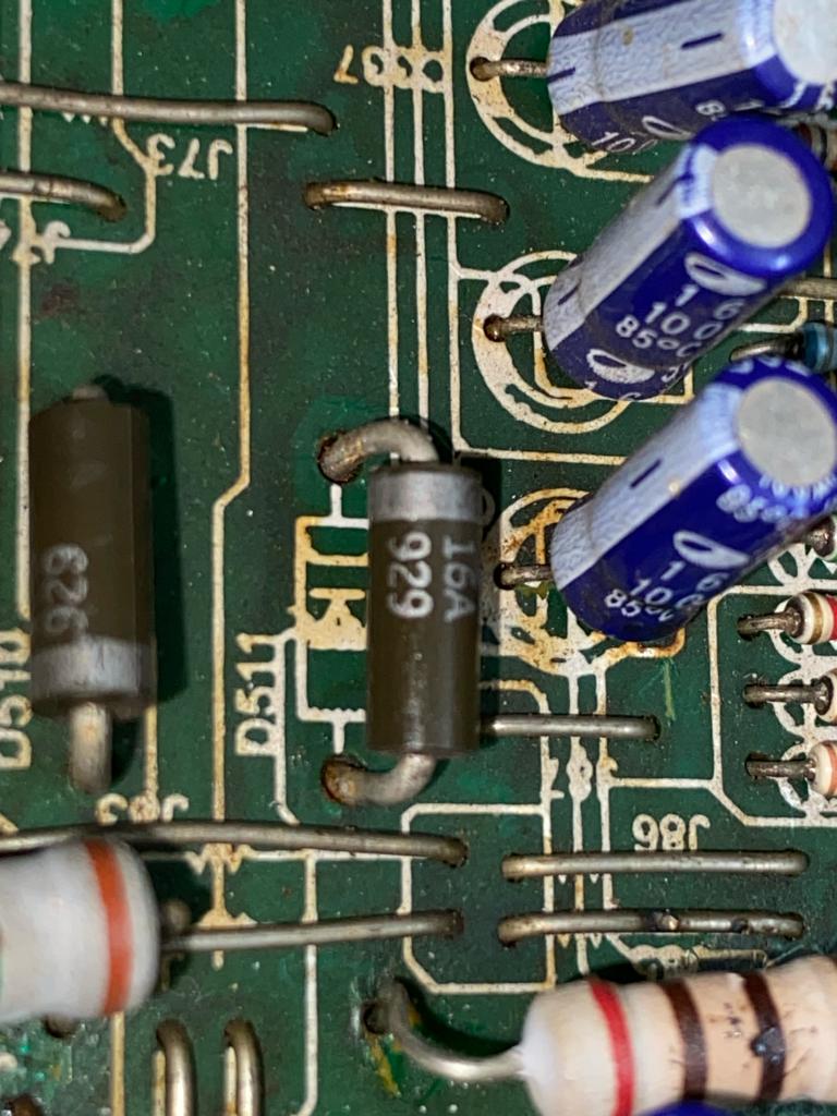

Are D510 and D511 shorted?

If you desolder those 2 resistors, what resistance do they read? They may be the wrong value. Add to that, shunt regulator resistors often run hot from high power dissipation. That's why they use large resistors.

150 ohm resistance. And i also check with color code and same outcome was comingIf you desolder those 2 resistors, what resistance do they read?

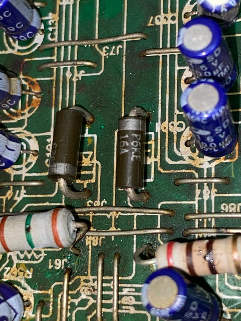

1. What's the resistance reading across each of those diodes? Measure one way then reverse the probes and measure again.
2. What are the part numbers on those diodes?

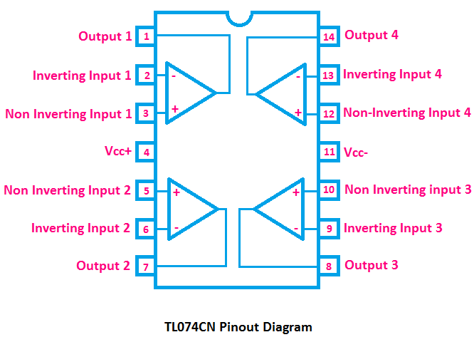

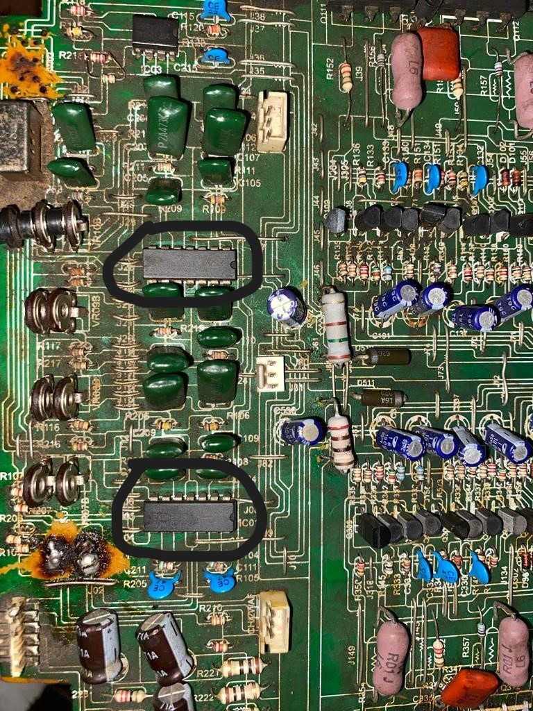

3. What's the DC voltage across the PS pins (4 and 11) of the op-amps?
4. What's the DC voltage on 3 legs of any of the output transistors?
5. Is there a preamp board missing?
6. What's the damage at the lower-right of the top image?

620 Ohms in D510 and 586 Ohms in D511. And when i reverse the terminals then diodes values is 0.1. What's the resistance reading across each of those diodes?
P6KE 16A 929.
if you are talking about those IC's. See in attach pics.3. What's the DC voltage across the PS pins (4 and 11) of the op-amps?
Then its DC voltage is 2.95 V in both of them.
Please explain me which transistor are you talking about. If you are talking about Channels ICs legs then its DC voltage is 18 V.4. What's the DC voltage on 3 legs of any of the output transistors?
while measuring the voltage on 1st & 3rd leg of big transistor connected to the large pin resistors there is no any voltage but when i touch the 2nd leg with pink resistor there is 18V postive in half and negative in half.The voltage can be from any of the large transistors with their 3rd leg connected to the large pink resistors.
There should be positive voltage on half of them and negative voltage on the other half.
Yes i have the preamp board also.5. Is there a preamp board missing?
there was a volume switch but its damage so i made the jumper and then it was worked great.6. What's the damage at the lower-right of the top image?
but i think that they are too small to handle this.15v Zener diodes. 1W preferred.
