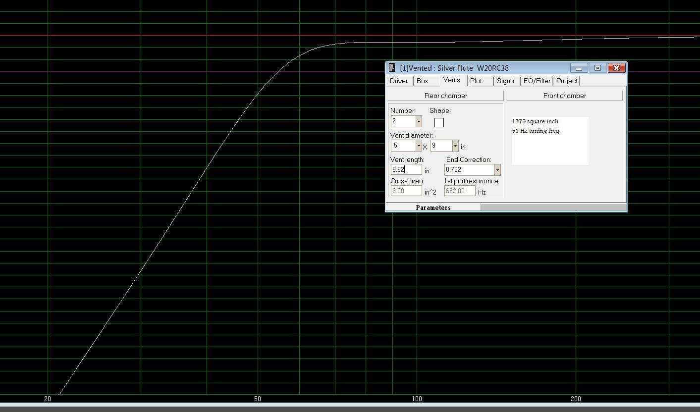

The 8" SF are here and looked at some sims. I don't see going larger than 22L - 23L.
http://www.madisoundspeakerstore.com/approx-8-woofers/silver-flute-w20rc38-08-8-wool-cone/
I'd like to stick with the Penguin style box, using 5/8" thick ply for the dual vents.

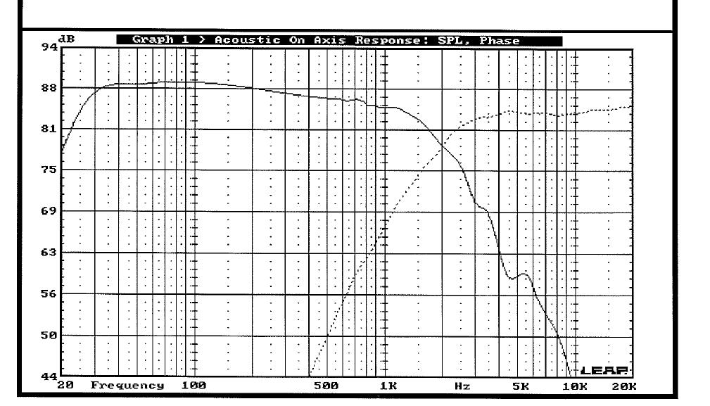

Looks like you just put a gentle notch at 4kHz and the slope is ideal for a simple crossover around 2.5 to 3kHz.
There's something you must know about the 8" woofer, 1" tweeter combination though. On a flat baffle you can get it phase aligned at crossover, but no better. With a bit of time alignment, you can get the phase alignment pretty much as good as you like across the 1kHz to 10kHz range. Being able to recess the tweeter between 3-6cms (more bafflestep needs more recessing) is just ideal, and your Penguin design seems able to accommodate this.

Thanks Steve, again very happy with the manufacturing of SF woofer (I'm sure the price will jump eventually). They look like "shallow" throw drivers (8" xmax is 5mm), which is suited nicely for the front port idea.

Power to the Penguins! I have a flat pack of scrap wood at the ready, to build test box: 1,375cubic inch, tuned at 50hz. They are easy to build; will take some photos to show the 3 places that need need a fine fit, other than that, router trimming, etc.

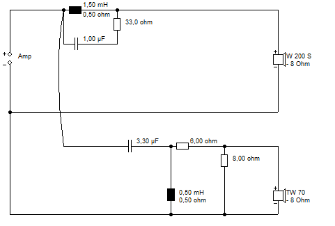

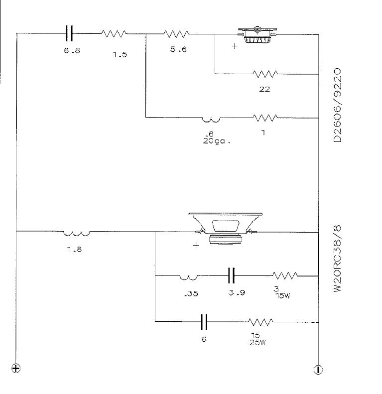

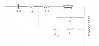

As mentioned in PM, here's the circuit that fixes the phase problems on the 8 ohm Silver Flute vented Woofer on a flat baffle. The 4kHz tank mainly fixes Phase. Sadly it doesn't work with the 4 ohm version.
It needs a special and EFFICIENT +90dB tweeter to make it work, and I had luck with a TW70 and KE25SC by Visaton. Maybe your Morels. Really don't know. You need a tweeter that dips into a saddle below 4.5kHz. This is a surprisingly high 3.5kHz crossover. Long live the Penguin.
Thanks for the help with the xo, not my forte

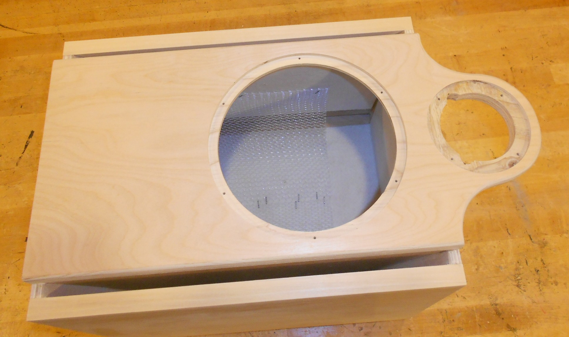

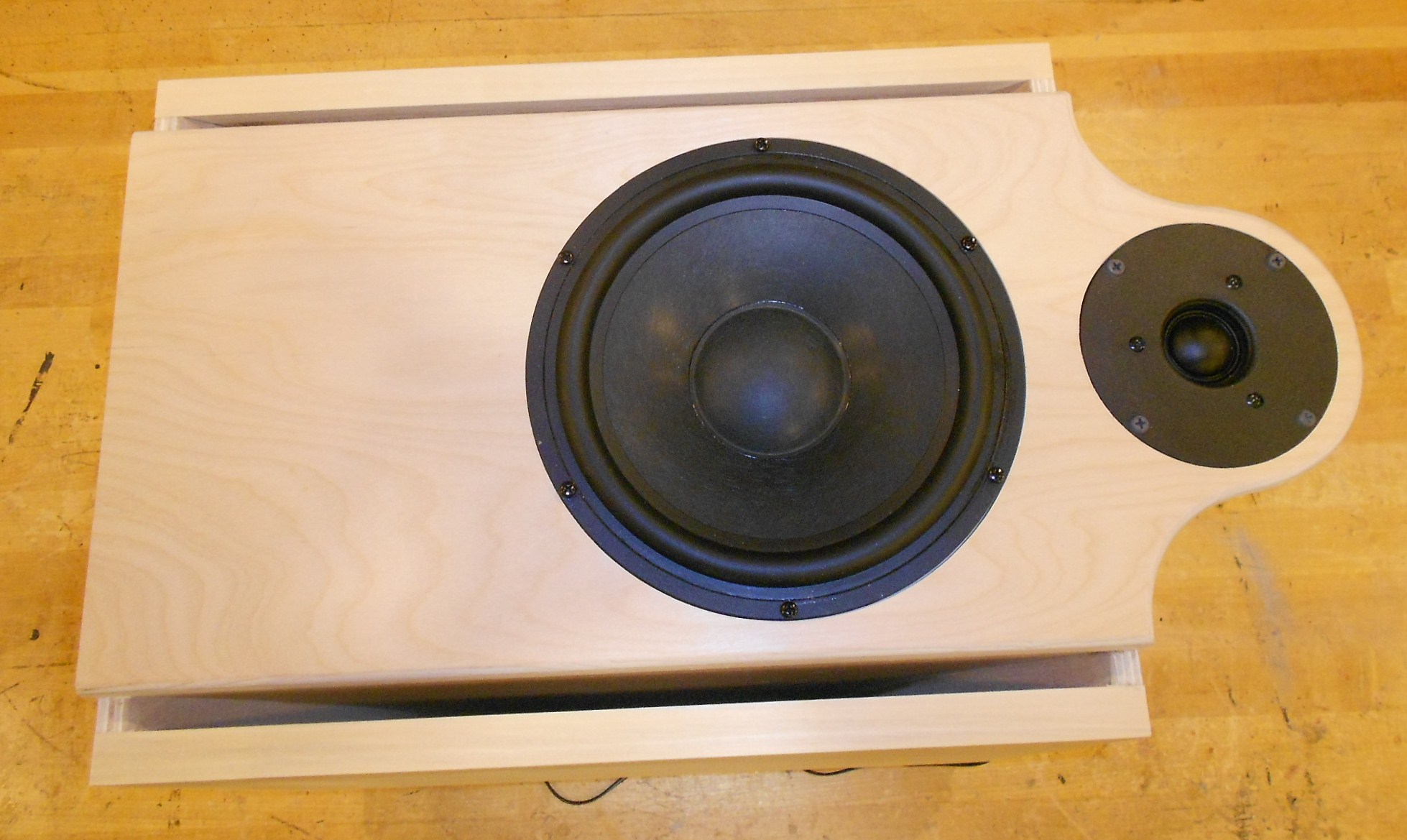

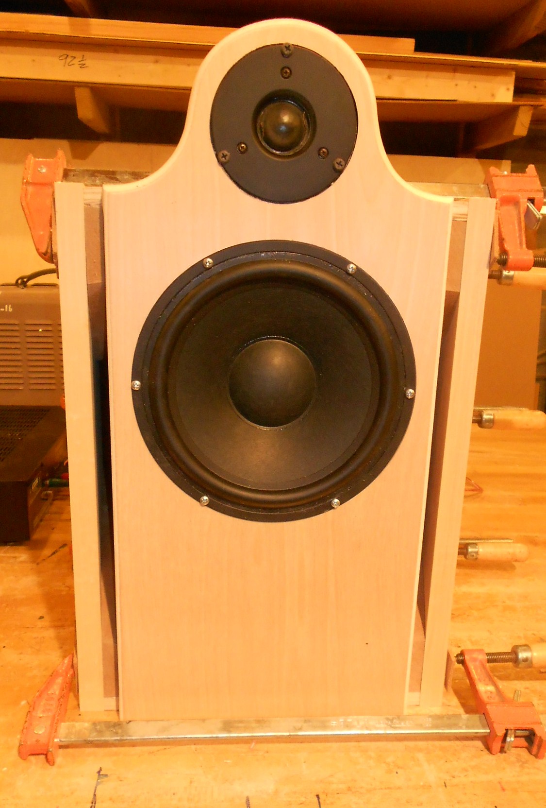

As you see a Morel ~ but placed it high the "tab" can be cut flush with top of cab.
Test box tuned at 40hz, but lots of materiel to trim/cut down (vent strips x 4).

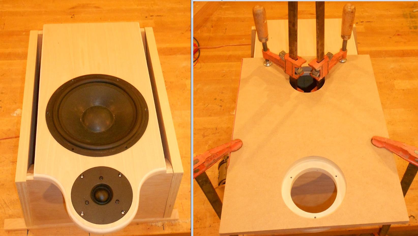

New Pic - Looks the same as the 6.5 woofer, but this is the new 8" in a 1400 cubic inch box.
Thinking now I got this right; can start to hear some chuff chuff around 40hz, but the cone movement is really exaggerated and its fairly faint. The woofer is surprisingly "smooth"; without any damping material.

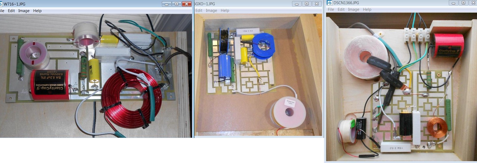

Still looking for xo and tweeter selection (tweeter shown is for photo only)

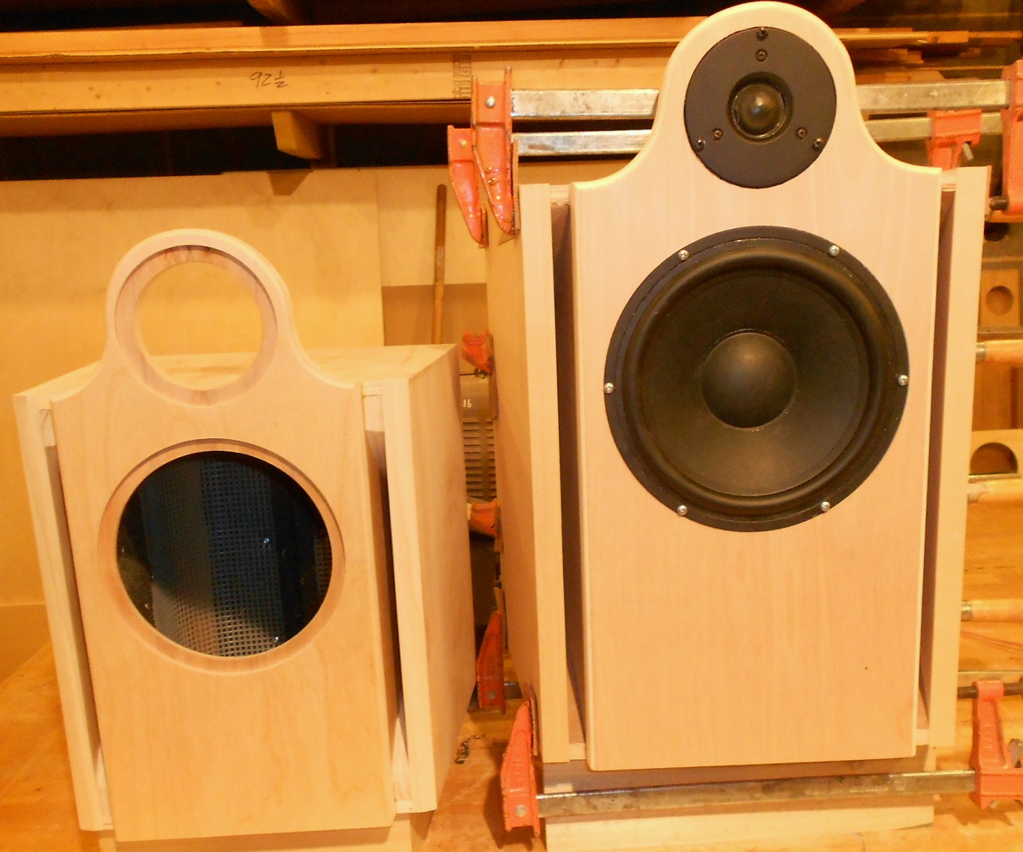

New tweeter pic - going to try a ScanSpeak D2606/92200. The Madisound Speaker Store
Which I just realized looks like a Vifa D27TG that I bought years ago, and never found a home for them, I hope they improved them
On a side note, I'm finding its a whole lot safer to set speakers drivers in, from outside-in with scrap wood, vs. cutting a hole and using a typical 3/8" - 1/2" rabbit bit.

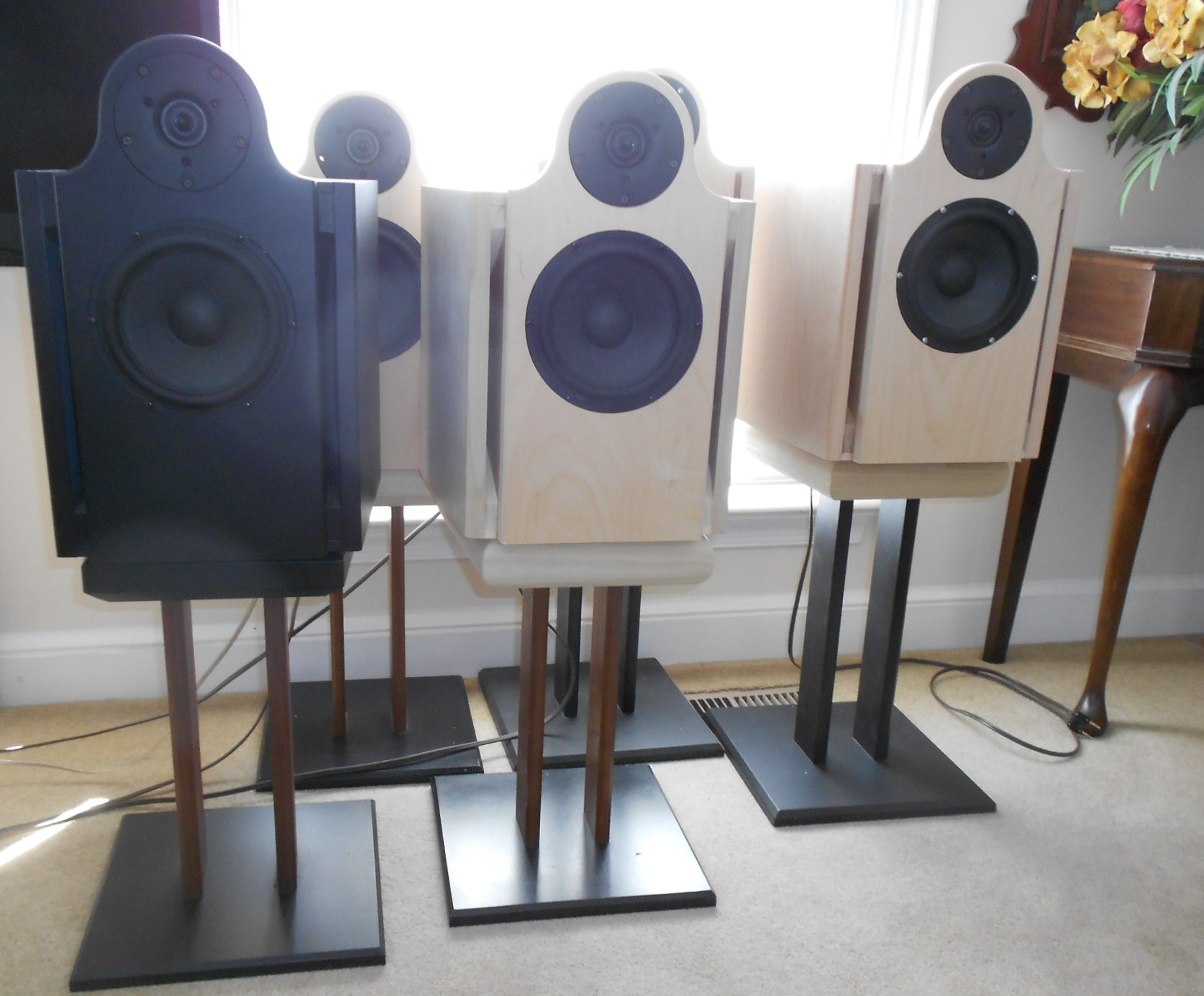

Results? Well good I thought the bass would rattle floors; not really.
I was more impressed with the 6.5" SF. Although, not bad for a 1st try.
Again good imaging - I think the high tweeter mounting is the way to go.
I like the new Discovery 1 Tweeter w/chamber, handles more power and goes lower.
The 6.5" and the Discovery tweeter might be a good combination. I would have to flip them and come up with a xo.
