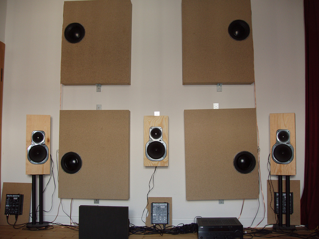

Here is a description - I know I saw a nice photo somewhere - of the variations including the 4 driver on the front wall arrangement.
from this post: Double Bass Array (DBA) - The modern bass concept! - Page 4
Somewhere is the image of the quad of speakers on the front wall... too many pages...
comparison of the various methods showing non-flat SBA, I think this was the post.
Double Bass Array (DBA) - The modern bass concept! - Page 3
As we all know, the simplest DBA is one speaker each in the center of the front and back walls.
The walls create acoustic images of these drivers every room-width to each side;
the ceiling and floor image the drivers every room-height above and below; and
this repeats, including all the diagonals, even out to infinity, for perfectly reflective walls, floors and ceilings.
A two-speaker DBA array centered vertically doubles the horizontal density of this simplest DBA,
but leaves the vertical density the same.
The two-speaker DBA array also shifts the driver horizontally by 1/4 of the room width, but the vertical offset is unchanged.
Nils's beautiful quad DBA then doubles the vertical density, too, also shifting the vertical placement by 1/4 room-height...

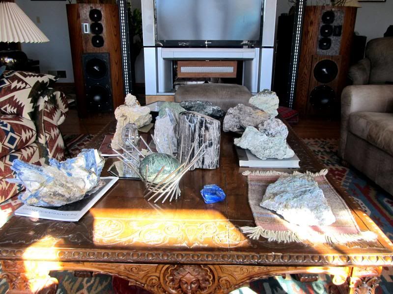

But then, I have 8 drivers per primary (A & B), 8 drivers in surround, 4x12" subs spatially distributed, and one center channel, all driven through MultiEQ; total of 6x10" woofers, 8x4" midrange, 6 tweeters, and 2 BG RD 75" operating from ~500 Hz up. They all mesh seamlessly, and produce a quite convincing soundfield
You can see the A - B speakers + center in this photo:
John L.
Seems straightforward enough; I believe my current setup does just that, based on extended listening and some measurements.
John L.
