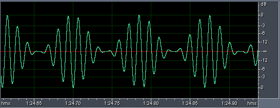

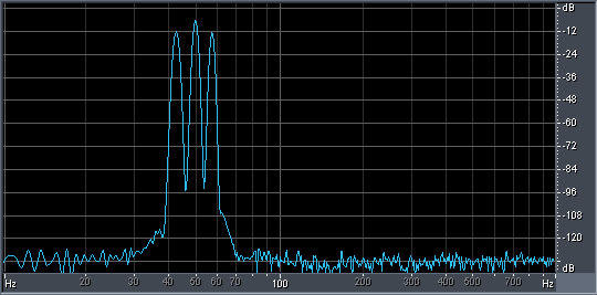

Burst waveform is excellent test signal for testing:
I have generated a continuous track of bursts with center frequency sweeping from 10Hz to 200Hz through 4 minute interval and uploaded a copy as 44.1kHz 16bit mono wave file:
https://dl.dropboxusercontent.com/s/advf4c75c4keqof/swept%20bursts%2010Hz-200Hz%204min.wav?dl=1&token_hash=AAFfz_TjpnizazdzfkfNXMOcXhYO38vIv8Z8v5zHoARyaw
As long sweep the spectrum at any point is easily resolved as a peak center frequency with side bands at 0.85f and 1.15 f:
Response recording of waveform is revealing of room interaction and distortion.
Waveform readily exercises driver excursion, and caution is advised in controlling volume at start of wave with initial use until familiar with system capability.
Slow sweep effectively energizes single room mode over any short interval of time.
In my room driving sub system with two subs each with 450 watts of available power, portions of track sound like diesel locomotive throttling up under load.

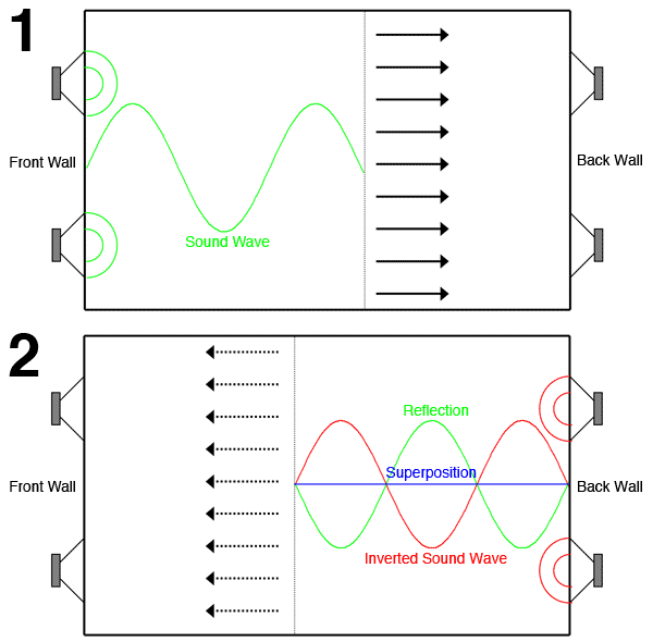

DBA and near field sub are two different approaches to get bass that is flat and free of modes into an acoustically small room. Something you considered "a funny idea".
Regarding how a DBA works this diagram might be helpful:
The front array creates a plane wave that travels through the room. The same plane wave is emitted at the back of the room exactly when the front wave arrives at the back array. This affectively cancels the front wave. This is active absorption.

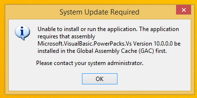

I've searched around but didn't find a download for v10 of those "Visual Basic Power Packs". I found v3 which is from 2008 (!), downloaded and installed it but no luck.
I think your app needs to provide it: Deploying Applications That Reference Visual Basic Power Packs
Edit: Found an installer for v10: http://go.microsoft.com/fwlink/?LinkID=145727&clcid=0x804

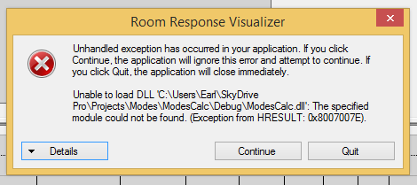

Nw I get this error message:

The last error is the one that I just fixed, at least on my end. I'll look into the VB power pack error as this should not be required. It may have snuck into the references.
