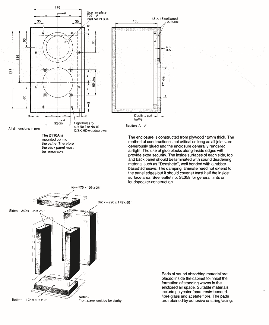

the mini-line from its original publication but had trouble getting a reprint.
Quality limited by the scans i was given, but dimensions are readable....
http://www.t-linespeakers.org/download/WW-miniLine.pdf

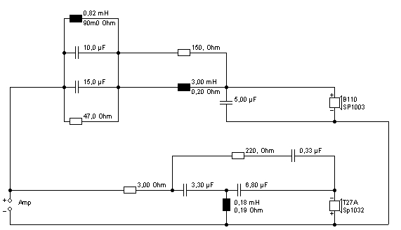

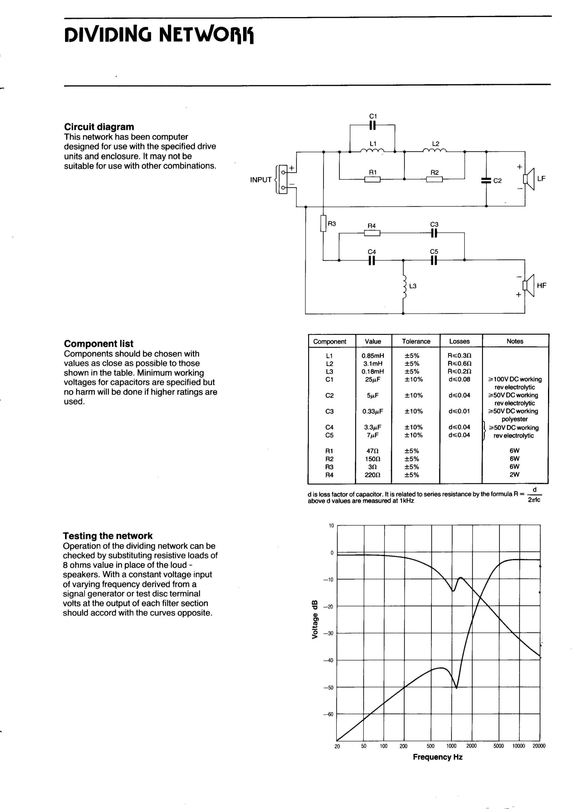

Someone pointed me in the direction of the CS1A crossover earlier today and I am aware that Falcon Acoustics list the CS1 crossover but it seems to be for use with the B110 SP1057, should this work correctly my B110 SP1003?
Two years ago I have build my own CS1a, with B100A/T27 which I bought in 1982. See attachments for Crossover, Cabinetdetails and finished CS1a.
And don't give up. I am sattisfied with my CS1a and for some times I use a sub to improof bass.

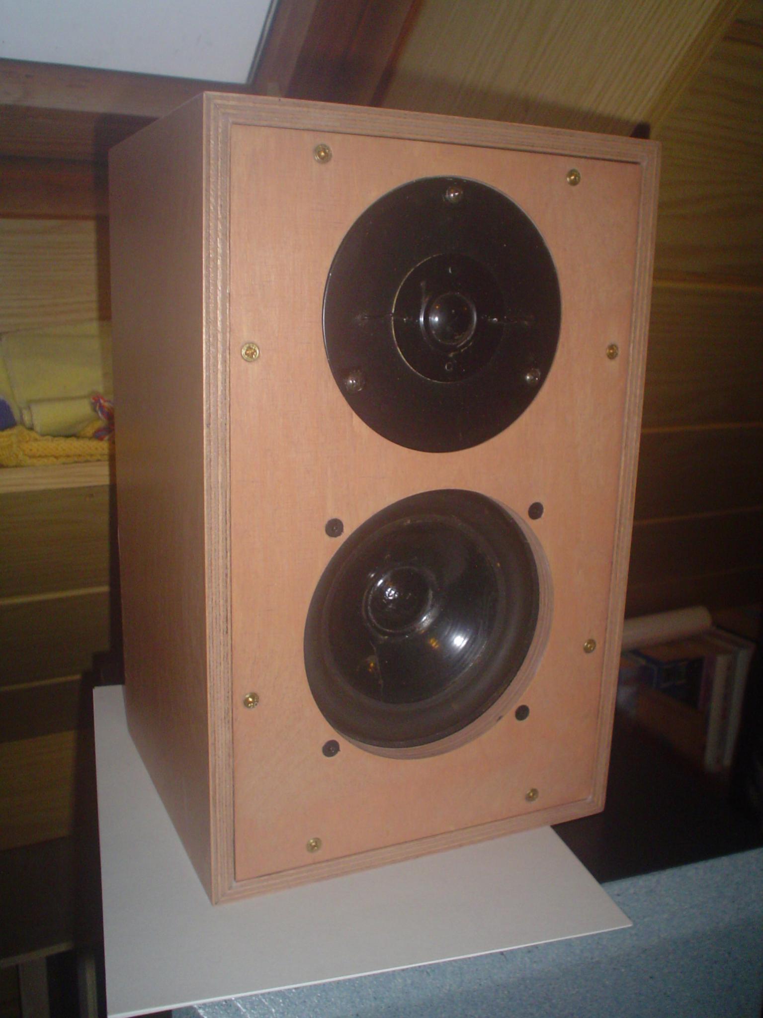

To add my two pennyworth to this, I have completed a long project building a pair of LS3/5as.
I know Jerry Bloomfied of Falcon. I knew about the new B110 and T27 before they were released on the market.
I wanted to build my LS3/5as as closely as possible to spec. so I sought advice from Jerry. Firstly the B110s I selected were early ones with the lead in wires showing through the cone, as utilised in early BBC versions of the 3/5 and 3/5a.
I tracked down a pair, and a speaker designer friend of mine measured the responses. A pair of NOS T27s were purchased.
Some may ask why I didn't go straight to Falcon Acoustics' new drivers. Basically I wanted to try and 'copy' early designs of the'3/5a.
The cabinets were ex. Harbeth LS35a ones, which required restoration. The front baffles, felt strips and other sundries came from Falcon or Stirling Broadcast.
Re. the crossover, I selected Falcon's new FL6/26 and Jerry built them up to the original spec.
Then the 'fun' began. The speakers were assembled and evaluated. Not just by me with recorded music, but live voices and monitoring recordings.
