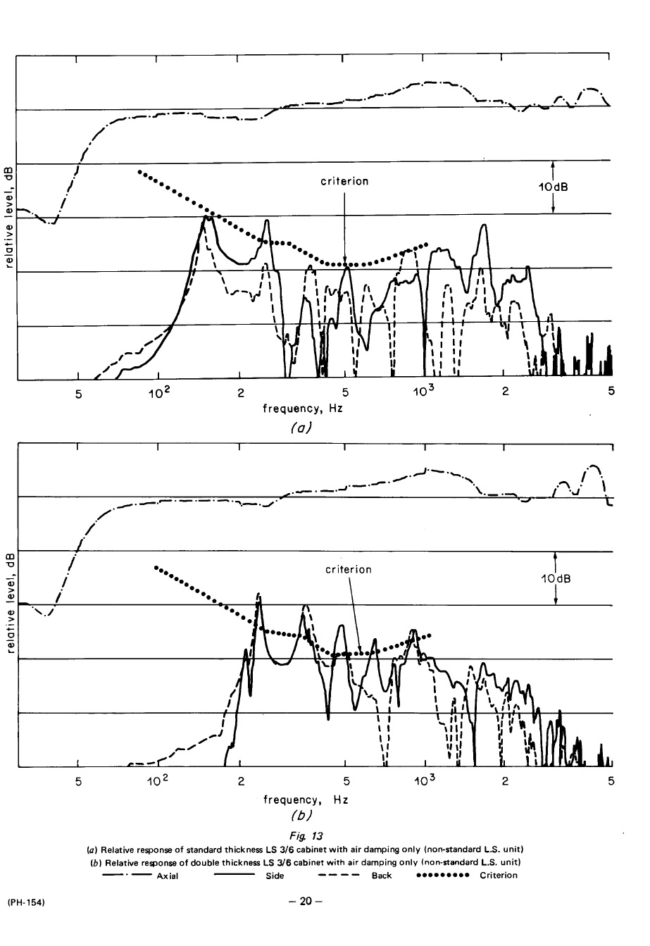

I cite Harwood a lot because he wrote a very practical paper that is exactly on point. Below is a pair of graphs where he made a standard undamped cabinet and measured the wall output. He then doubled the wall thickness and made the same measurements. As you would expect the cabinet resonances went up in frequency. They are very nearly the same SPL at their higher frequencies. As he had earlier determined that our threshold of audibility was falling through this range (we could detect resonances at lower level: we were more sensitive to resonances) then this made those particular resonances more audible.
Oops.
Barlow did a similar study but he put a loudspeaker and cabinet within another cabinet. That is, he buried a speaker so that it should have been totally silenced except for any sound that could seep through the outer cabinet.
He found that there was one major frequency where the sound was nearly as loud as if there were no outer cabinet. When he used thicker and thicker cabinets the frequency of resonance went up but it did not change in level.
These two sets of graphs are what I base the claim on, that cabinet output is constant even though stiffer walls have pushed resonances up.

- ultra stiff walls (but somewhat damped) for the subwoofer.
- "floppy but massive and highly damped" walls for upper bass and midrange
Such a midrange cabinet could be made large enough, so that compliance of the air enclosed is very high compared to the drivers compliance.
A large mass located at the driver's motor would "mass hamper" excitation of the baffle via the driver's basket.
