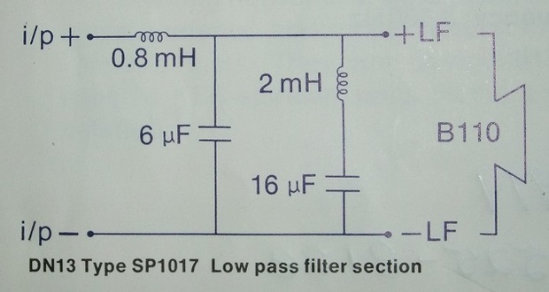

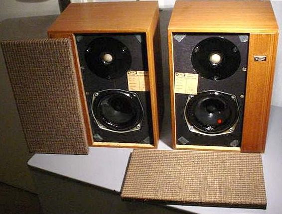

The first ones like the pictured Cresta used just a bass coil and a second order tweeter. 4uF IIRC. Don't know the coil values.

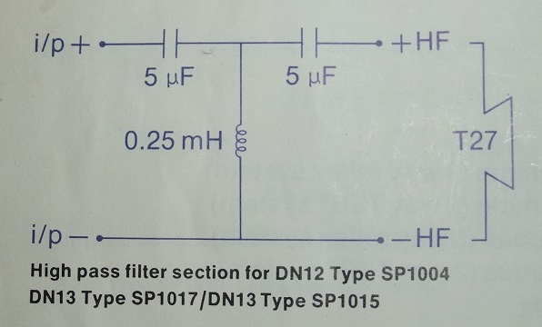

Here's the DN13 SP1017 schematic which should work with your drivers. The 2mH coil has a built in 6.4R resistance to make the notch work.

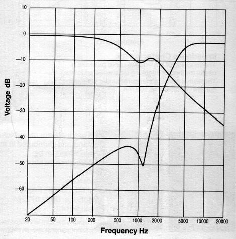

The later CS1 electrical response shows what KEF got up to, here with an acoustic butterworth notch on the tweeter. Complicated stuff!

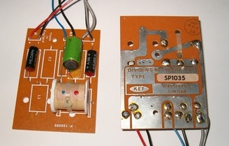

Thanks for that input System7 and Colin. As it happens, I have managed to find photos of the Coda SP1035 crossover and it seems pretty basic.
I have also seen the details of the Kef recommended crossovers for the B110 & T27 as linked above by System7 and they seem significantly more complex which is odd since all of this comes from Kef.
I am pretty confident that my B110s are the SP1003 versions so the CS1 crossover is probably not suitable. The crossover for the CS1A is the SP2015 and I will try to find details for that.
In the case of the Kef recommended crossover designs for the B110 & T27, I have priced up the capacitors (2 x 5.0 uF, 6.0 uF & 16.0 uF capacitors) and inductors (0.25 mH, 0.8 mH & 2.0 mH) and they work out more expensive than I would have anticipated. Is the design of a passive 2-way crossover a function not only of the drivers involved but also of the cabinet in which the drivers are placed? Specifically, if I were to use the Atkinson Mini Transmission Line cabinet design, would the LS3/5a crossover design work satisfactorily?
