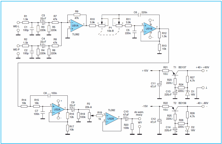

As to the question - i was wondering and i found this thread. I just registered, this is an old post - for someone in future I'll say this. I build a pre-amp design just for ne5532 and I just felt like using TL082 and I used sockets. I put TL082 and was very happy with result. I can switch it back to ne5532. I think the noise is very low with both. Both are high speed.
It was this design - i used a prototype pcb and point to point wiring ... its crazy looking but it works
Hi-Fi Preamplifier
Its quite forgiving and since it is a standard it seems that provided voltage on datasheet is within tolerance you can swap them. I expect most of them run best at +/-15v. One other comment ... i tend to put a 50 to 100 ohm resistor between the supply rail and the power input after building a few unstable pre-amp designs and finding this works better than directly connecting. Some kind of supply cap to stabilize near every chip is recommended - between 10uF and 47uF at each power input. Depends how serious you want the result to be.

The decoupling requirements differ between TL082 and NE5532/4 - the latter need good high speed decoupling close to the chip or will exhibit reduced performance (distortion increases measurably - believed due to internal oscillation) - the TL082 is much more forgiving for decoupling.
In circuits with potentiometers you can get away with passing the input bias current for a FET opamp through the wiper of the pot, but not for a bipolar opamp (horrible cracking will be the result).

Thing is that dual op-amp chips are designed to be relatively pin compatible, voltage supply compatible? Right? ... what happens if you don't do it right? All I know is my jfet based pre-amp works fine.
Some of the circuits give a series of op-amps that work. I've seen people replacing op amp chips in guitar pedals with ALL the pin compatible op amps and they all seemed to work.
What I have found, i don't know if its reasonable, is that I put some current limiting resistors and caps at the power inputs for the op-amp chips. Since i did that stability and other sound issues seemed to vanish completely even though the circuits "seem to" call for just direct connection to voltage rails.
I have 6 decoupling caps on my preamp - one for each + and - rail at each chip. 10uF and then 47 ohm resistors. It worked in a few designs after I saw people putting 100 ohm resistors (which I sometimes use) at the power rails. So whatever oscillations or stability issues were related to this I'm not sure but when I didn't do it on my first pre-amp that became unstable.
