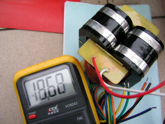

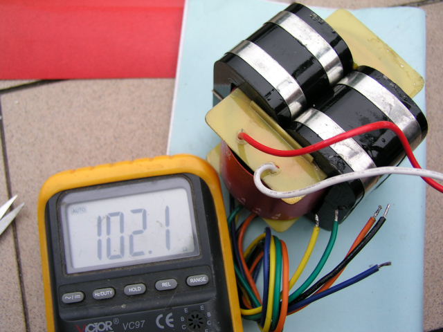

this is the OPT of the kit,
circuit was same as the 417A/6c45 to 300B but EC52 had larger plate resistance than 417a, so I cannot ise IT, if USE IT I must use feedback. so I back to use 0.22 uf couple to 300B.
OPT was double c-core 19H 102ohm.
band width from 23Hz~45Khz -2db
